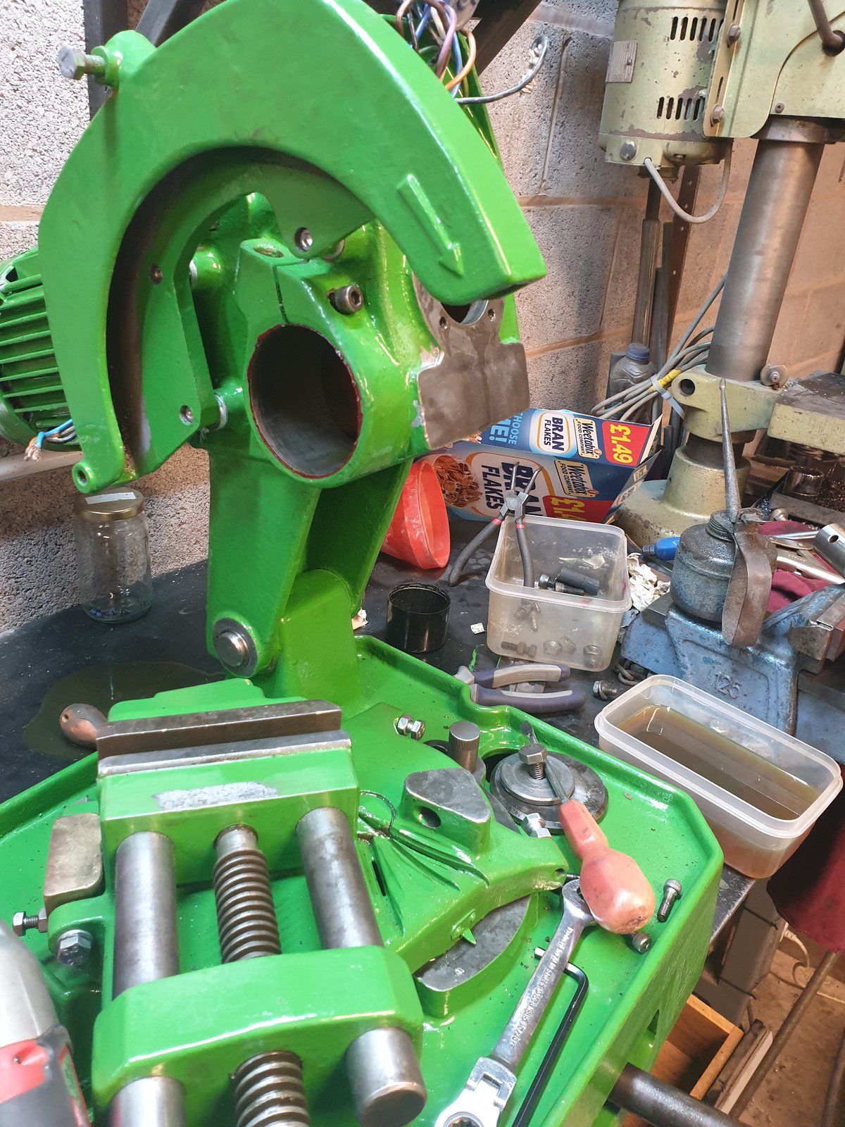

I'm in the middle of cleaning up a cold cut saw and thought I'd clean out the inside and give it a freshen up with new oil and new gaskets and o rings.
However I have put it all back together

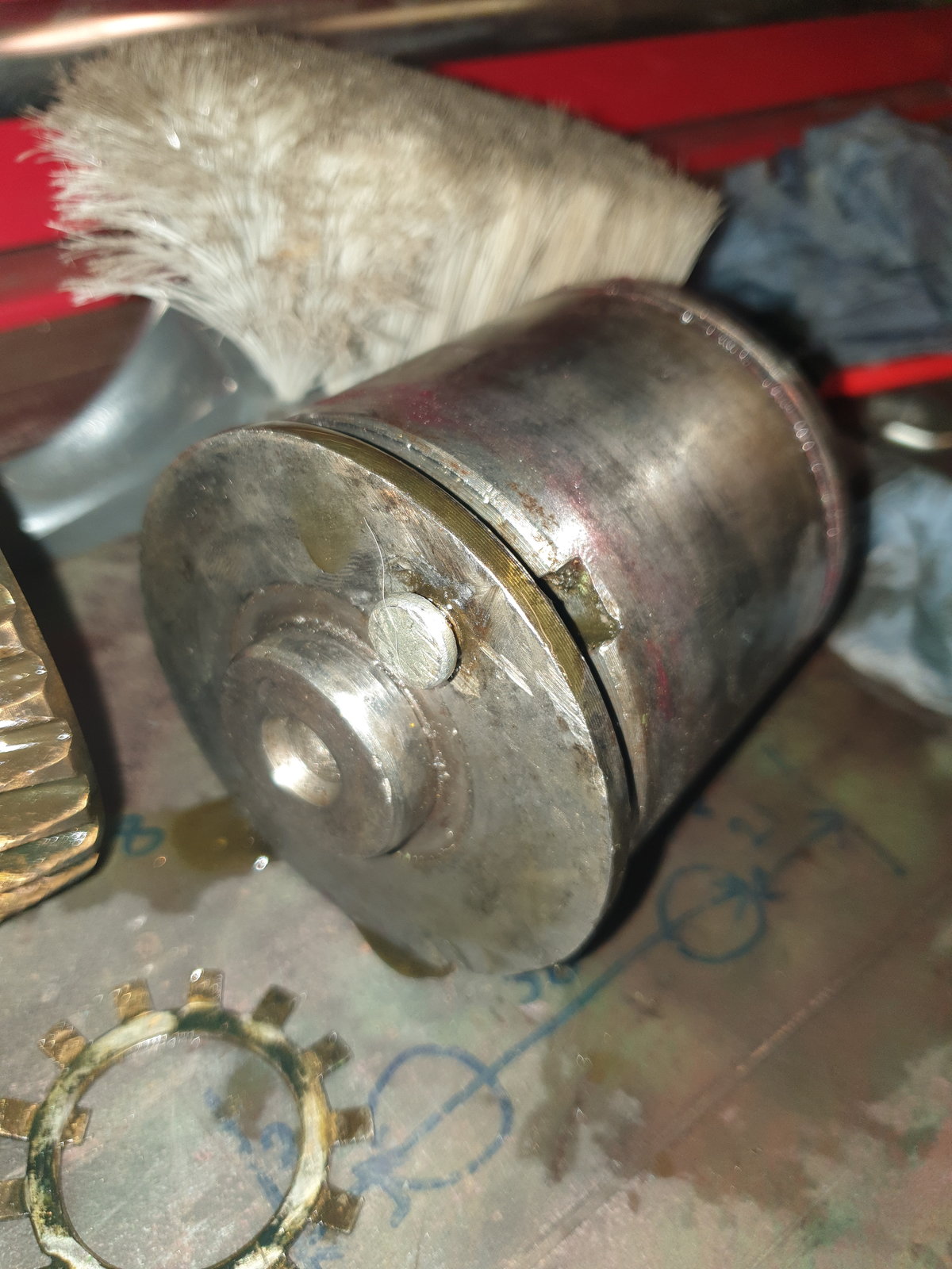

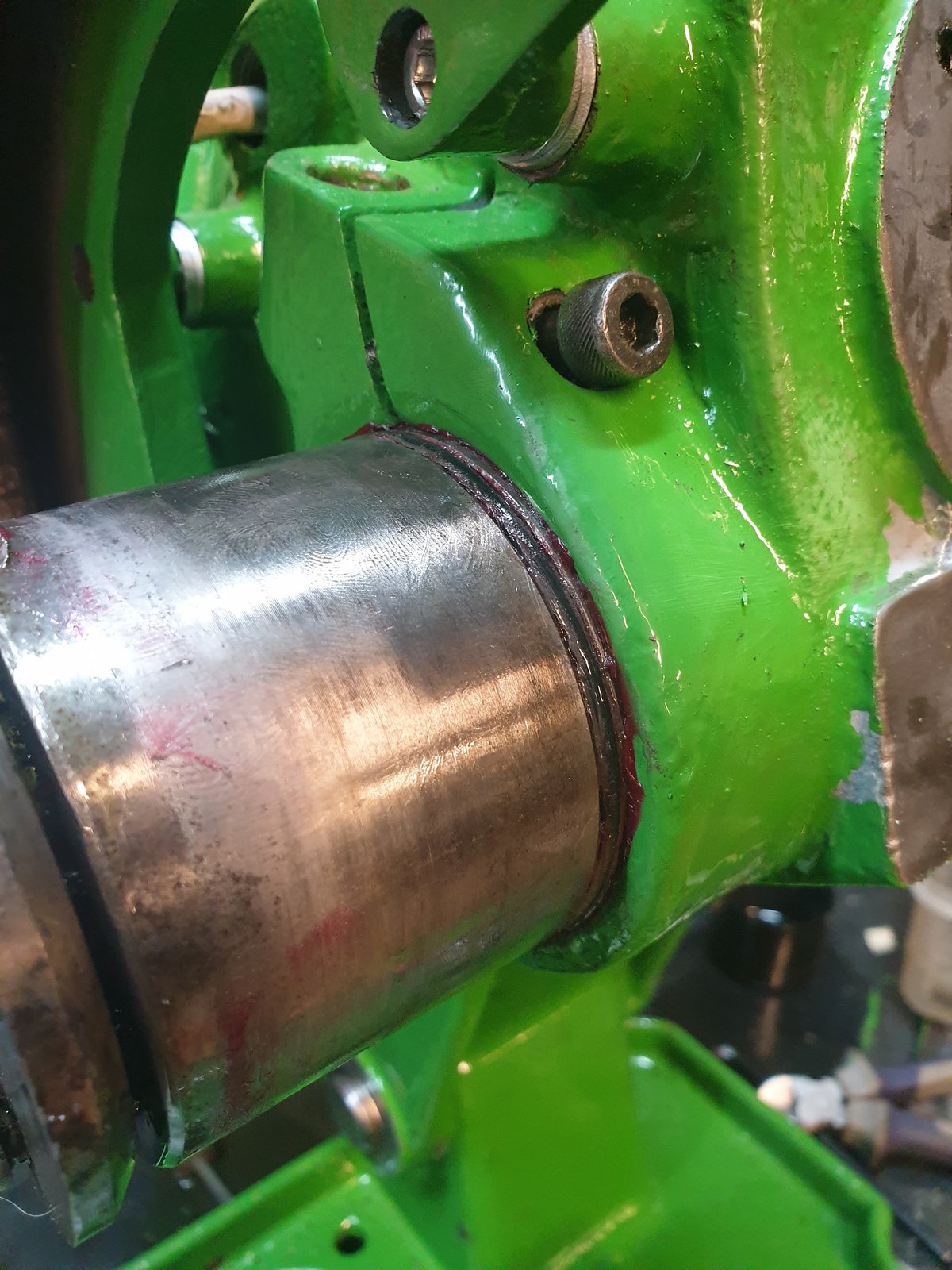

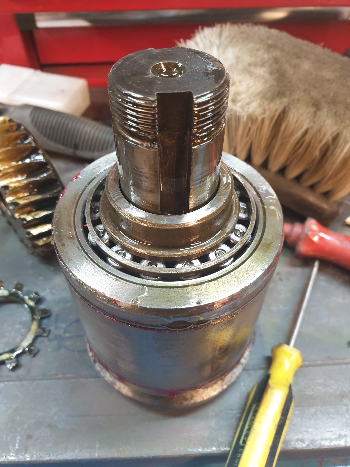

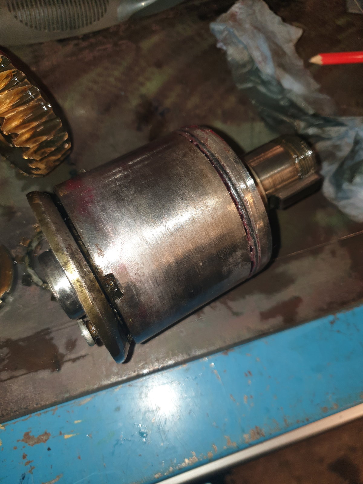

Gone to put new oil in and its leaking from this which is where the blade attaches at first I though the o ring was still leaking
However it turns out its leaking through the inside through the bearings, but its sort of a gradual leak so I am thinking a seal gas broken but I'm only guessing, but I don't know how to strip it down any further than I already have. Any help appreciated
