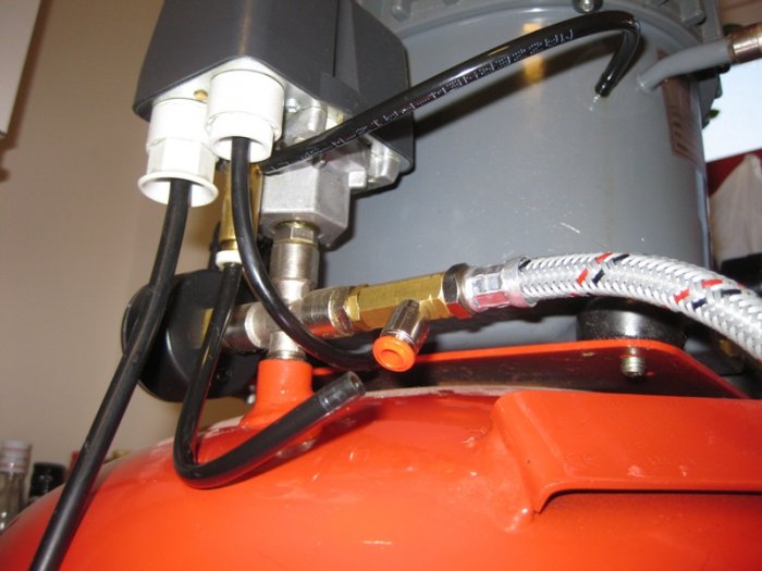

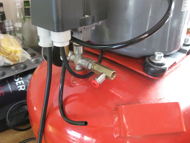

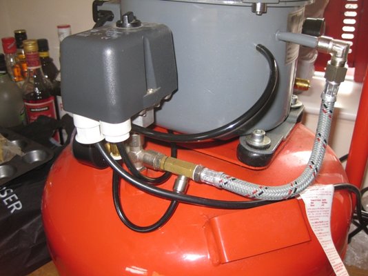

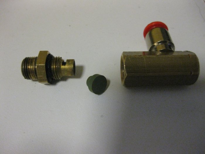

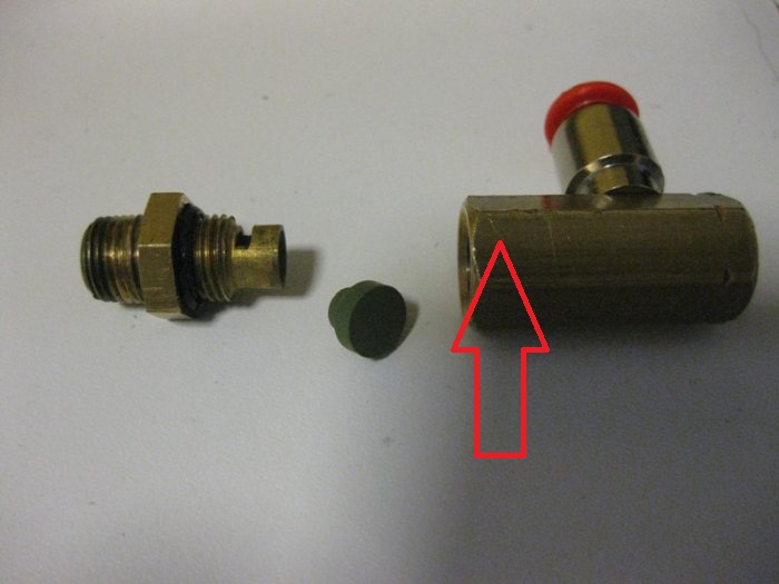

right i keep having problems with a leaking non return valve on my clarke shhhh compressor. i can clean out the non return valve the machine then runs good for like 5mins and then i can hear it blowing air back out through the compressor casings. if i slacken the pipe that comes out the compressor you get the air venting, so its deffinately coming back past the non return valve. i have replaced the non return valve in the past for a clarke spare and it didnt really make it any better. if you suck and blow through the valve after cleaning it, it doesnt inspire me with conifdence as sometimes it seals and sometimes it doesnt. can anyone suggest how i can replace what is there with something more reliable?? pics attached. the only issue i see is that there is a pipe t'eed off the non return valve that would need to sorted as all the NRV i can find are just an in/out.
