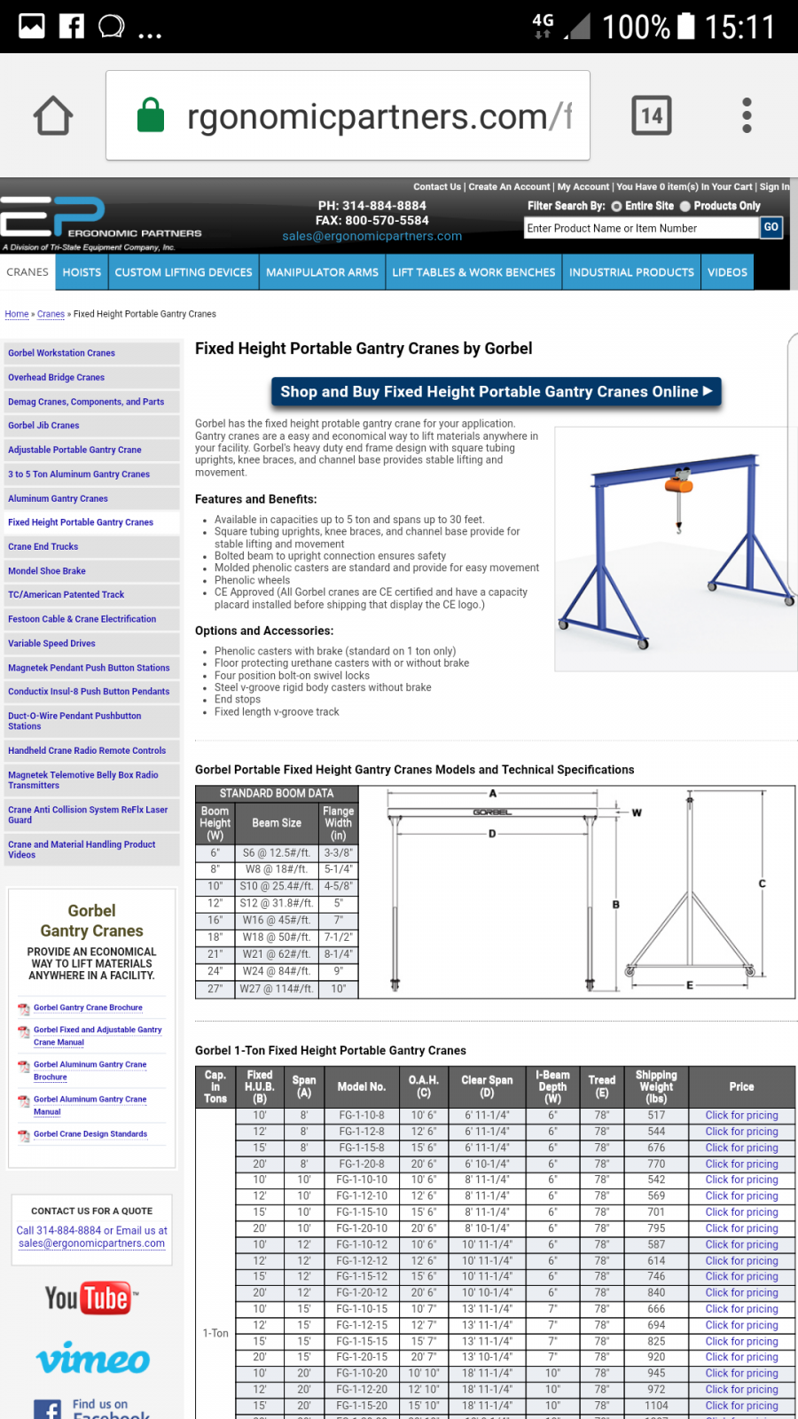

This website looks very handy! If you're building it for home use fill your boots but if it's for business use don't bother, the red tape and insurance issues will be horrific!
I spotted this website a while ago when I was prowling the internet looking for lifting beam dimensions and capacity without having to do any sums! I put a fixed beam in my workshop.
The design must be fairly solid as it's a commercial product, but I agree the 'A' looks stronger.
