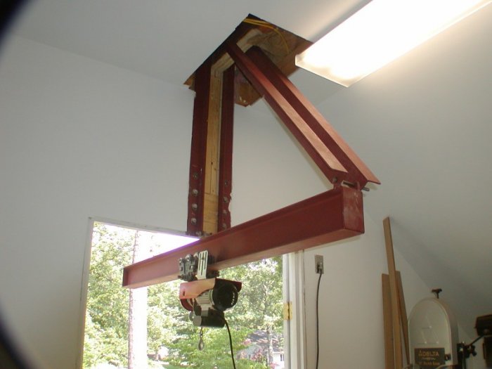

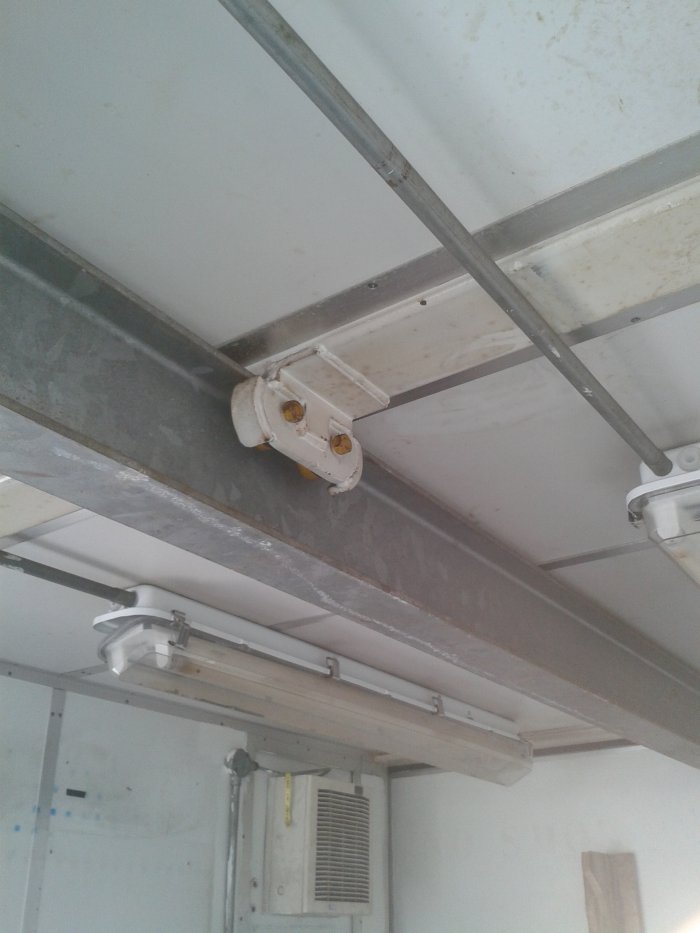

I have built a new workshop/garage which has an upstairs. I have an external door to the upstairs which will just be used for access. I want to set up a system for lifting stuff up and in (the door opens inwards) using a small electric (400Kg) hoist.  I live beside the sea so galvanizing is necessary.
My plan was to use a shouldered eyebolt fixed into the block wall with a wire strop outside holding up a small length of I-beam (rsj) to take the hoist attached to a plain trolley. The I-beam would be fastened inside, too. This would then all be demountable when not in use and the door could be closed over.
However, eyebolts are a problem if the direction of force is not through them (only usable at 25% of eyebolt load at 90 degrees pull) and those eyebolts which can take non-straight forces aren't galvanized. I have decided to put up a frame bolted to the wall instead after a lifting engineer told me this would be a better idea.
Any suggestions as to how to do this most elegantly and keep the system demountable so that I can close the door?

 Interesting pics of that lifting gear though.
