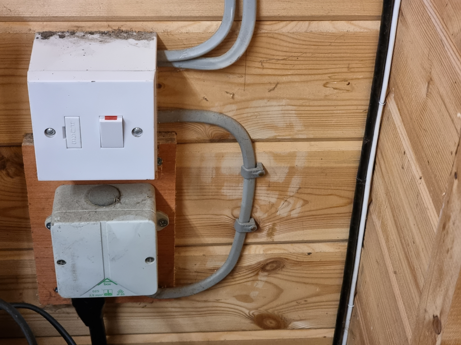

I have to re-wire the workshop because:
1. The sockets are randomly placed at random heights which must have suited the original owner but don't make any sense at all for my layout.
2. I'm fully re-boarding the workshop with insulation so I can get rid of the plastic surface mount boxes and replace them with flush mount metal sockets
3. I'm not entirelty happy with the way it's been done. For instance one half of the workshop has an armour coming from the CU though an underfloor duct into a junction box, with a single T&E coming out of that into a fused switch, which acts as an isolator for not only the lighting circuit but also seven double sockets on a radial circuit one of which has a further spur off it
So my workshop is essentially two timber garages end to end with a 6 foot gap that's been bridged to make one continuous workshop inside. There is a consumer unit in one end near the house serviced by an armour through a cable duct under the slab. The workshop is split into 2 sections with a roller shutter between them. One section holds all the equipment lathe, mill, grinders, gear hobbers etc, the other will be work benches, welding, storage etc.
I want to have 3 lighting circuits. One for minimal lighting so I can just light up the entire workshop if I pop in there to get something. I have the original twin mini-fluorescents for that because they will reflect off the silver foil roof insulation and spread the light. Then I want to light each half of the workshop separately so that if I have no machining work to do I can just light up the bench area. I have some LED 600x600 ceiling panels which will offer a more diffused light, but downwards only so they will be local lighting. I'll have to see what sort of coverage they offer
For power I want to put in two circuits feeding separate wall sockets in each section of workshop. I favour ring circuits for no other reason than I've never lived in a place that didn't have them. Is this still acceptable these days? If so I will put one ring circuit in the machine shop (fed from the above junction box, but not through that switch) to power all of my machines and another ring curcuit directly out of the CU in the welding/bench workshop with a load of wall sockets for power tools and charging station etc. I also want to put in a couple of 16a radial circuits for the compressor and welder.
