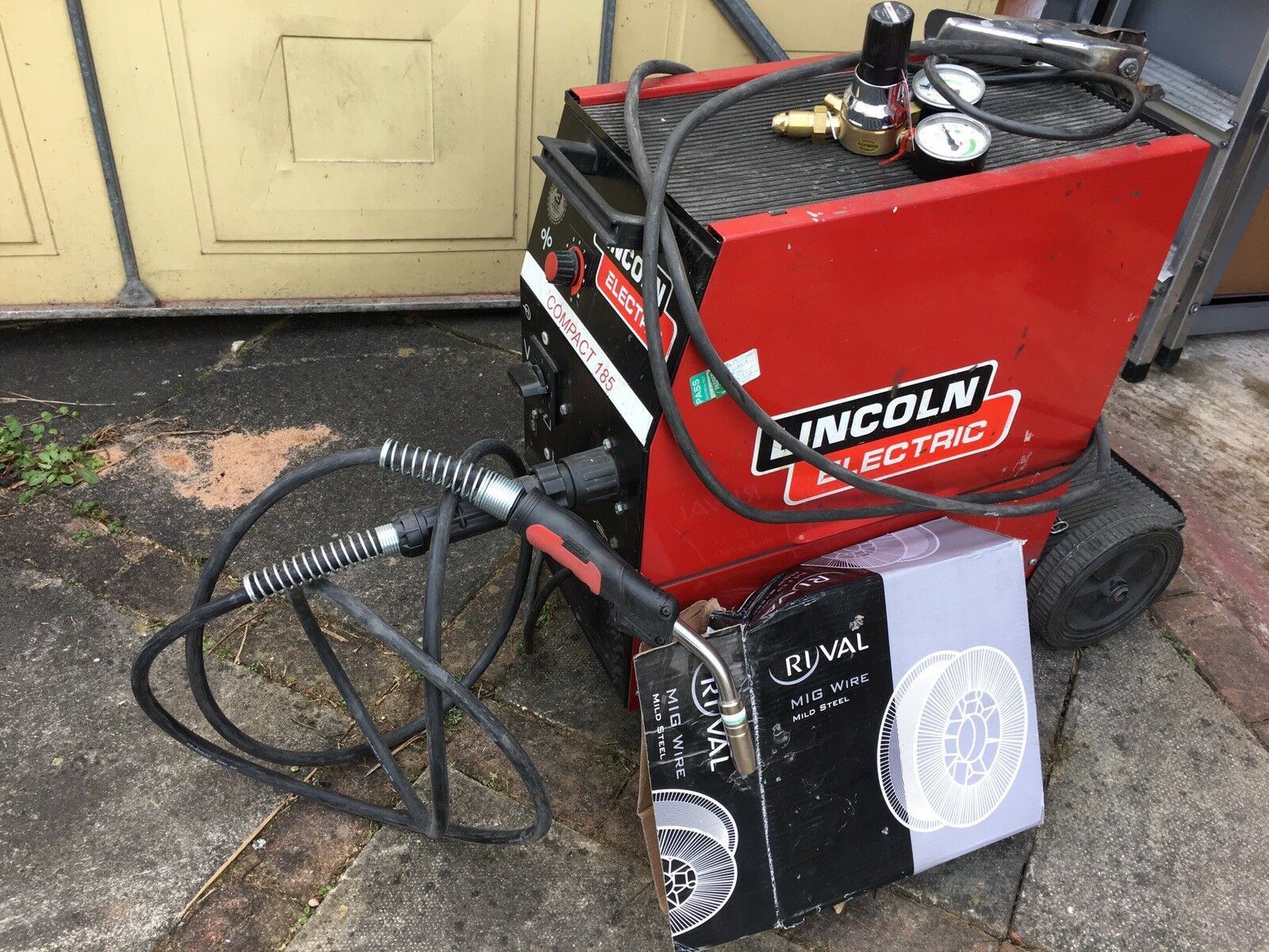

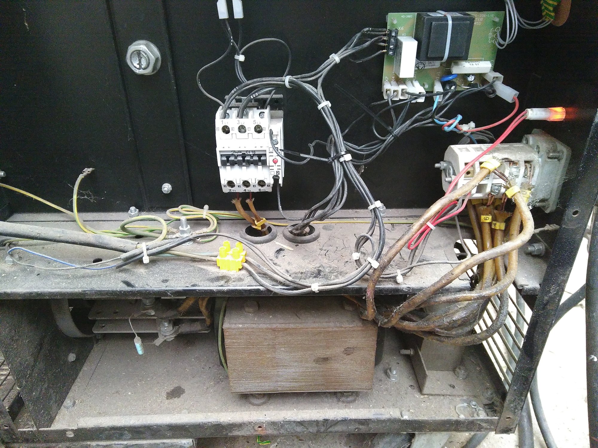

Bought this brand new 9 years ago and has had a fair bit of use however it stopped working all off a sudden. Everything seems normal, fan running, relay shuts on trigger pull but no wire feed or arc. The wire feed motor runs ok on an independent 12v supply so I thought that this could only be a problem with the PCB as it seems to receive 230v, but no 12v output as far as i can determine with my dvm. I ordered a replacement PCB for £65 but this has made no difference so I am at a bit of a loss. Any ideas please?

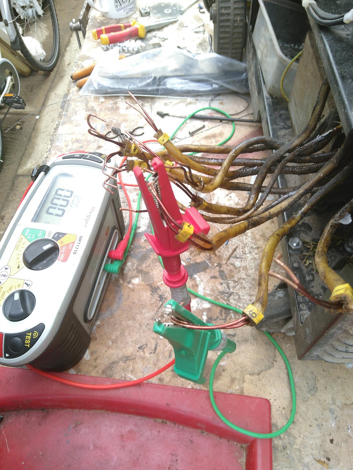

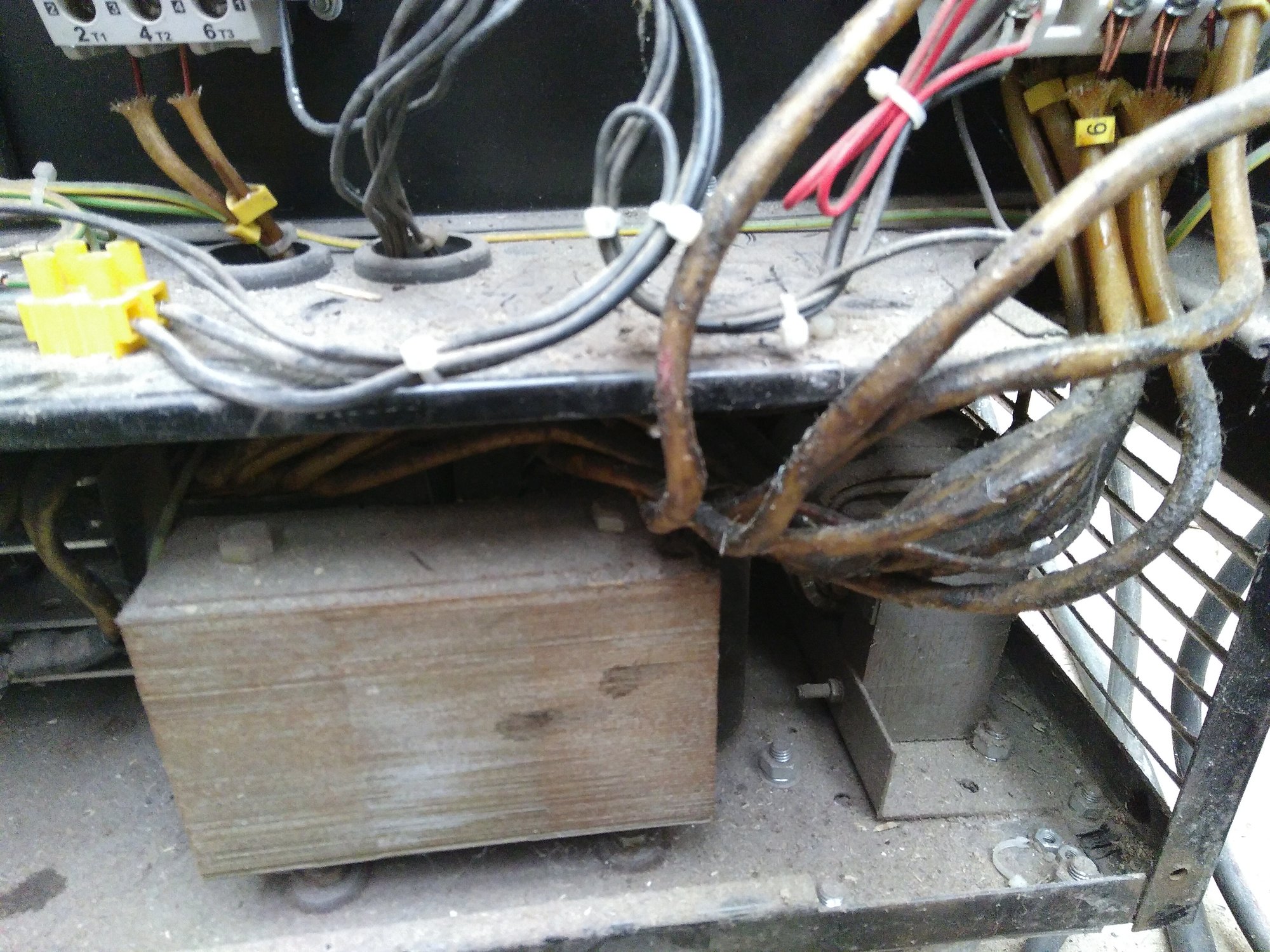

BTW The multiple cables that run from the rotary switch down to the main transformer have gone gloopy and stick together see pic below. I was reassured by the welding servicers who supplied the pcb that this is normal. Any comments there?
