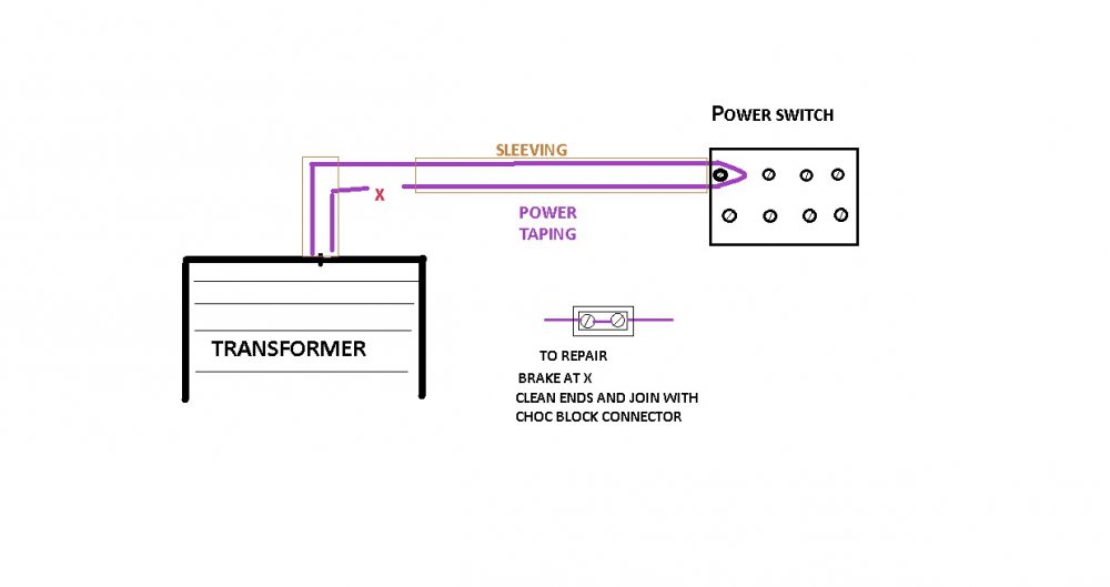

i'm having issues with my lincoln electric 185 compact.
the problem is when the machine is when i pull the trigger on i can hear the contactor pulling in and hear the gas coming through the solenoid, but no wire feed and no arc???????????
i have changed the pcb for a new one and it made no difference.

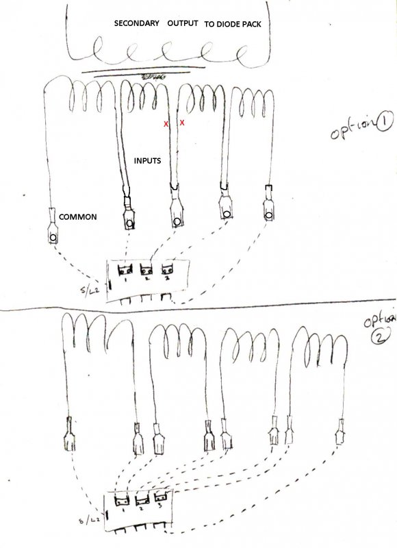

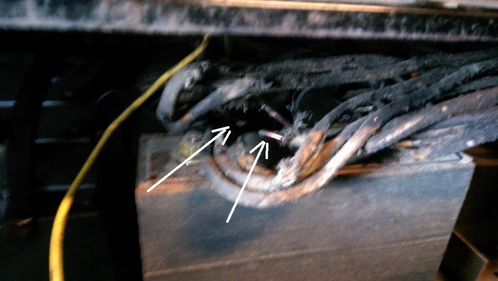

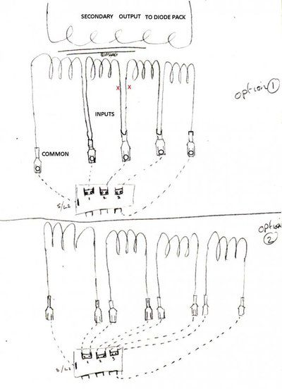

now on close inspection i have noticed a broken wire on the main transformer, so not sure if this will cause the issue or is un-related as i had a problem a few years back and the engineer who came to fix it said that something was wrong with the windings and he had to bridge the switch so that powers 4-5 were the same.
can anyone please advice me where to look or whether it is safe to reconnect said broken without it causing something else to blow.
