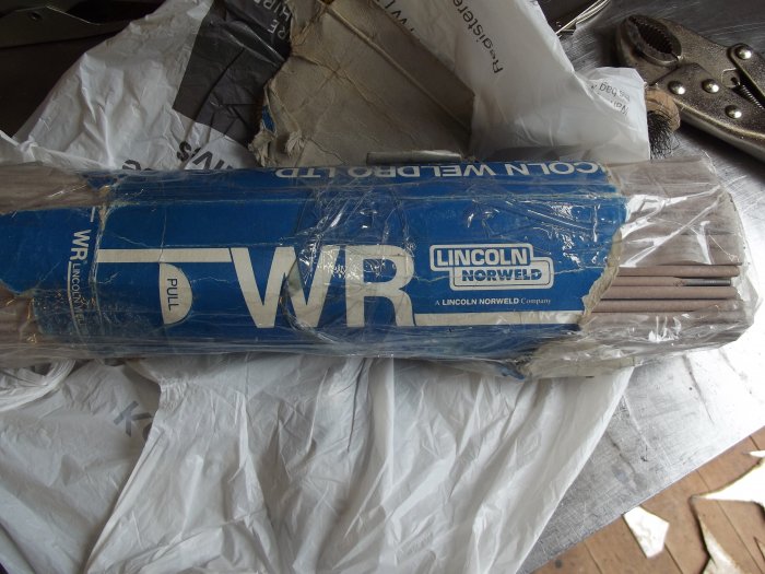

A mate of mine goes to these auctions at night, he came down earlier with these welding rods, soon as I saw "Lincoln" on the box i thought yesss, they appear in good condition a little dusty, I thought for £3:00 they were worth a punt, did i do ok guys?
Weldro were a premium brand before they were bought by Lincoln and their products absorbed into the Lincoln stable and then the name and the products disappeared. I don't recall when that was, 20 years ago?? But these rods must be quite old.
Just picked a random rod out of the packet and it welded as good as the new lincoln 2.5's I got off fleabay, so hopefully all good, I never get a bargain so I'm chuffed lol

If so they are WRX453 and were our alternative to Vodex. Originally WRX45 but we managed to improve the mechanical properties, namely sub zero impact strength, and the upgrades got the 3 added.
They are a sort of rutile basic so better properties than the normal 6013s
