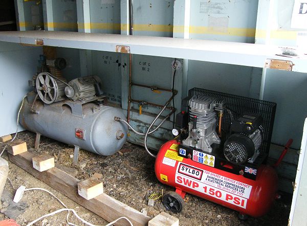

I’ve read it is possible to link or couple up compressors, but I need some advice as to (1) how to set them up to avoid exceeding duty cycles, and (2) what output pressure settings should I use on the 2 compressors to avoid any problems.
I have 2 compressors:-
Clarke 3 HP (indirect drive), 14 cfm air displacement, 50 litre tank, max pressure 10.3 bar, cut in pressure approx 8 bar.
Wolf Air 2.5HP (direct drive), 9.5 cfm air displacement, 24 litre tank, max pressure 8 bar, cut in pressure approx 6 bar, duty cycle 50% and continuous running should not exceed 15 minutes.
The Clarke is OK to run my air tools and spray gun. Bought the Wolf to run an air fed mask, but find it has a 50% duty cycle and continuous running limit of 15 minutes.
I’m thinking of coupling up the compressors to run them into a single fixed copper line similar to what Malcolm has done here at post number 3:-
http://www.mig-welding.co.uk/forum/showthread.php?t=5816
What I’m unsure about is how to set up the outlet pressures of the compressors to avoid the Wolf from continuously running.
