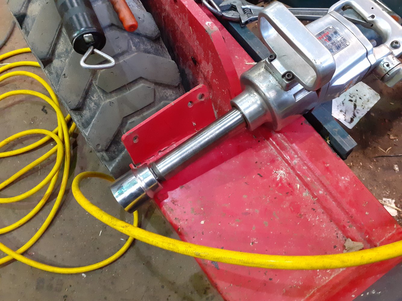

what for in case you shattered the standard socket as its not the correct impact oneI kept my eyes closed
Safety squintI kept my eyes closed
If I could find my 46mm 1" drive impact I would have used it. I hate losing toolsIf your not living life on the edge your taking up too much room, personally I would be using an impact socket as already suggested
Yes and razor sharp too..i have had a flake of chromium under my nail before todaySometimes needs must.
Main difference with impact sockets is the sidewall is thicker.
Main risk from a standard chrome plated socket is the chrome flaking off and shards of it being projected around.
