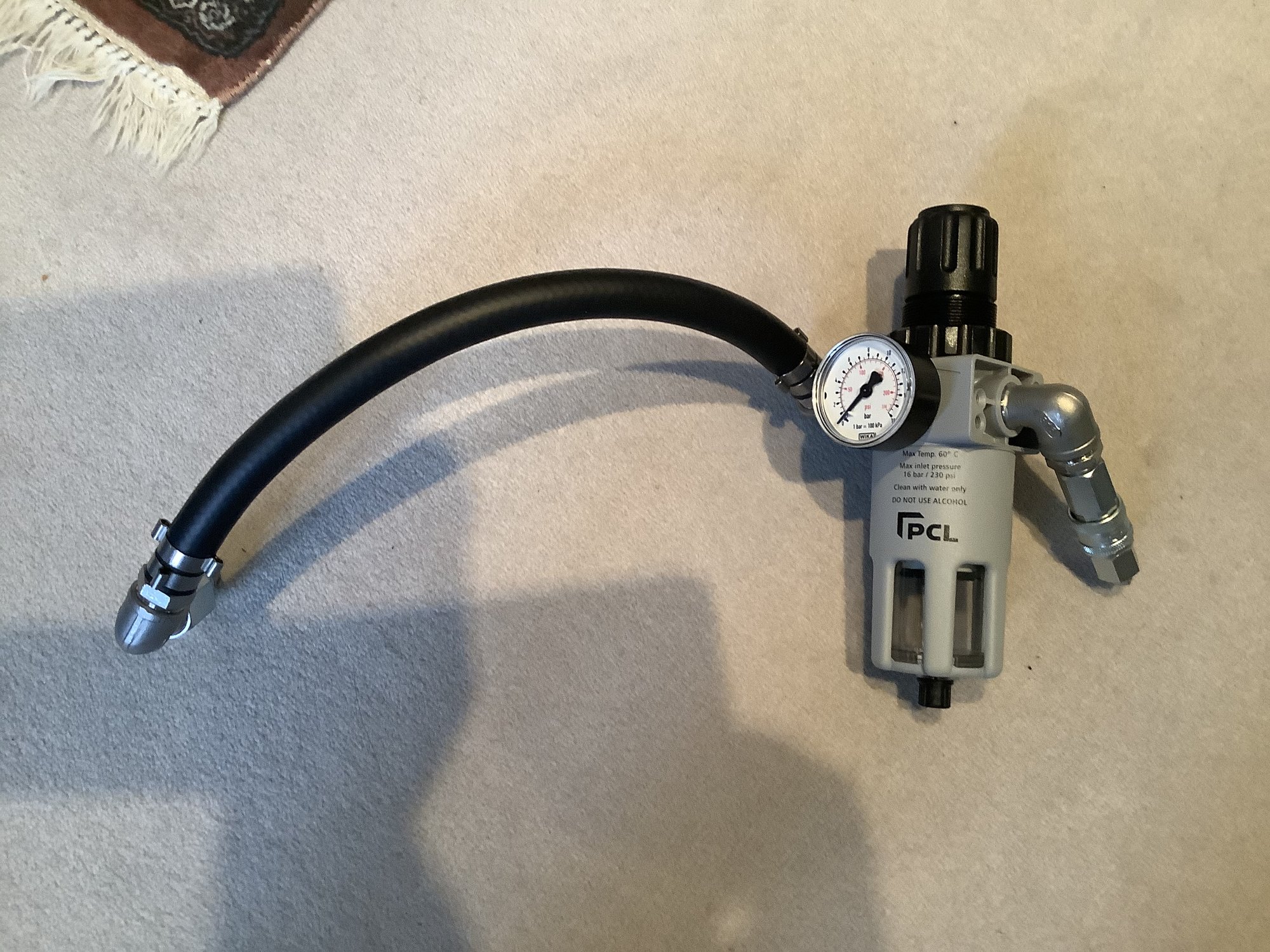

OK Ordered some of this, to seal the Air Filter Connections.
Being a series of right angles, it was a pain to get all the joints tight and pointing in the correct direction.
Some needed 4 wraps of ptfe, and some needed 8!, and then if it leaked, nipping it up a 1/4 of a turn to seal it, meant the angle was wrong.
Apparently the joints don't have to be tight with 577, you just need to leave it to set off 48 to 72 hours before pressurising it.
My question is regarding getting it as tight as possible.
Can you tighten it up till hand tight, and then back it off say 1/4 revolution to point in the right direction. Will it still seal perfectly?
Or does one have to count how many revolutions until the exact position (to avoid going past the correct position) ?
How difficult is it to remove? I know you can use heat to 250C if its difficult.
Do you recommend coating the whole of the 1/2” BSP male thread that will engage? (And wipe off the excess)
or just put a decent ring around the male thread?
