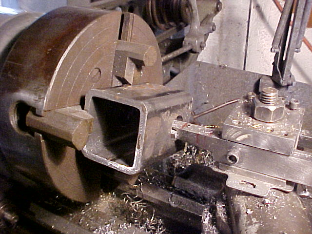

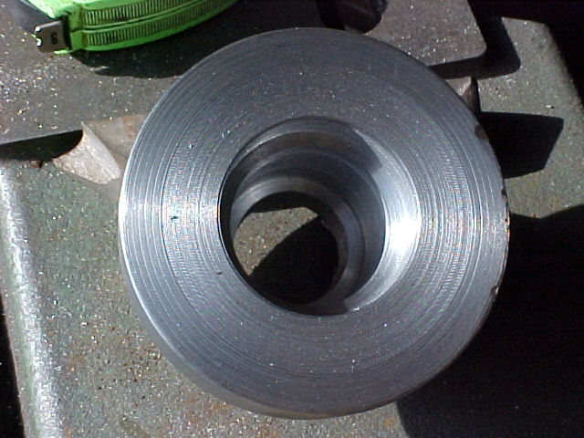

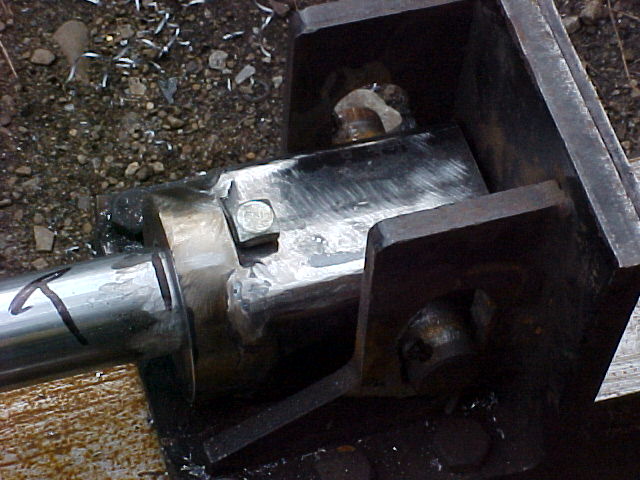

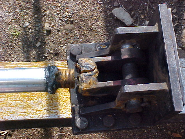

A guy welded a cast iron clevis onto a hyd cylinder and it broke, again. So i fixed it right. Bored a new collar to fit the shaft end and welded it onto a piece of 2 1/2" sq tube. Bolted to the cylinder this time. Like new again...Bob
