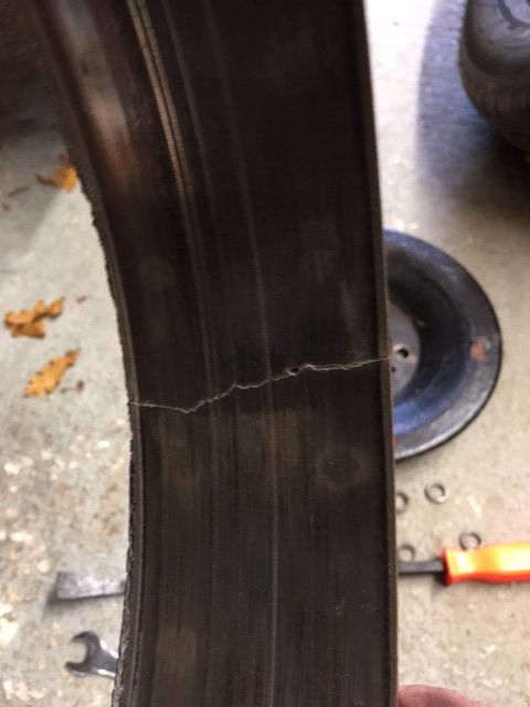

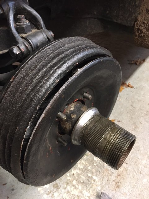

Looks like a toy car..Hi all,
I'm based in Hampshire. Before Xmas I had a drum break in two (see photo) and had complete failure. Since then I've managed to find four lightly used drums (two of which came off an Austin Atlantic) which really need the braking face cleaned up. I'm not sure how true the wheels are so I was hoping to find a machinist who could check the trueness and clean up/skim the drums. there is enough "meat" left on the drums which should allow a decent skim. I am just struggling to find some one to do the work.
Phil
@frank horton is correct of course, they can flex all over the place whilst trying to cut through the glazing. I’ve used a mounted die grinder in the past, but it’s a slow job. In fact, i’d Go as far as to say by the time you’ve made and skimmed the mandrel, and fitted a suitable clamp, and then skimmed/ground 4 of them you’ll be a day down (with dirty dust all over you and the machine), so I would say they need to be priced such that it’s worth the effort?I have one of these.....

it's not the best job on a norm metal lathe, lots of probs with vibration and harmonic's messing up the surface finish...
I think Laycock or someone makes a disc brake skimmer, both of and on the car but never heard of a drum skimmer other than the AMMCO....
I bought my machine coz I work on a lot of vintage cars m/cycles and tractors where replacement drums are not available....
