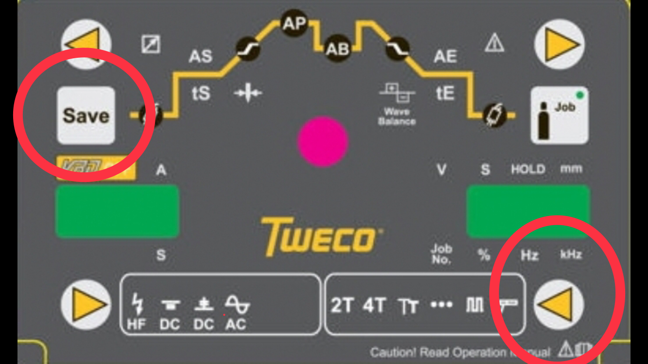

Hi there,thanks for your interest,I wanted to know the age of my machine which matt has now given me,He explained how upslope and downslope work as a percentage but I still can't get it as I am used to the 205 which is just a time in seconds.I have no Idea what gas post flow time correction is and I cannot get the user specific menùe c2 to work so I can use my superlex on a pedal without having to have a pin jumped plug in the front to avoid the machine saying I am using the wrong torch.Who can I get a new air filter from,regards John.What would you like to know?
it actually shows you the seconds in the other displaysay 7 seconds and set that as a percentage of 100%. So if you set 115% that should be around 8 seconds and so on.
It’s not that complicated you don’t have to work it out as a %

Ha ha I dunno mate. I’ve got the fisher price version.You beat me to it because I was trying to find out what button to hold to get to the background menu
The only background menus mine has is by pressing and holding the arrow key then press the save.
Not on the tweco there isn’tNah there is a user specific manual too. It changes a couple of non welding related settings. One being recognising if you have a water cooled torch connected.
