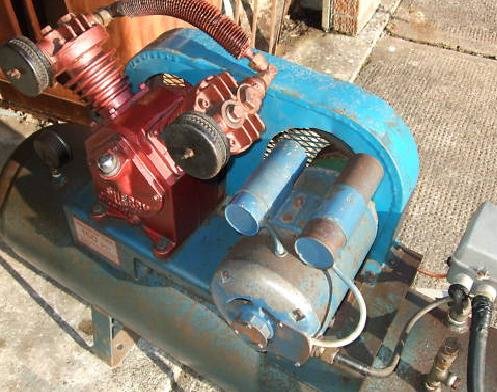

I have been using a friend's compressor for some time and now feel I should return it and buy my own. The one I have been using has a 24L tank and I think it is 1.5hp. The pump has oil in it.
I am looking to buy a compressor a little better than this and had in mind 50L tank and 2hp motor. In that size range some are described as "oil less". Is that good or bad?
My guess is an oiled pump will have alonger duty cycle. Over the years I have had a number of electric drills, sanders and immitation dremmels fail because I have used them for too long at a stretch.
Uses will be a spay gun (normally one panel at a time), schultz gun, die grinder etc. From the specs on the machine mart site 8 cfm 6.2 bar seems to be enough.
