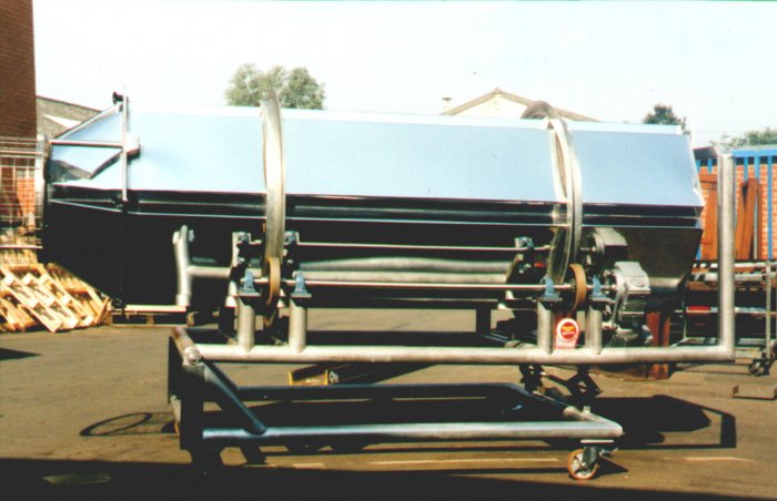

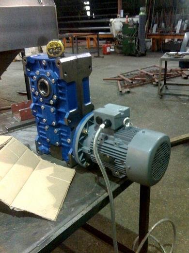

I dont know if you have a design but this may give you an idea or two, probably a bit bigger than your thinking of, but you can see the shaft mounted motor gearbox at the right hand end of the driveshaft, Ive also made benchtop rumblers using the same principle, powered by low voltage drill motors.
I see the principal now. I was thinking of a small blue gas bottle for the drum with a shaft welded to each end, but this design has it on rollers which is the way to go to make emptying it simpler. Thanks for the explanation. Did you make that one?.
