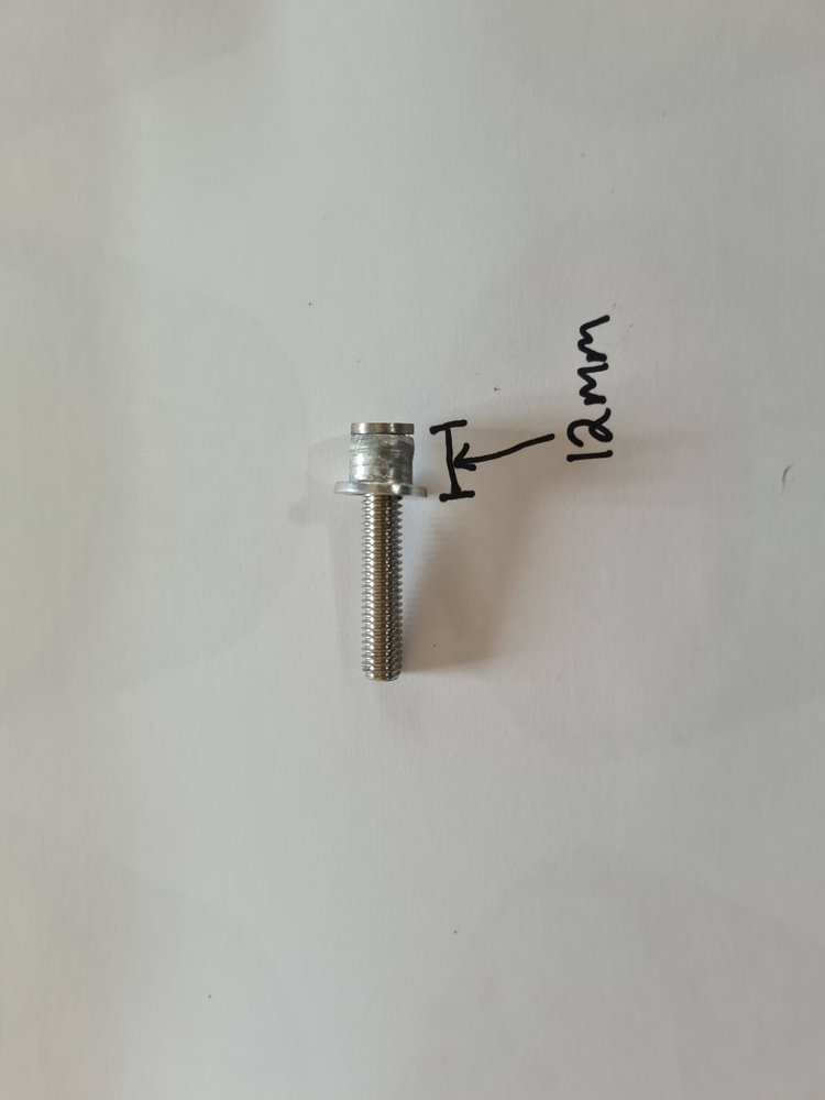

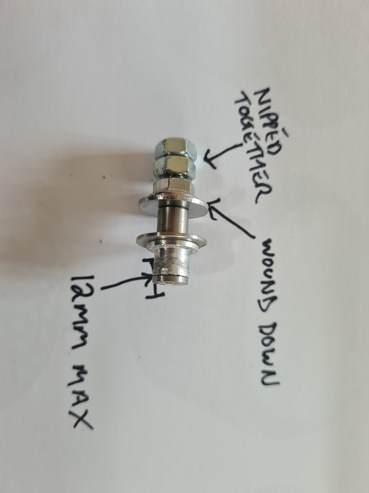

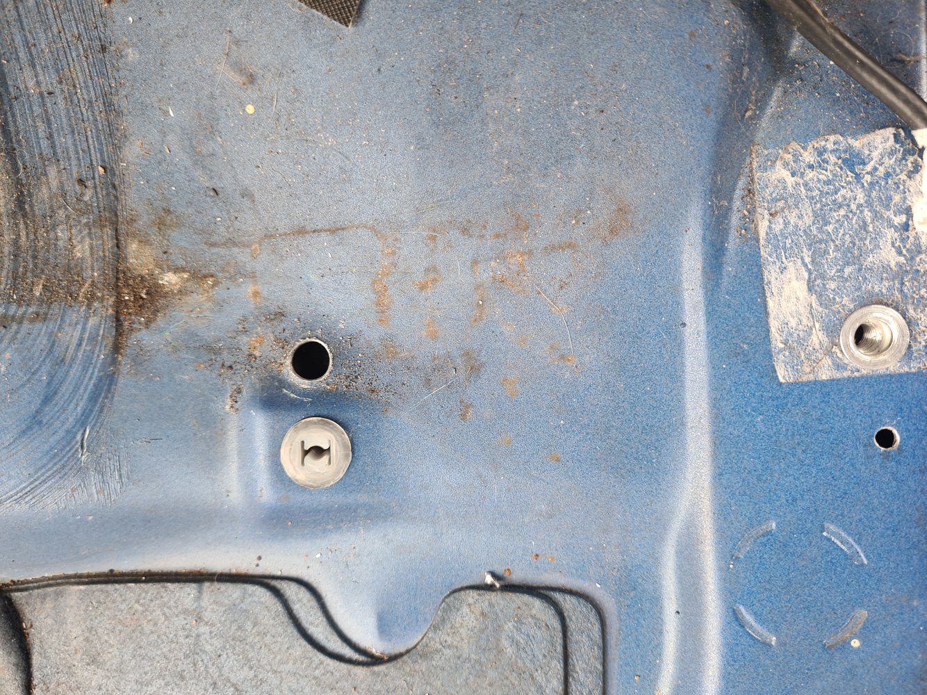

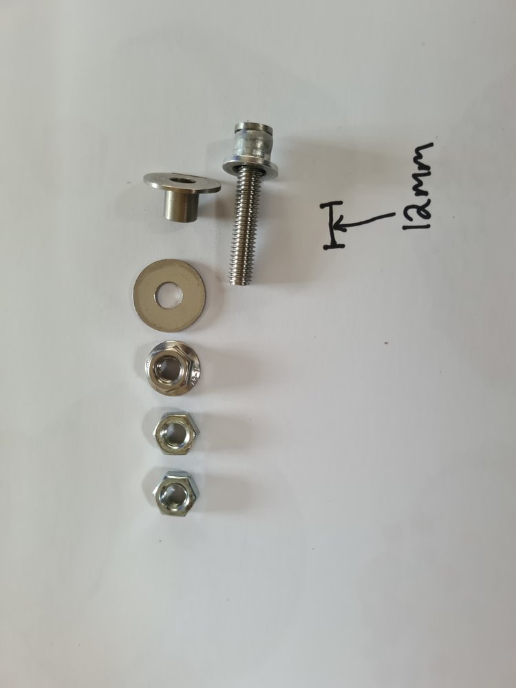

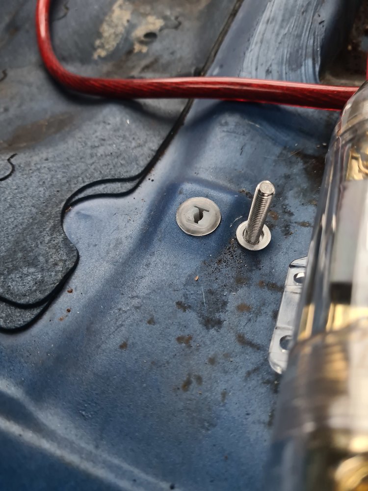

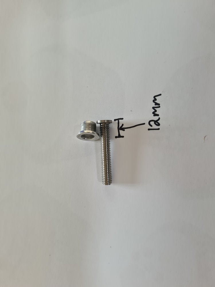

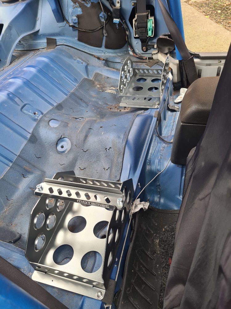

I have a bit of an odd problem with having to fix a stud with a rivenut or similar in a 12mm deep hole.
I have tried the following but bailed out as the m6×1.0 thread did not like tightening up enough to crimp the modified Rivenut.
If I could have pulled the stud straight up (like the Rivnut tool does) it would have worked a treat..

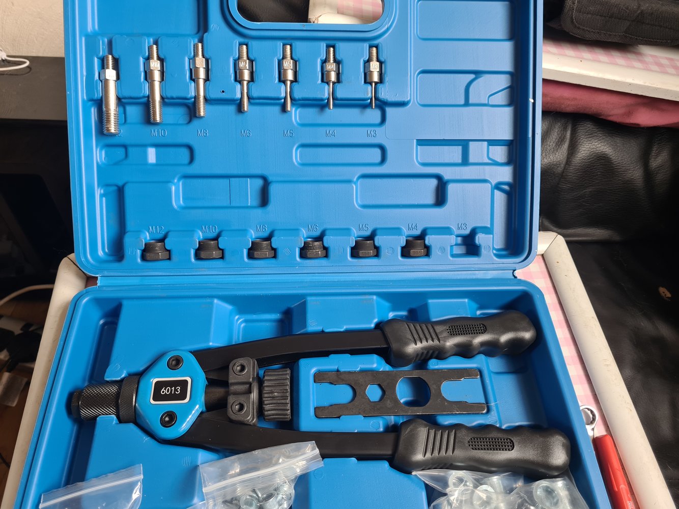

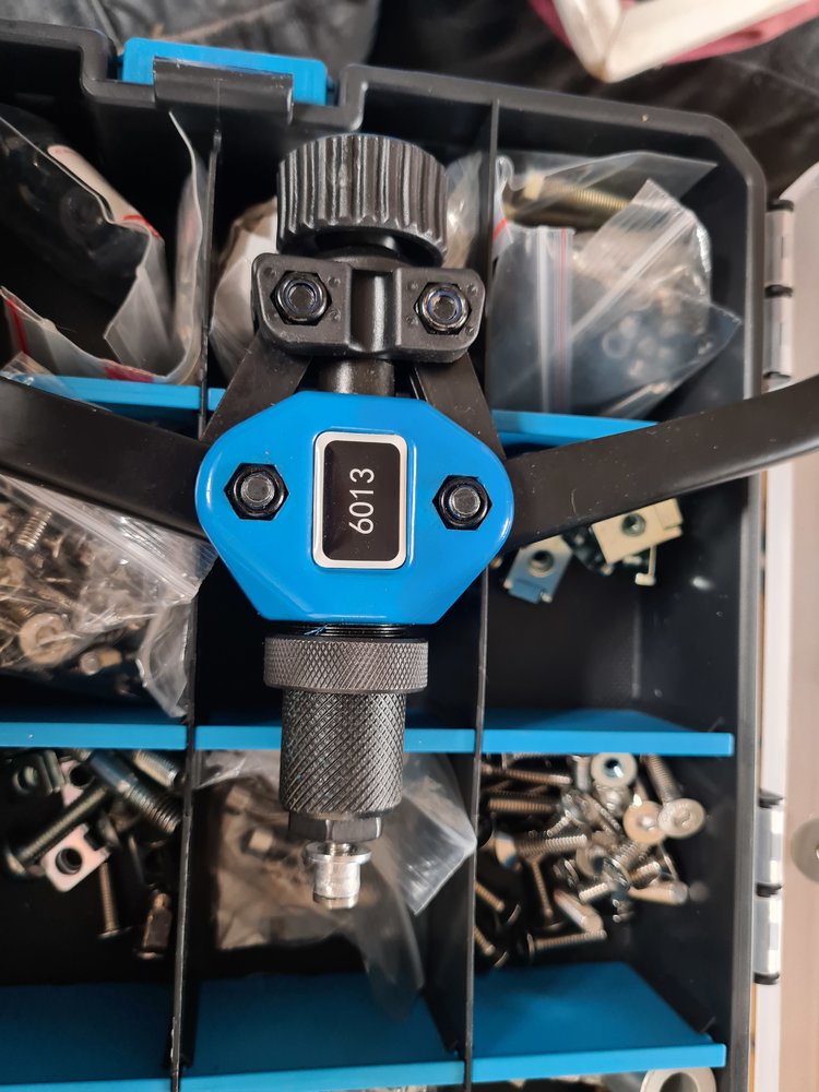

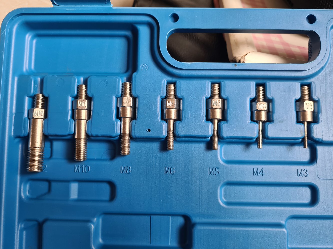

I have a setting tool with "normal" M8x1.25 receiver for the Rivenut dies so I was thinking of making an adapter (male M8 to female M6).
I only need 2 studs to be mounted but don't mind spending the time to make it a proper job, where they are going it will be a one shot deal really to get it fitted.
I can see me spending the afternoon trying to drill down an M8 bolt but any suggestions welcome!.
