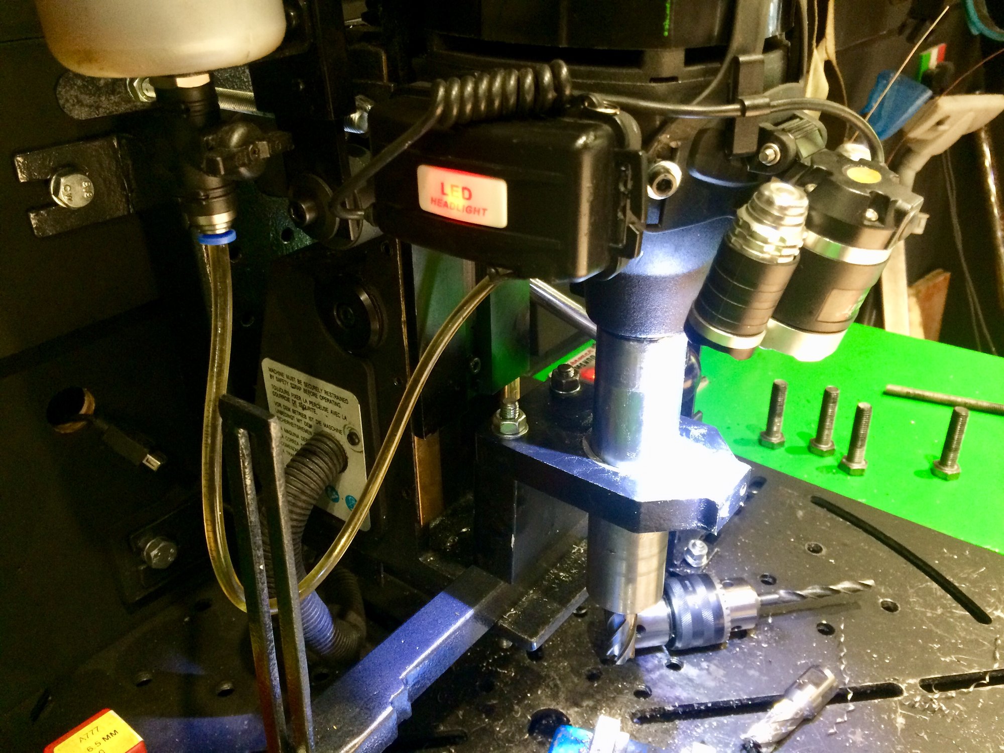

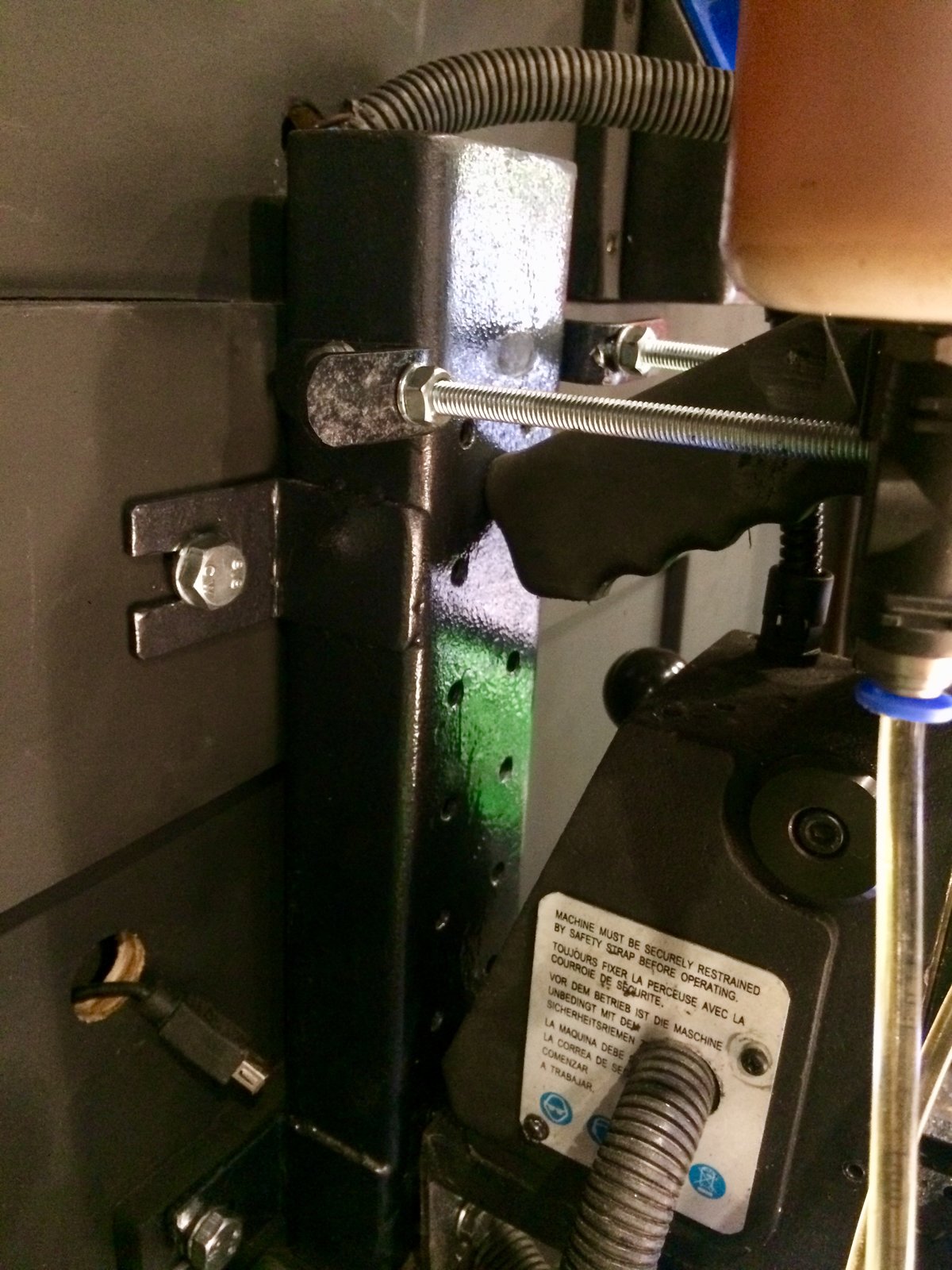

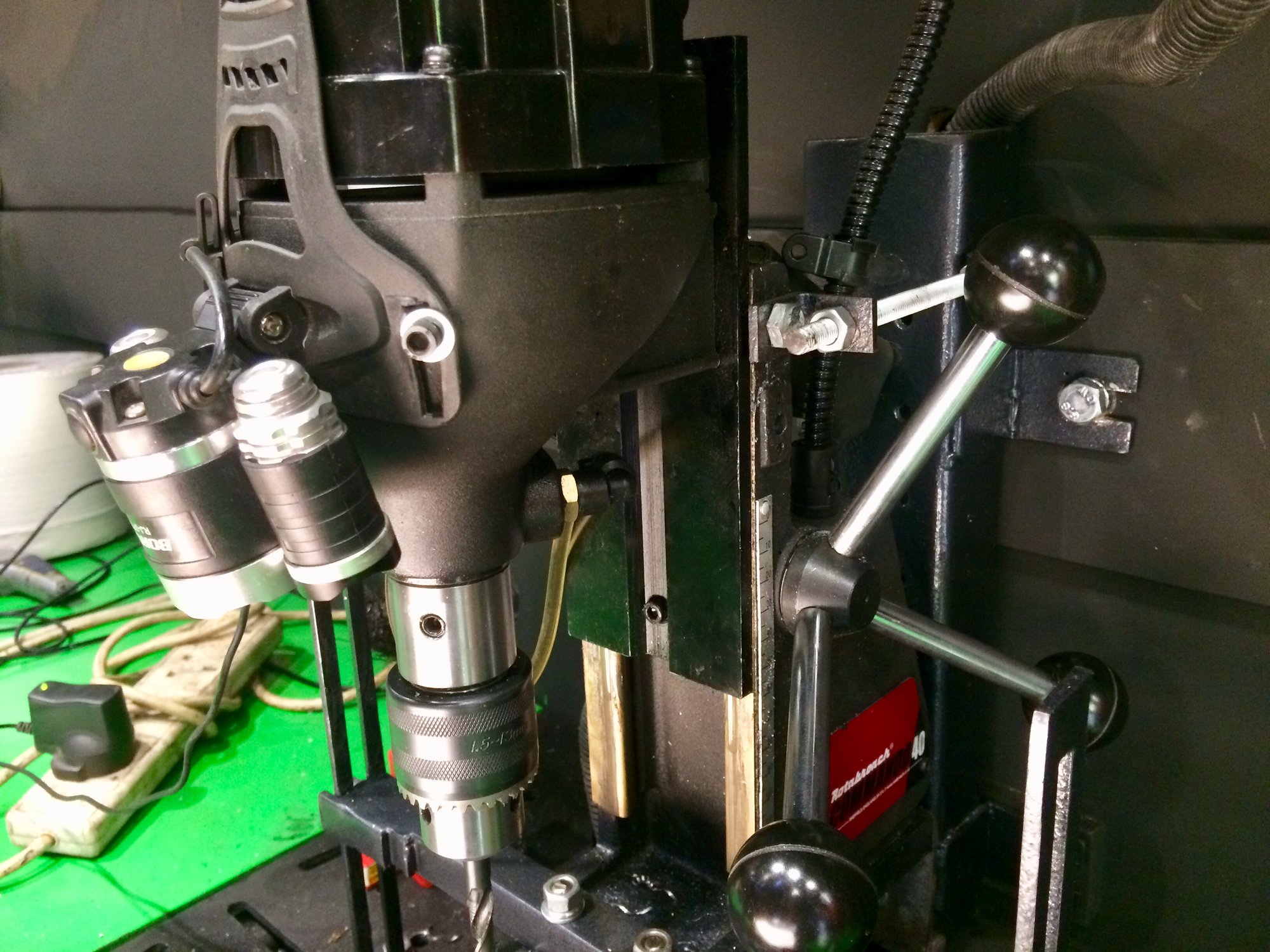

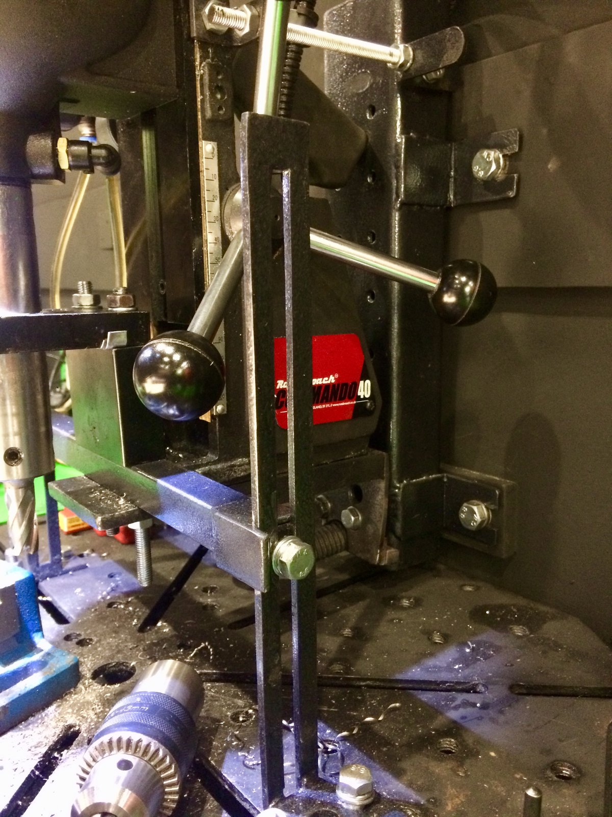

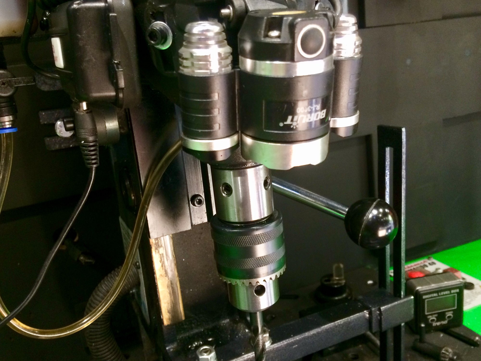

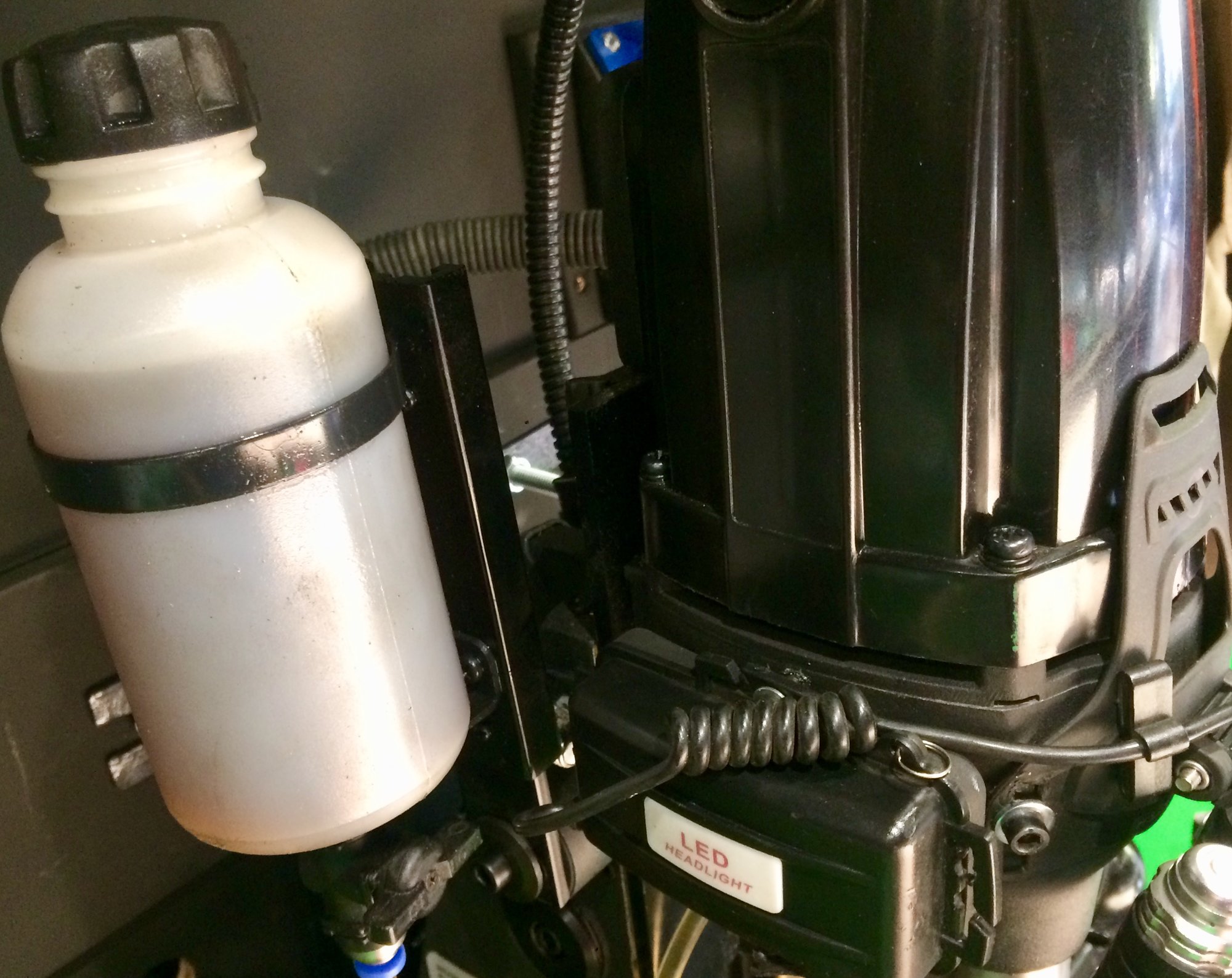

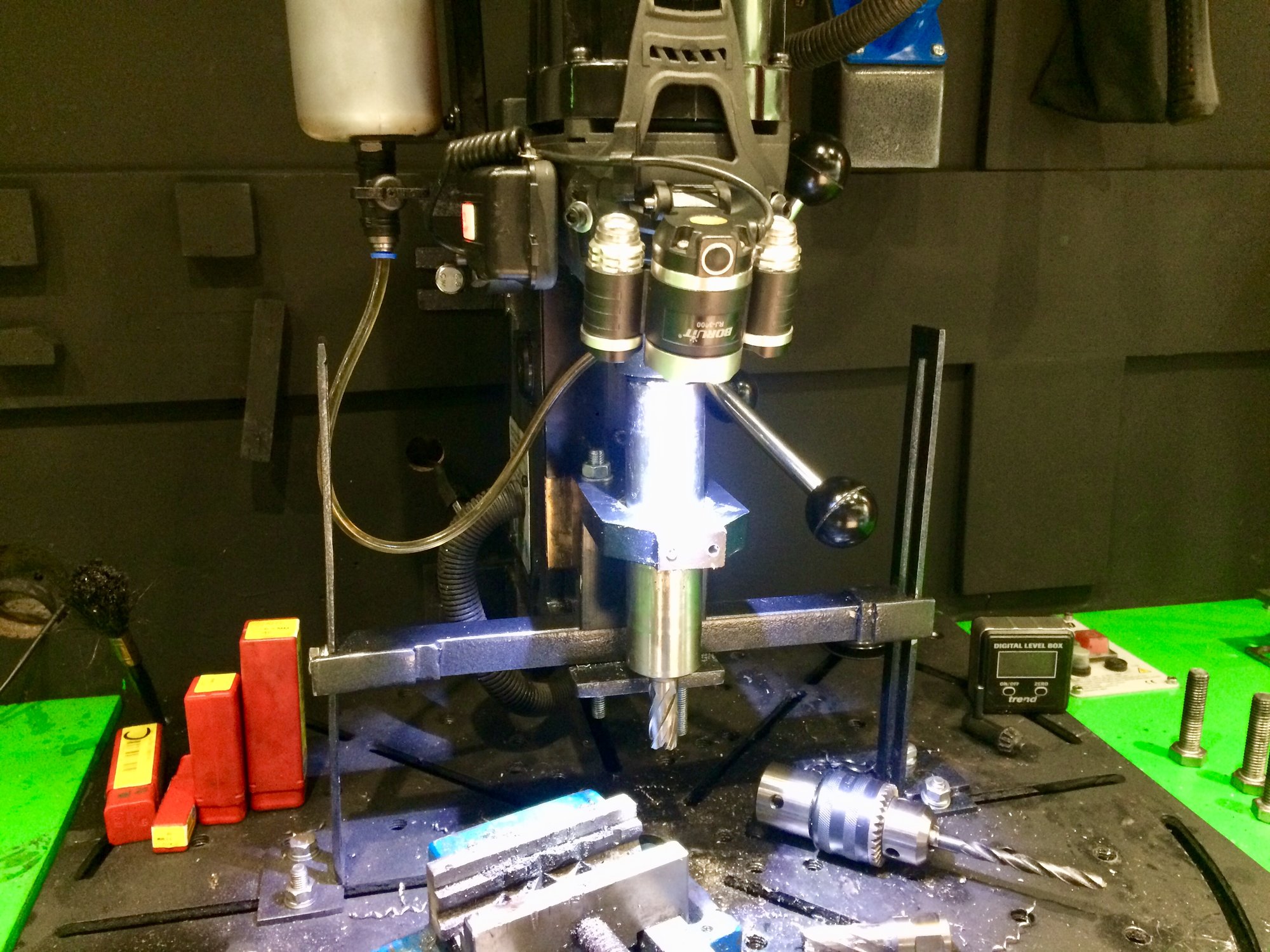

I purchased a mag drill on recommendation but unfortunately for me it wasn’t really suitable. I needed a rotabroach option yes, but also a drill for my bench, one where I could position my vice under it, the magnetic base stopped this, so, I modified what is already a wonderful work tool.. The control panel is now worktop mounted with the magnet fitted below the steel workbase, I fitted it to an adjustable height column with adj braces and stabilisers, cooling fluid is retained and an old led re chargeable cycle lamp illuminates the work piece.. Best thing now is a rock solid platform which is adjustable and the workpiece can now move freely under the column..
Below the worktop is a removable tray to capture dwarf and fluids etc..
