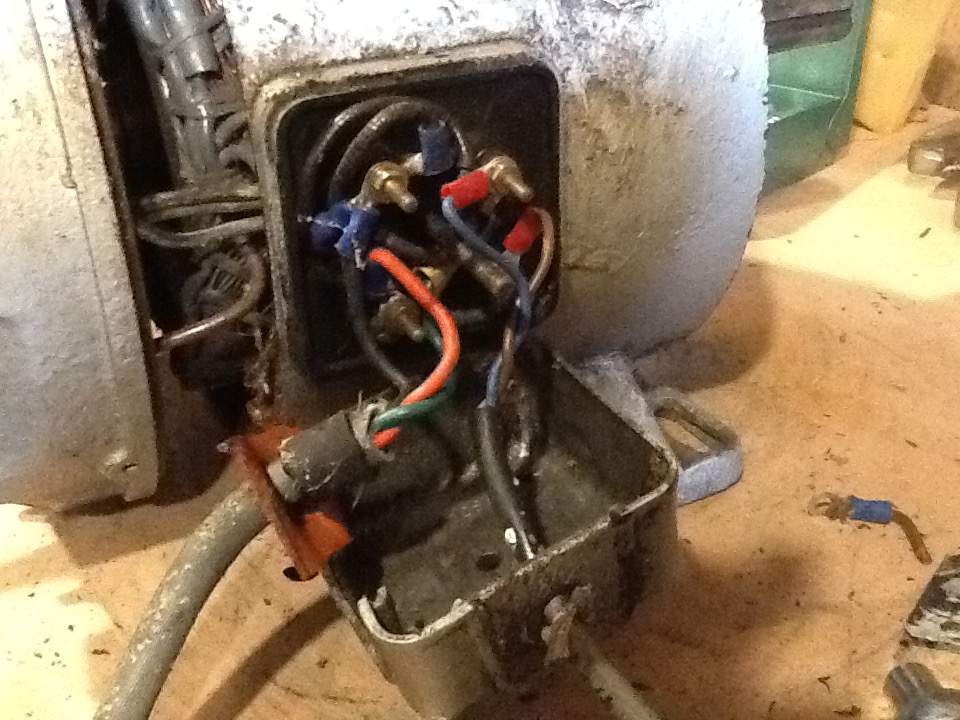

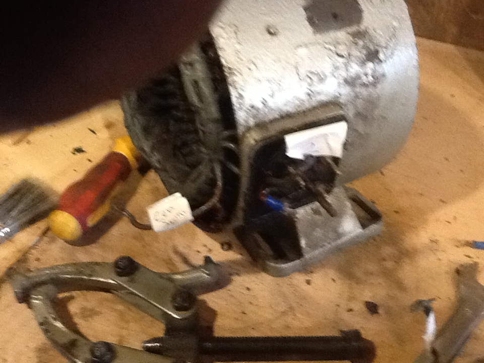

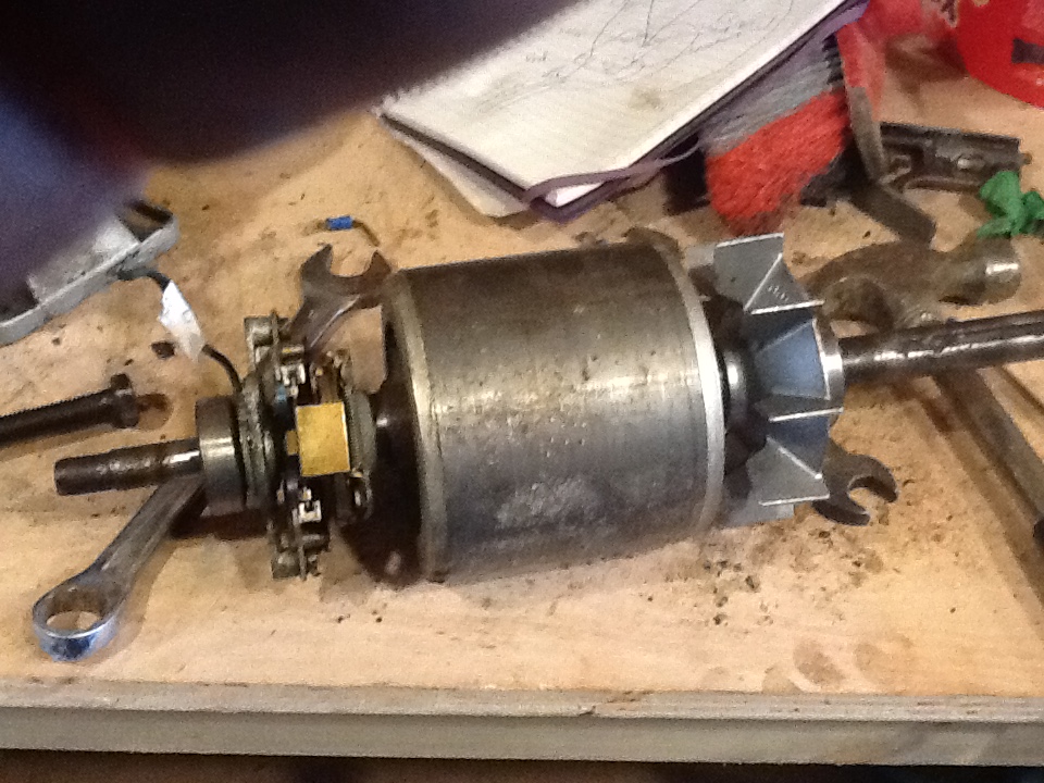

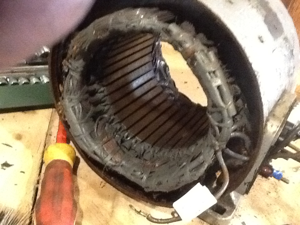

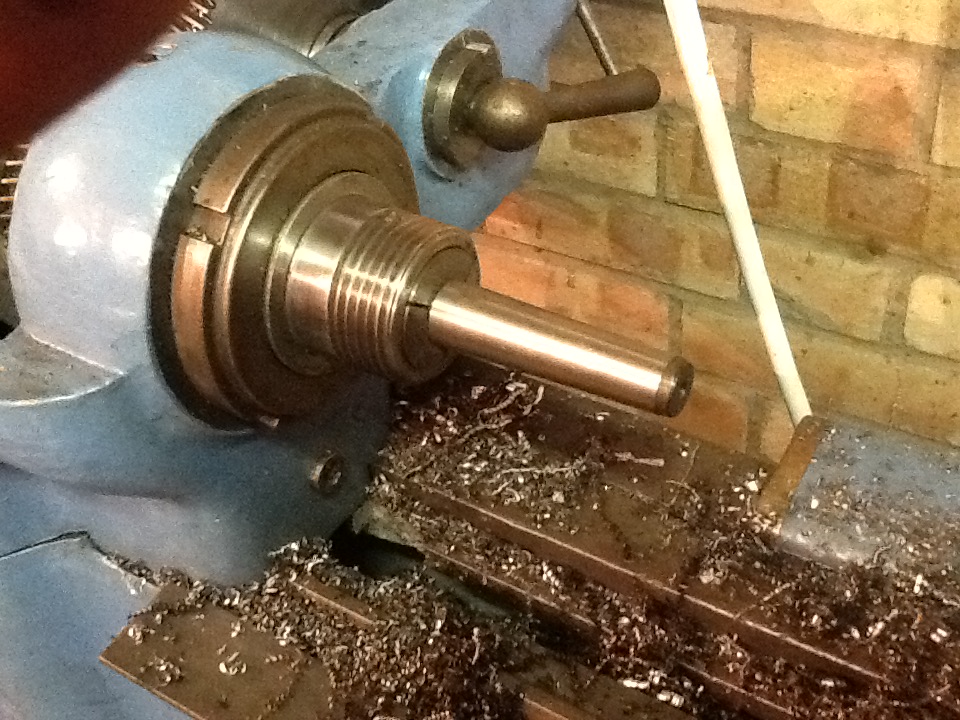

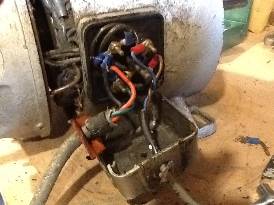

Big old single phase motor on my bandsaw has seen better days, the insulation from the windings have broken down and really need replacing.
Queue the old 3/4 hp from my lathe.

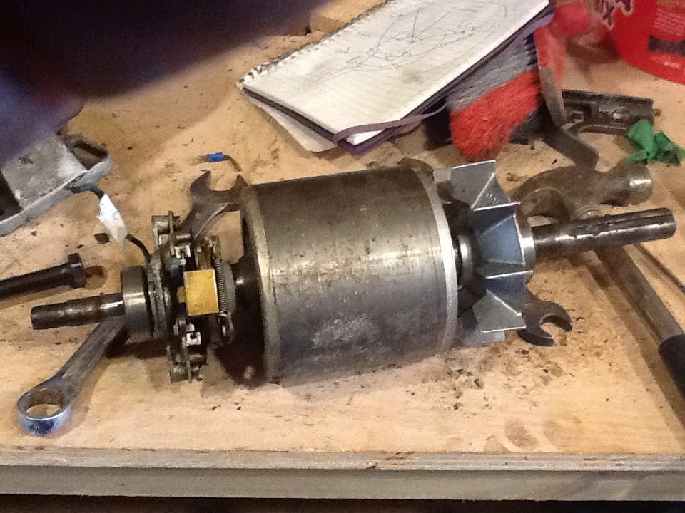

Opened it up to give it some attention. Wiring is good and the bearings are ok once in cleaned them out and regreased them.
So what's my issue I hear you say.

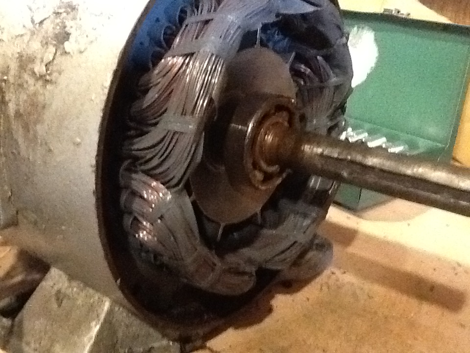

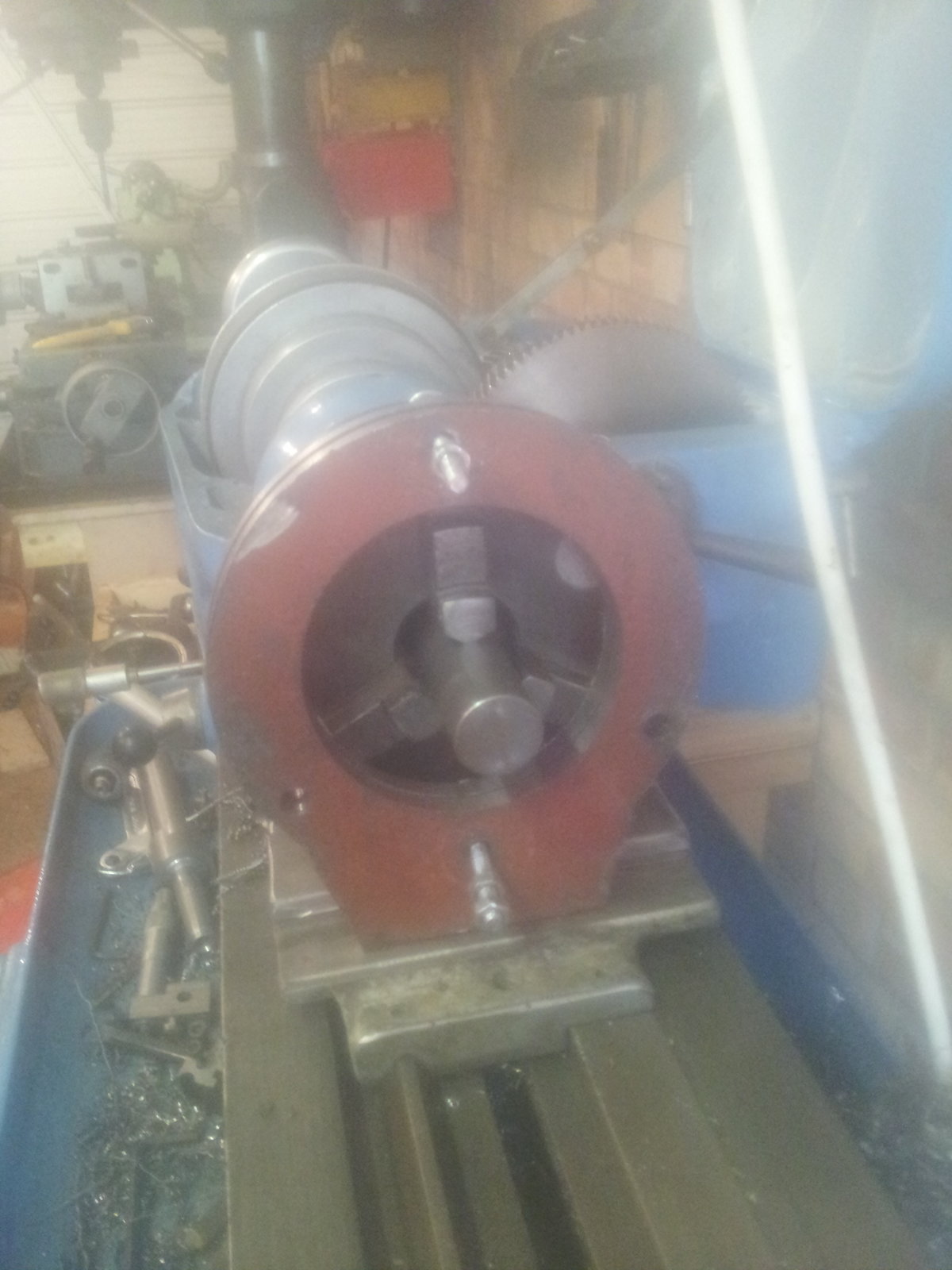

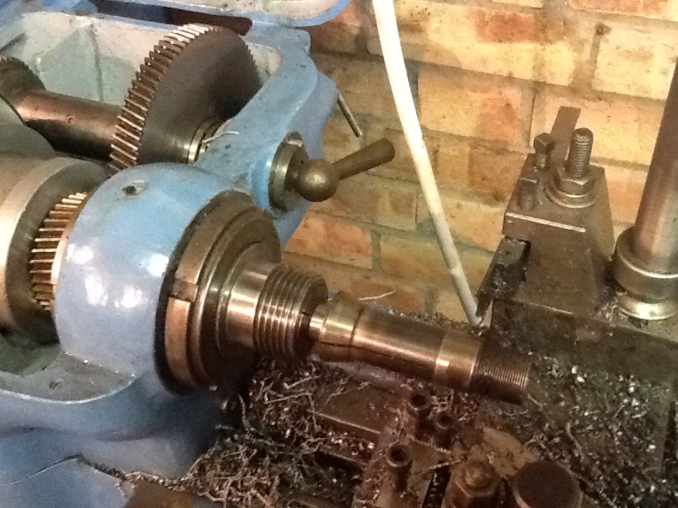

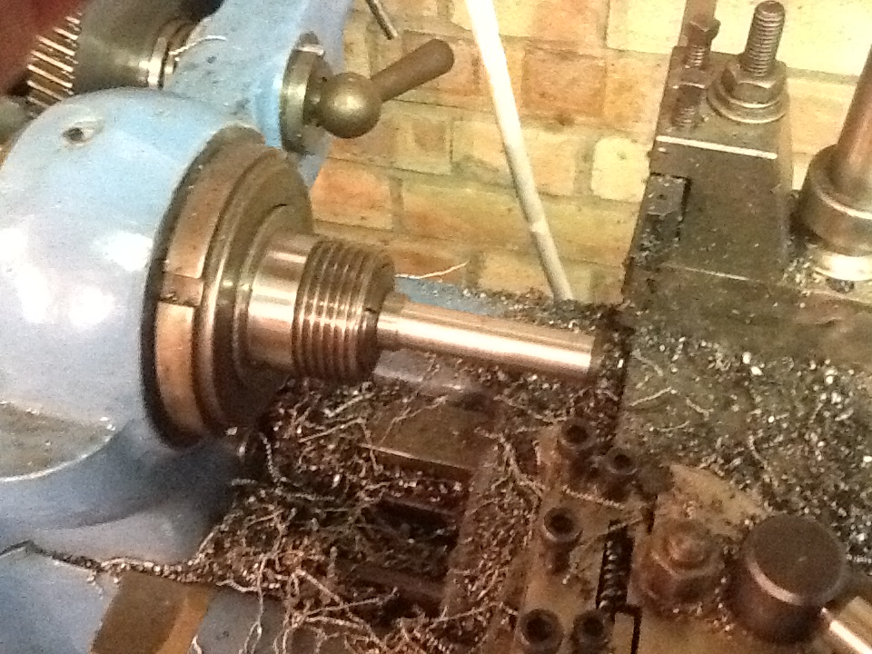

The shaft has been badly chewed and was causing a nasty knock where the pulley was rocking.

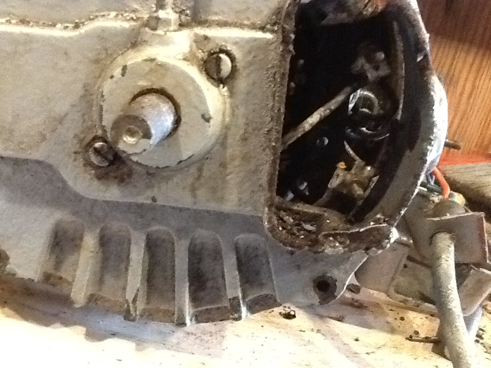

Short of making custom pullers to remove the rear bearing (little clearance between the switch and bearing.

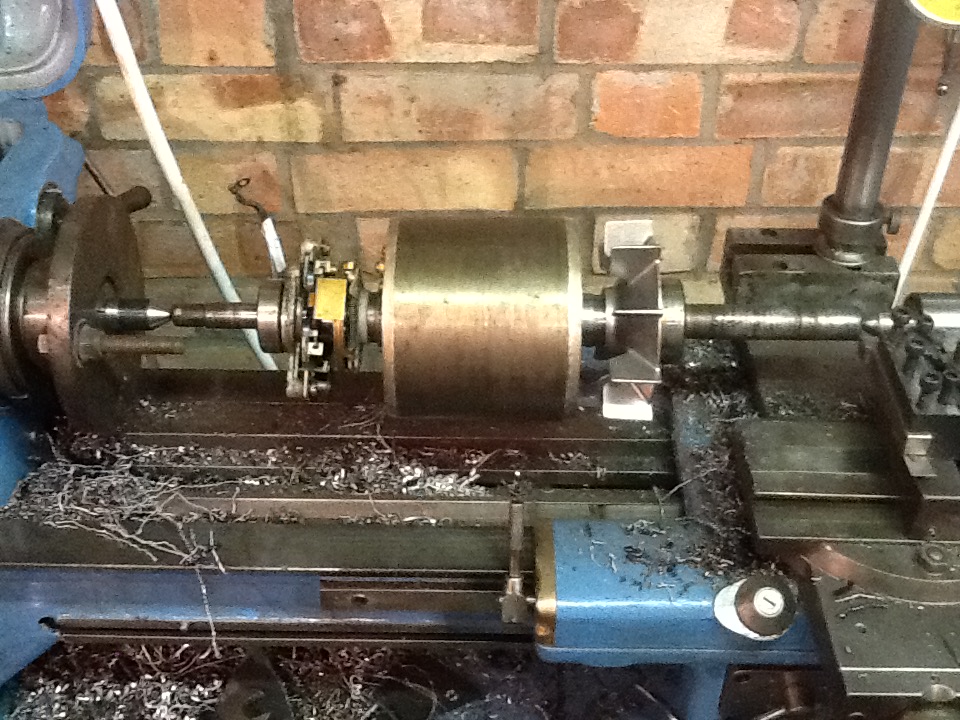

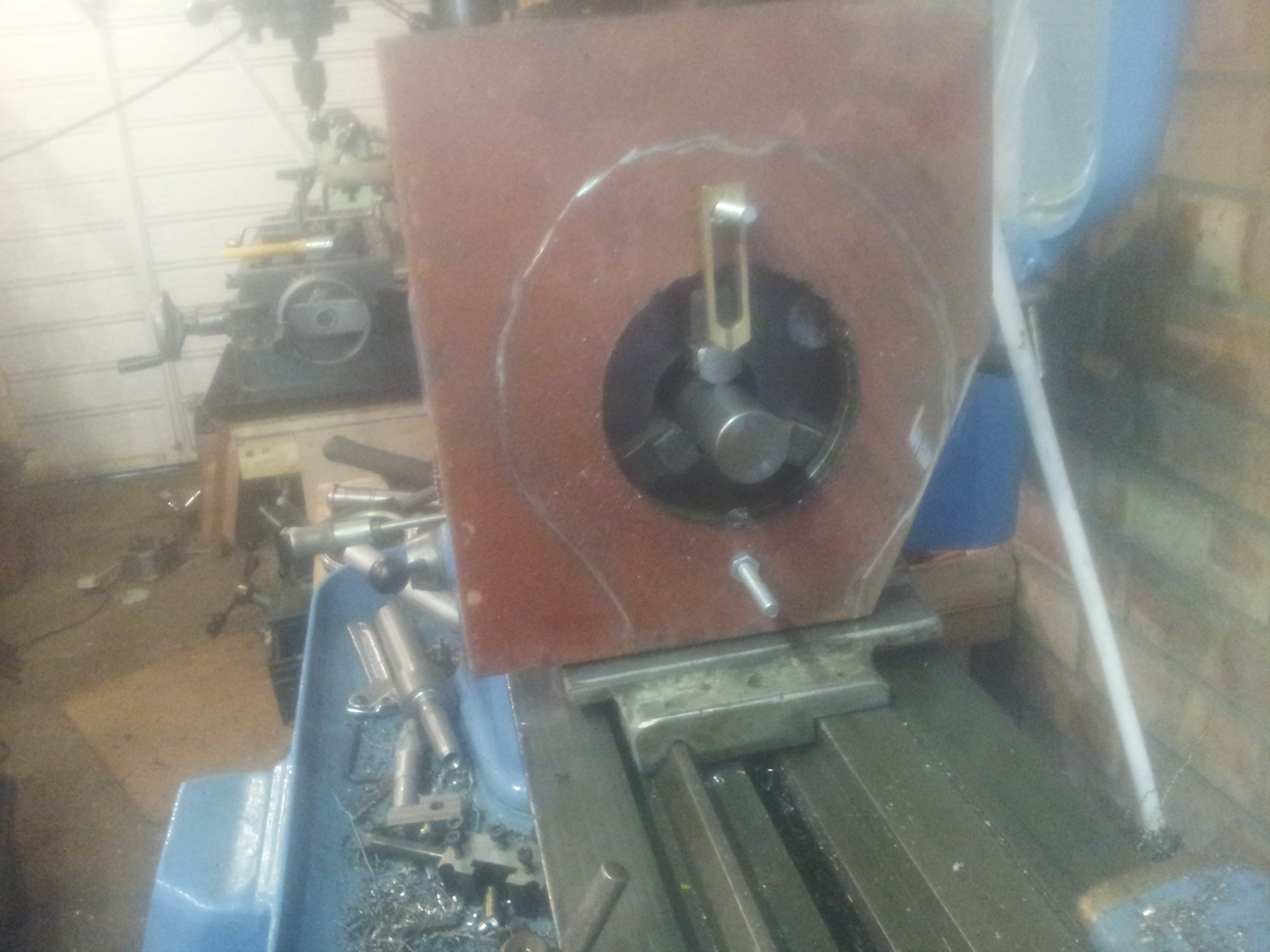

I'm going to have to mount between centres with the centrifugal switch in place.
Was planning to tape it all up to the shaft to stop it moving and run at a slower speed than usual.
So the question, stupid idea or not?
