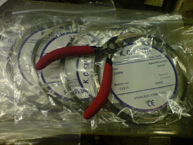

today I had a go at making some small compression springs as I wasn't prepared to pay the minimum order quantities for half a dozen so thought I'd have a go at making my own. I need stainless steel springs so got some hard drawn stainless steel. this is available from the far east via ebay etc if you're prepared to wait for it, but can also be bought from K C Smith Ortho Ltd.

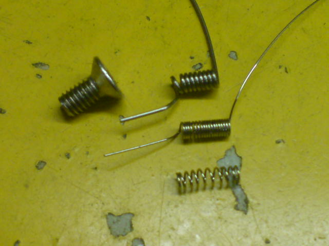

so these are my first 3 attempts at trying to wind a coil (spring) with a M4 screw for scale. this was done without change wheels for screwcutting, I used the mandrel handle to rotate the collet chuck in the lathe and or one turn moved the carriage on for the wire thickness. at this point I realised that I didnt need use the change wheels as the "pitch" of the coils would be 1.0 mm, when I turned the mandel handle half a turn, I'd need to advance the lathe carriage 0.5mm

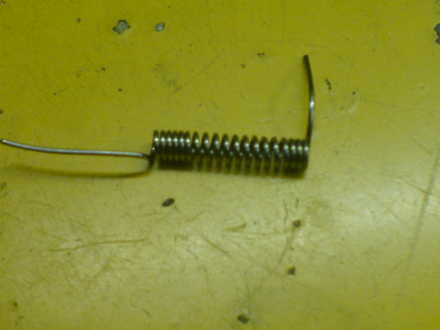

lucky for me the wire would fit between the slots in the collet chuck, so bent the end of the wire 90 degrees and stuck it in. these pics are of a sprung being made with the o.6mm wire.

and the completed spring, I wound a few extra closed coils at the beginning and end of the spring so that the end coils that are used would be more consistent. there is a lot of tension in the spring wire, so PPE is recommended. when cutting the 0.3mm wire, the cross slide was easy enough to retract and then cut the wire, but with the 0.6mm wire the wire is too stiff to do that, so the collet was untightened in the chuck.

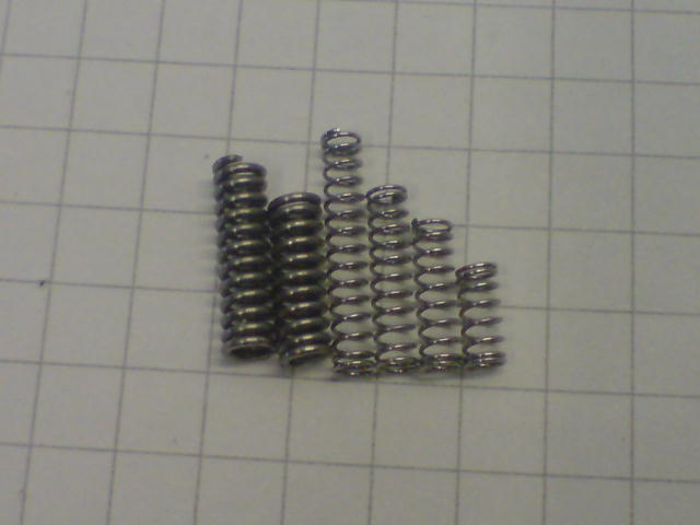

the surplus coils were then cut off and the coil ends were squared by putting the spring in a cordless drill and using that against an abrasive belt. and here's my first attempts as spring making shown against 5mm squared paper for scale.
