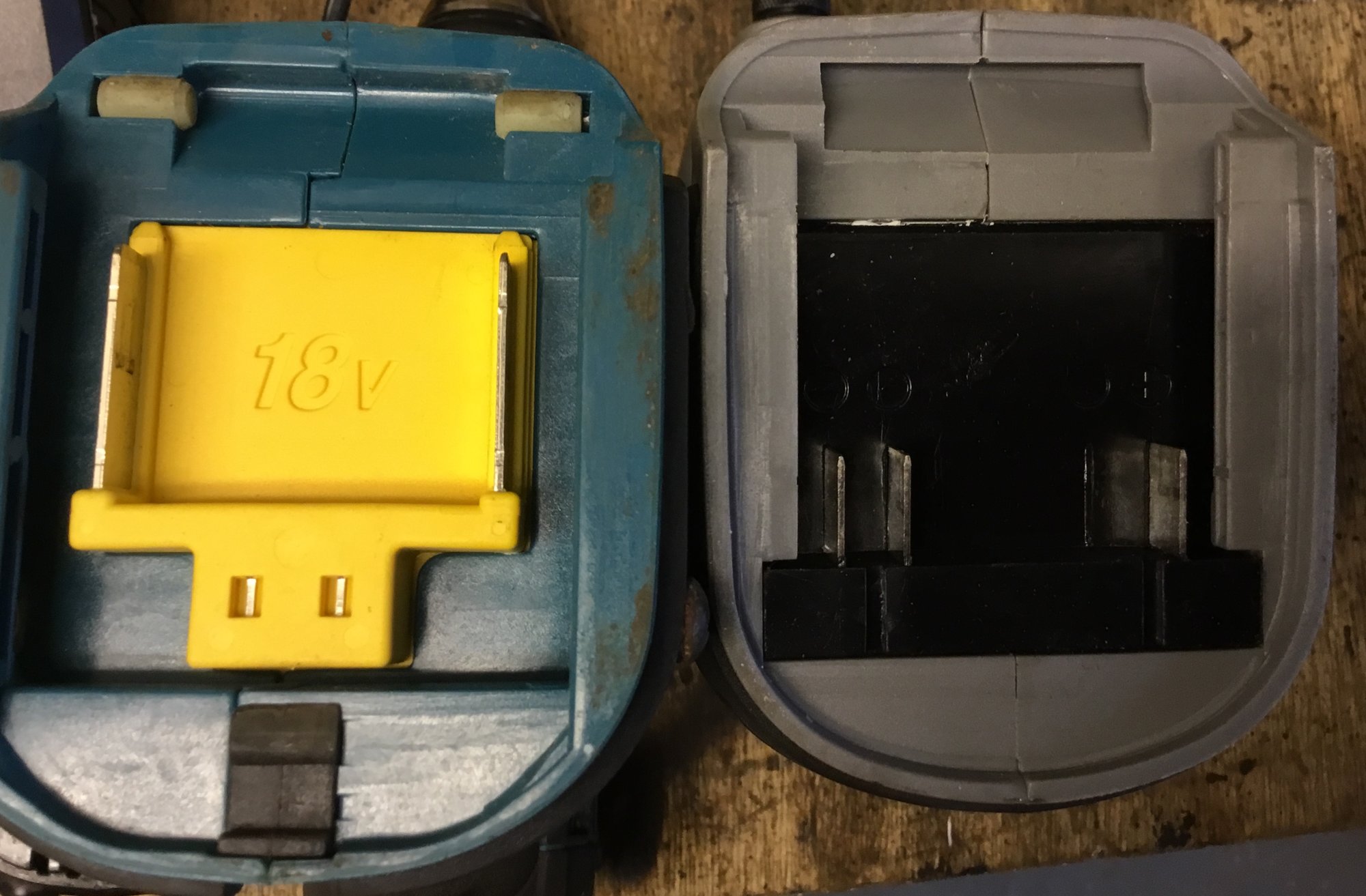

These all came with Nicads originally. There is some interchangeability between batteries though the hedge trimmer the + & - are reversed. The grinder batteries fit the hedge trimmer but the wrong way round and with the aid of some tape! Some batteries fit and work but the holding clips are in the wrong place. Tbh I'd use them more if they had good batteries that lasted and the charge times weren't "3-5 hours" and you didn't need multiple chargers. (OK, the grinder is 1 hour). So here's the plan:
I had considered 3D printing adapters but I'd need to do the CAD etc. Found these Makita battery Stealth Mounts moulded from tough ABS at £15 for 4. Aim is to graft these onto the top of the various tool batteries, the section that slots in or to the tool base itself. Then a couple of down pointing "tags" to line up with the Makita batteries + & -:
These are injection moulded rather than 3D printed btw.

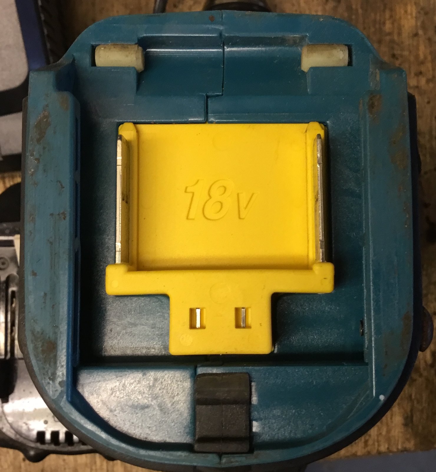

Stripping the grinder and it's battery down last night:
The battery lid:
Inserted into the grinder:
The stealth mount held against the battery lid:
Tbh a rectangle of plastic (or timber?) a few mm thick screwed to the grinder base then the Stealth Mount on that should work. The grinder body plastic is really tough and would pass the "drop test"
