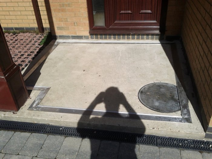

The porch at the front of the house has been in need of finishing off, for a longtime, HID is constantly on my back about it. So the other day I found a company to lay a resin bead finish. Only problem is they wanted 450quid to cover 4sq mtr. managed to knock them down to 240. if I fitted the border.

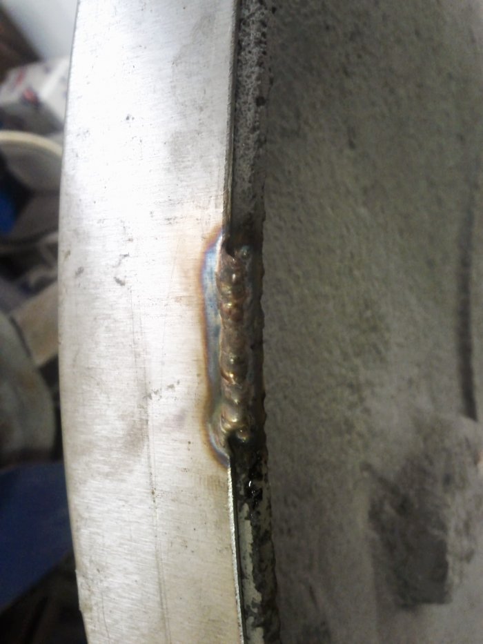

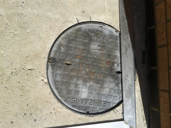

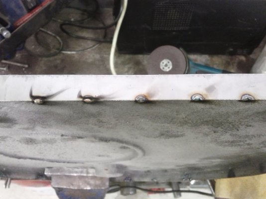

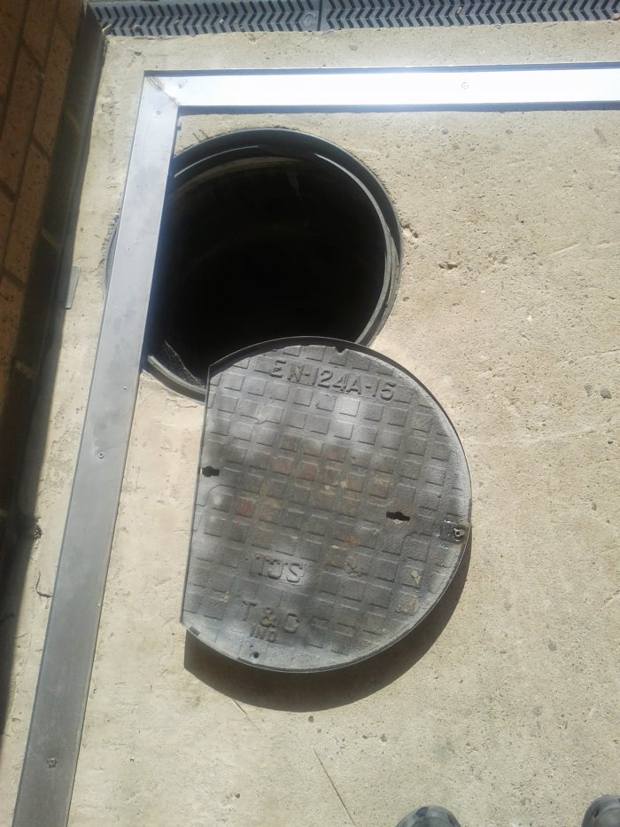

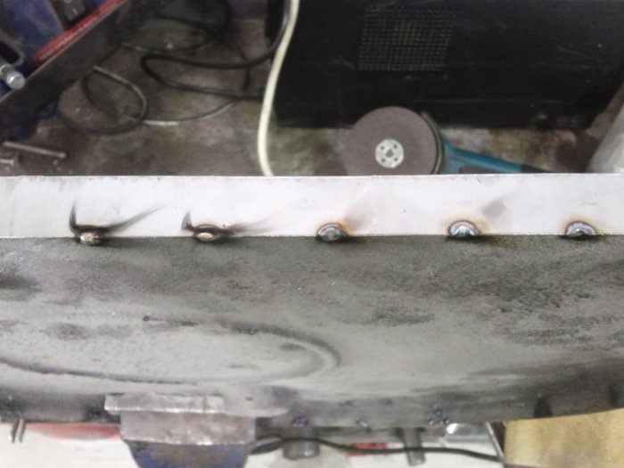

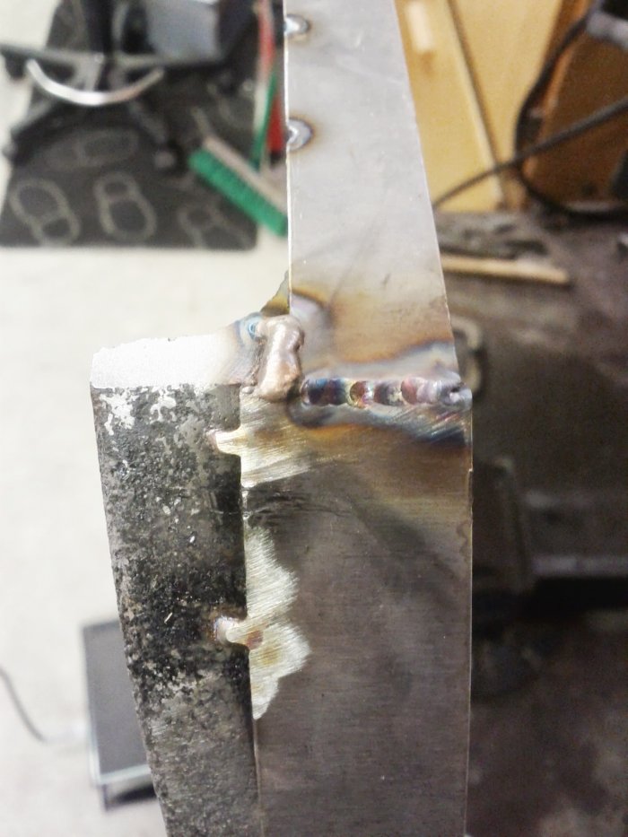

I had an ex firm fold up some 0.9mm SS into channel 75mm wide with 7mm legs. I mitred the corners and tacked them up, and plugged and screwed to the concrete base. The only problem been there is a 450mm dia inspection cover bisecting the border. So I cut the lid so I didn't have to mess with the border and brazed a strip of 0.9mm SS to the sides.
The lid was painted in pitch so I thought I'd shotblast it off. Only I had forgotten I'd cut the 1" bore pipe going into the main w/shop. Turning on the compressor in the other w/shop, where the blast cabinet is, I was unaware of the total devastation the flailing hose was doing the the main workshop joined to the house. To say I was in the dog house was an understatement. Not that it did anything to her stuff Besides I was working on the house, sometimes you can never win.
So with the lid cut and the Stainless strip marked and brazed on it fits a treat, just waiting for the Resin now
