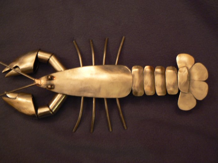

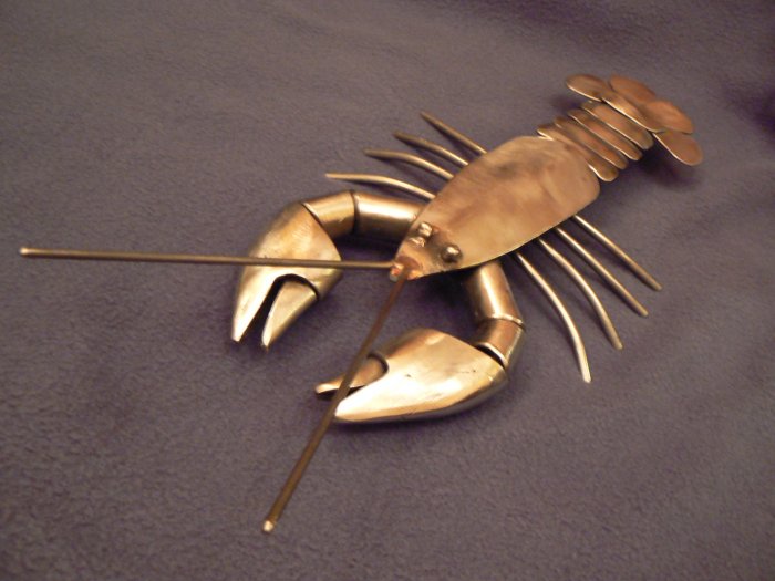

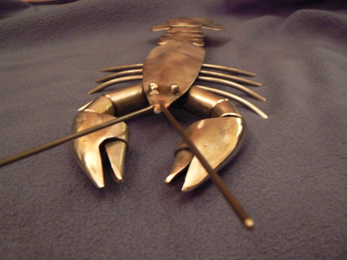

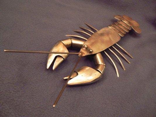

Hi Folks,
Just finished her off this evening.....
She is just over a foot long claw to tail and all steel, mostly MIGed together but the eyes and tentacles are TIG brazed. I had a bit of fun with the eyes. I decided to use ball bearings so drilled some small holes to locate them - I thought I would be able to heat the balls up and then just drop some braze (SIFbronze No 8) over them but the balls melted and ran through the holes. Of course, once that had happened the part filled holes were too hard to drill so I had to flat some balls off and have another go, playing most of the heat on the plate. I should have had a practice!
Graham.
