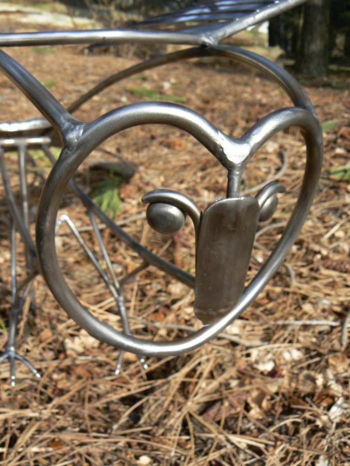

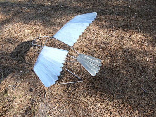

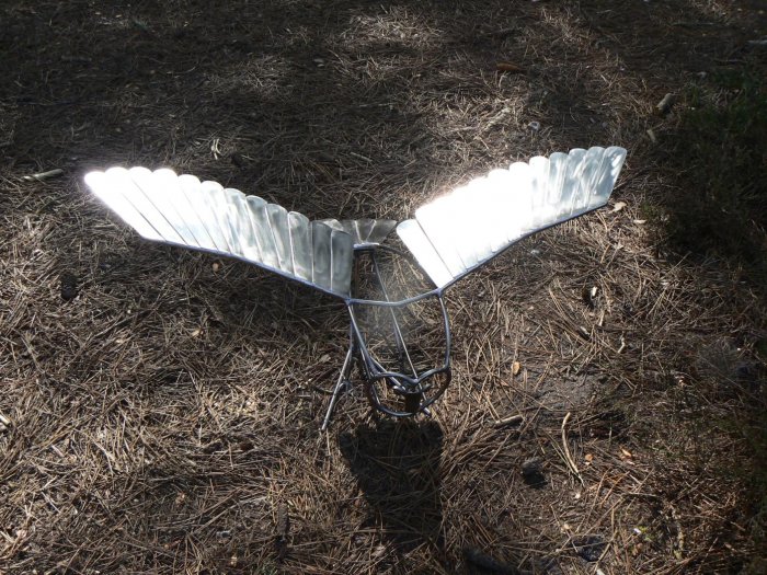

What do you reckon to this one then folks? A friend of mine thinks I should try and fill in the body some more to give it more volume - maybe some more wires or some plating? I have decided to leave it for this one and maybe try and think of something slightly different for next time - any suggestions would be much appreciated?
He is made of stainless (mix of 304 and 316); joined using TIG; feathers cut with the plasma; rods bent using home made jigs and bending around bits of brass bar in the vice; eyes and claws done on the lathe (mostly with a file).
You will see I struggled a bit getting nice smooth welds around the feet - next time I'm going to be sure to fill in-between the toes before welding to the legs - I think I may have contaminated the deep recesses by quenching in my quench bucket of festering old water between stages?
