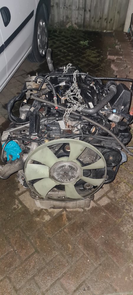

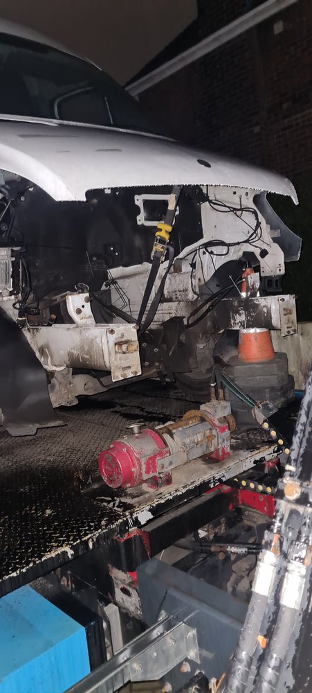

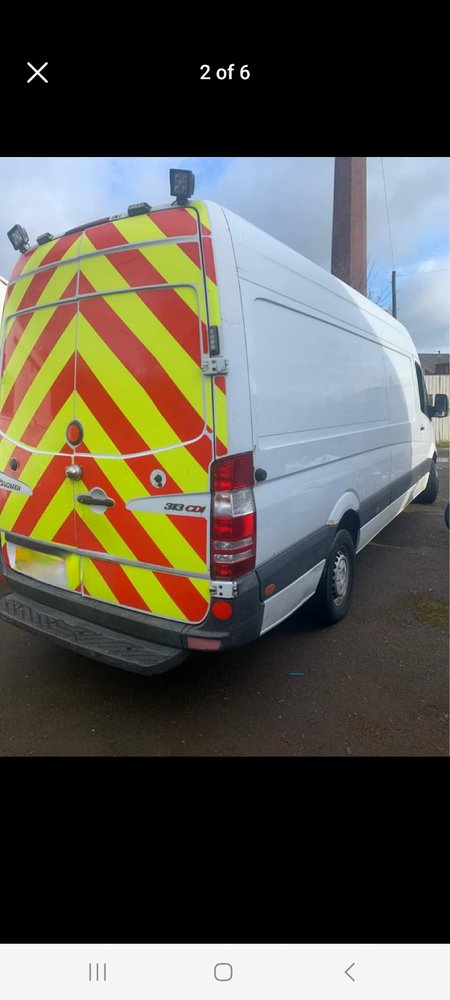

that om606 can be made to make a lot of power with a hybrid and raised fuel pressureI've acquired a sprinter with a broken engineView attachment 395649 And I want to either repair the existing OM651 which has over heated , due to a chaffed egr cooler hose.
Or maybe put different engine in like the Om606.

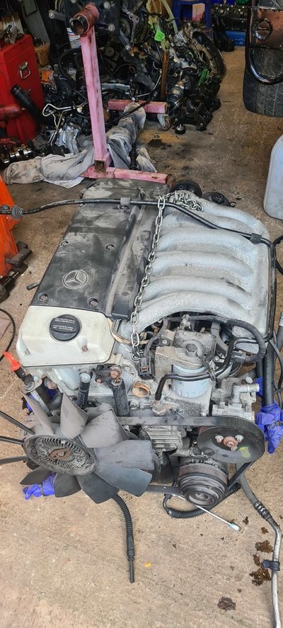

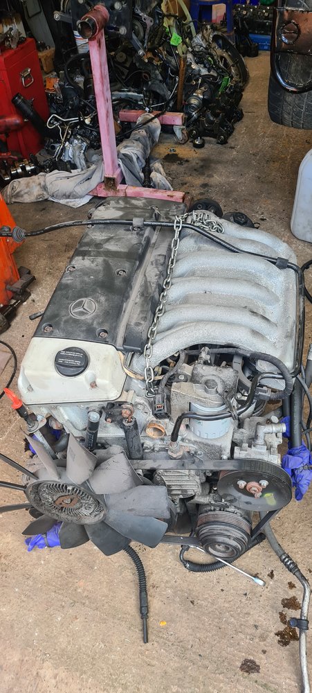

I just want a decent tow vehicle, nothing too mental, A bit mental is ok thoughThere’s a 606 defender round my way it’s quick for a lifted motor on 37” wheels.
606 itI just want a decent tow vehicle, nothing too mental, A bit mental is ok though
I'm leaning towards it tbh.606 it
Will be great on hills
I watch this lad..knows his stuff on the 606I just want a decent tow vehicle, nothing too mental, A bit mental is ok though

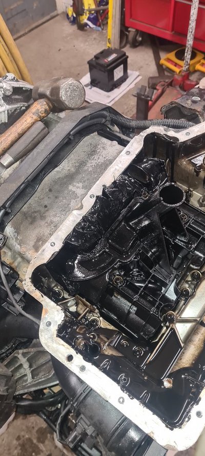

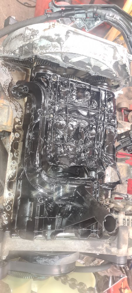

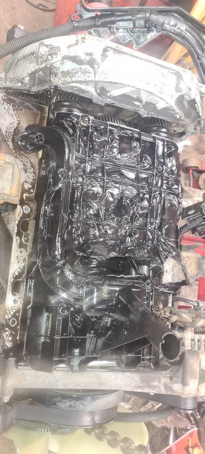

It's only done 127,000 miles ,they definitely drove it like they stole it!!You've got to love a civils driver.

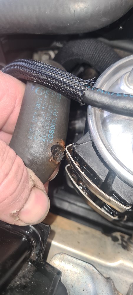

That big red flashing warning on the dash about low coolant, followed by another one about overheating obviously mean nothing, as it still drives
Mind you, it's not been helped by whatever idiot has had that hose off and not put it back on at the right angle, as there should be a good bit clearance between it and the fuel filter clips.
Once done it should still drive like a new van with them milesIt's only done 127,000 miles ,they definitely drove it like they stole it!!
