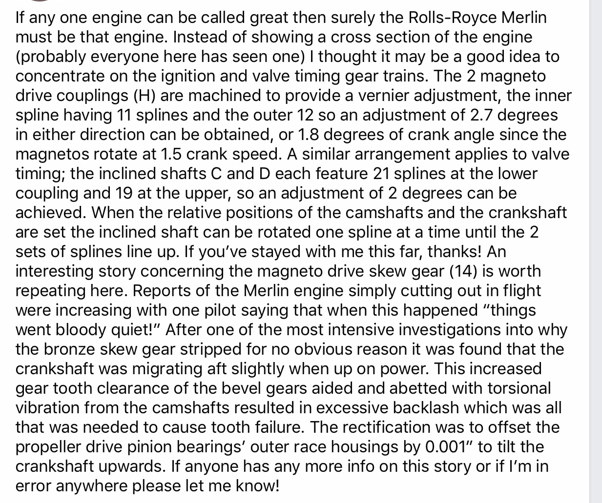

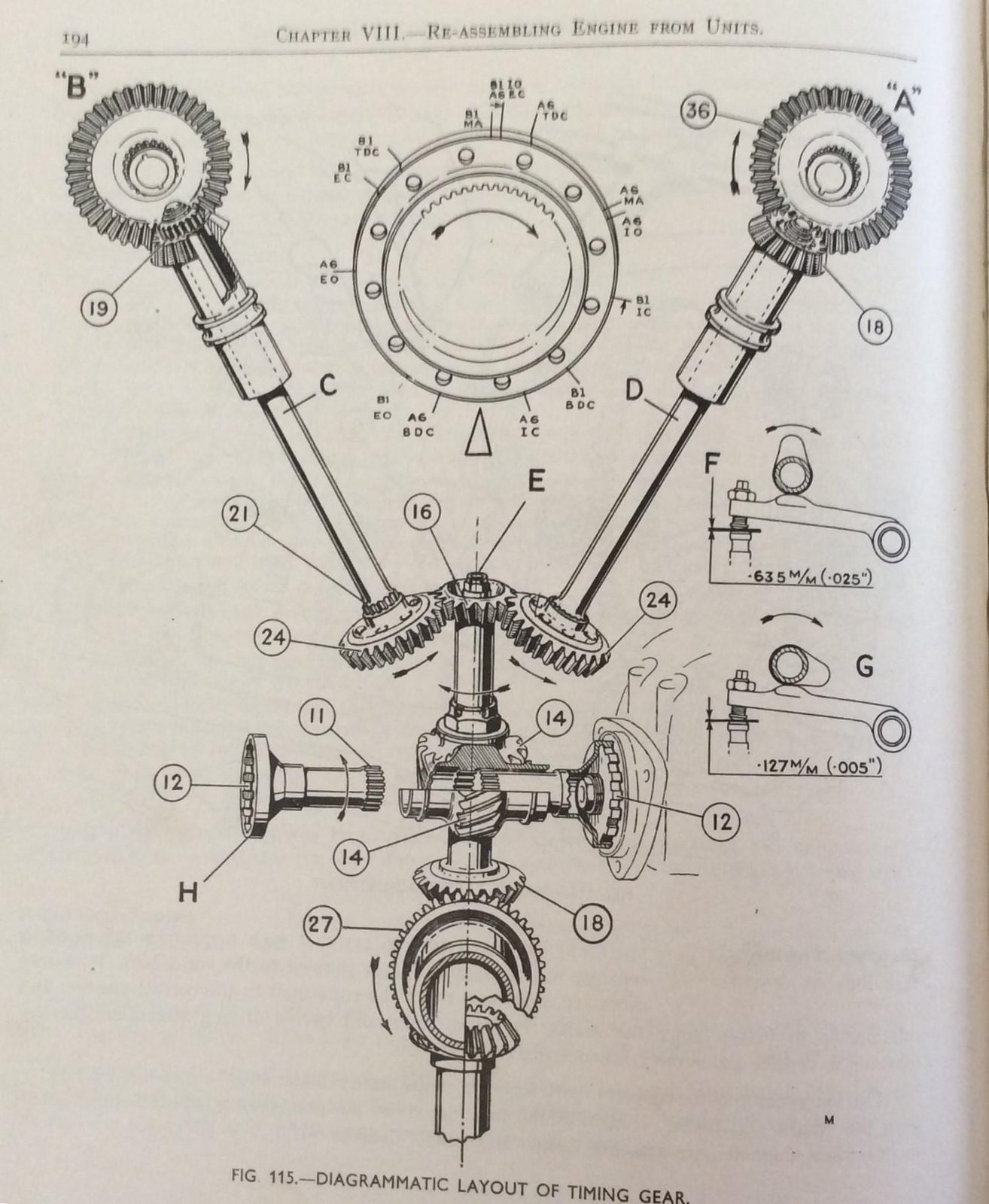

Cam and magneto drives. Lovely and easy to set valve timing with the micrometer adjustment on the drive shafts. Mags will give you a good belt if you’re not careful engaging them on their drive splines and they rock over

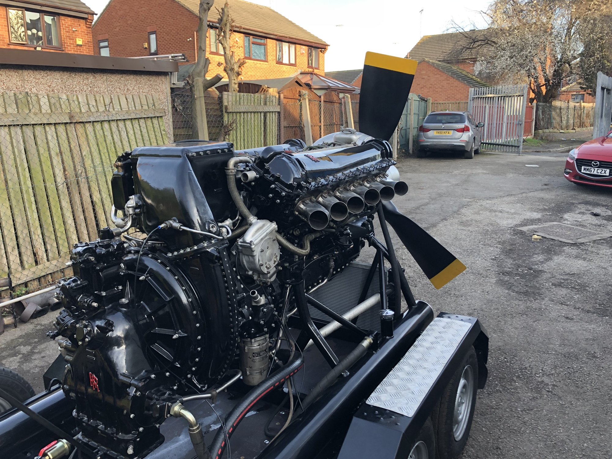

Was it a merlin or a meteor. Lots of meteors gone in cars. Share the same blocks, heads and Conrods as a merlinThere was one of these crated up in the corner of a garage I used to work at, the buildings owner was going to stick it in a jag.
