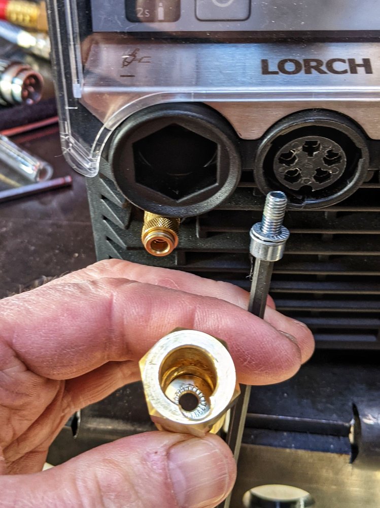

Love my MicorTIG to bits, as I'm sure I've said on a few occasions... all fine and dandy using the Lorch TIG torch I have as the gas supply is taken care of further down the torch umbilical - that torch is a 17 series torch.

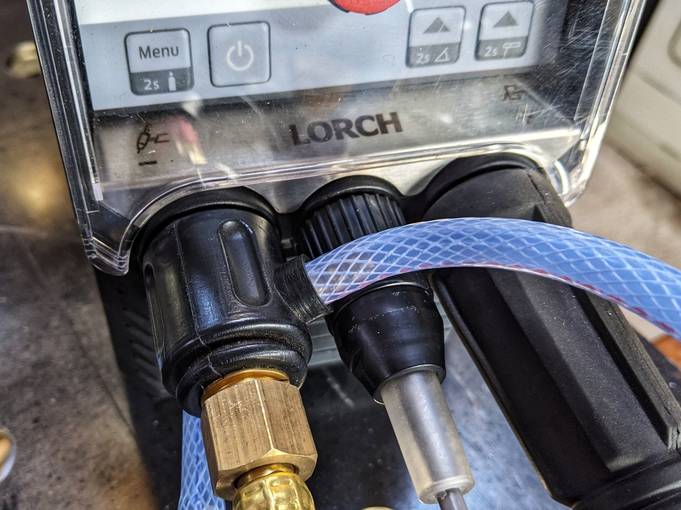

I've got a Parweld 26 series torch so if I want to use that I could use a generic DINSE gas adapter BUT the issue is that the gas hose inlet to the adapter is fouled by the plug adjacent to it; I can only turn it a few degrees so the connection is far from ideal. I definitely sense that the HF ignition is far weaker. The adapter fouling the switch is down to the angle of the wee 'key' on the DINSE adapter and from what I can see most are the same position.
Can anyone suggest something that would work properly?
Only alternative I can see is the CK Safe-LOC but they're circa £40 plus VAT and delivery and I don't know whether it would work as although the gas port isn't at right angles to the adapter, there is a pronounced 'bump' on the side of them...
