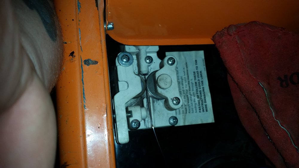

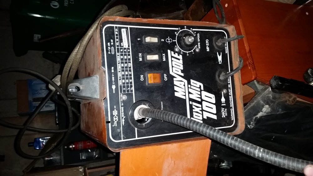

The mig welder ive got is a maypole maximig 100. The parts are obselete and cant be found anywhere.and the trigger connection is coroded. So because i cant get replacement parts i want to replace the torch. But want to just change the handle side of things and the inners.not the full lead
tracing the wires is fairly easy when you have the covers off, there isn't fat for them.to go. Work methodically and only disconnect one wire at a time. I did a euro conversion on my gasless mig and it only took a few mins to swap the wires over
