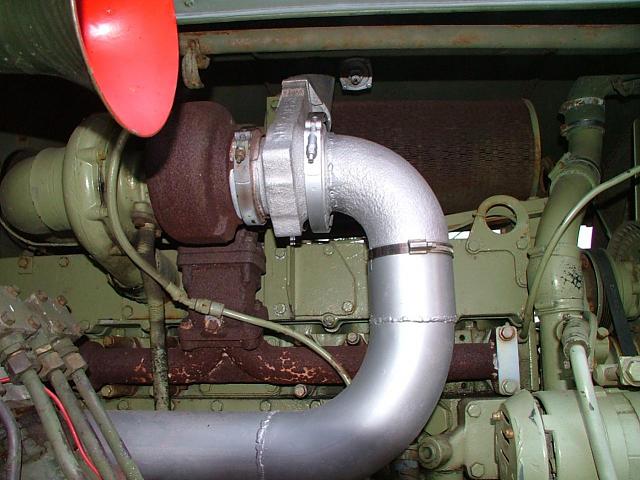

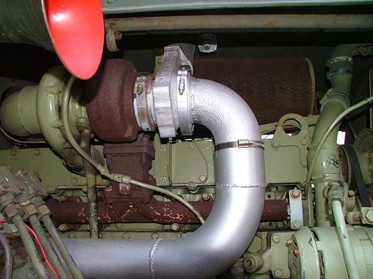

Hi folks, just registered after lurking and learning for a few months.
I have successfully (it seems) MIG welded a couple of cast turbo outlet bends for Diesel engine transplants I have done, I vee'd both edges, tacked together, then preheated in my Rayburn range fire, welded whilst almost cherry and returned to the fire for a bit and then cooled in the oven 250 deg F.
These where done a while ago now but it still worries me somewhat, have any of you guys done a similar thing and has it lasted?
