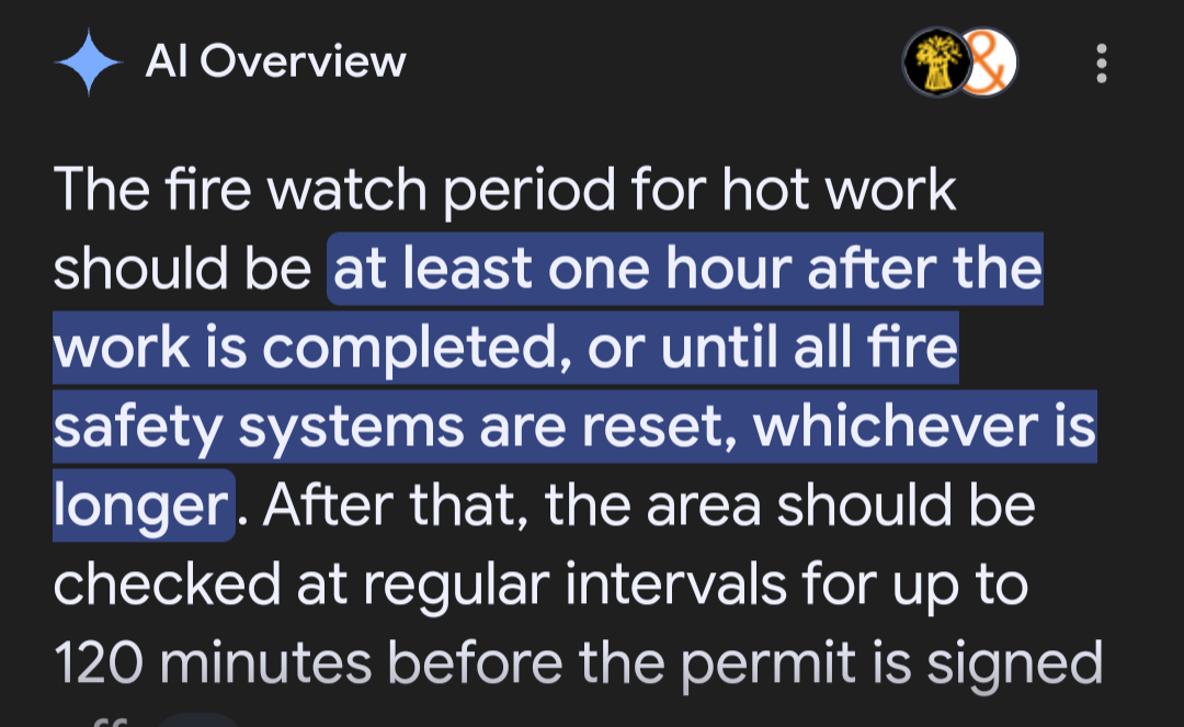

Keep an eye out for anything smouldering afterwards, and keep a bucket of water or an extinguisher handy.
just make sure theres not much dust or any cloth and flammable stuff near by that sparks can get to and smolder as above fire extinguisher or a bucket of water when finished look round after 20 mins just in case
