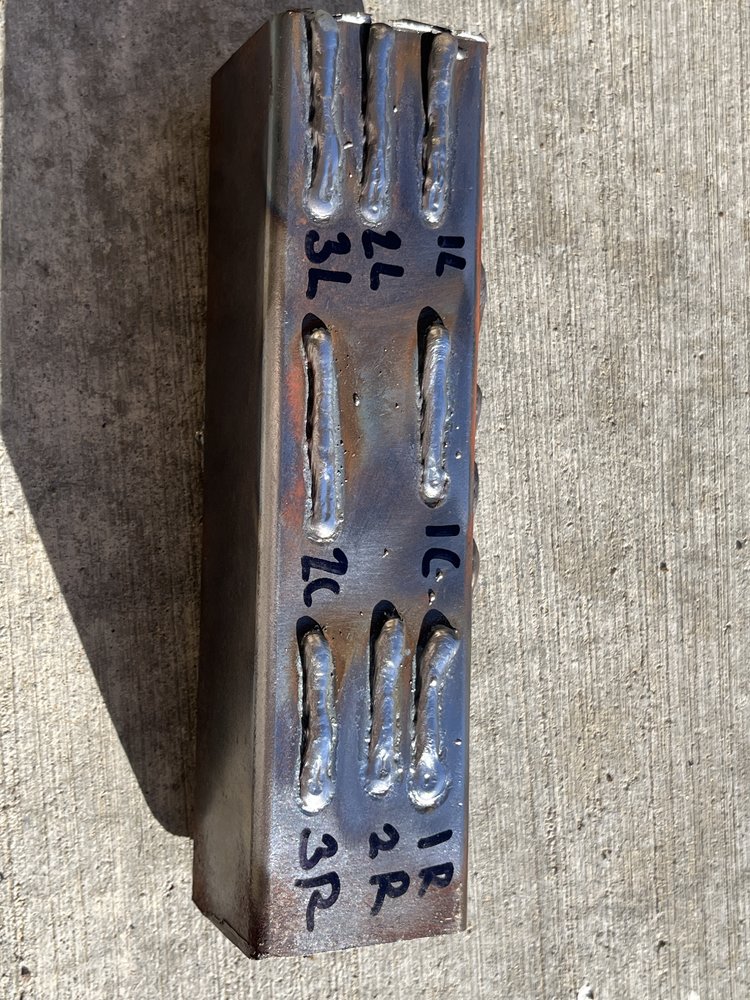

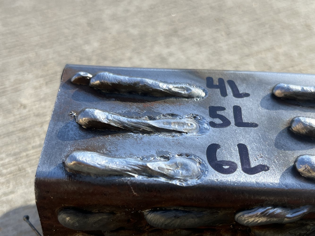

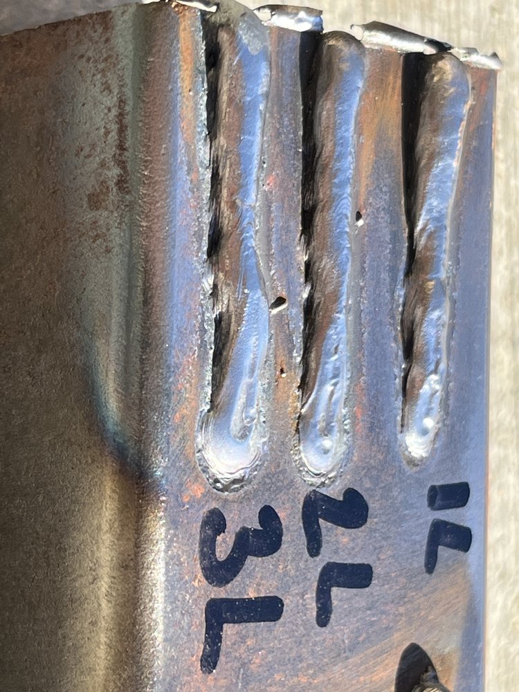

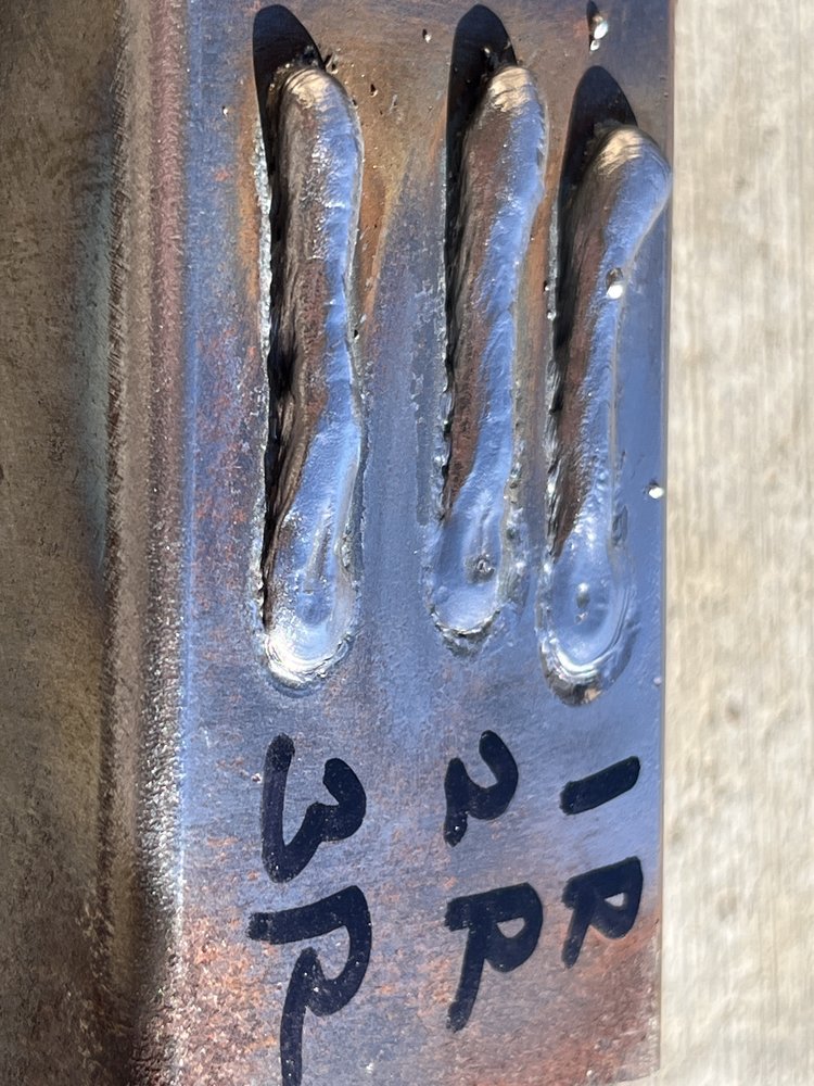

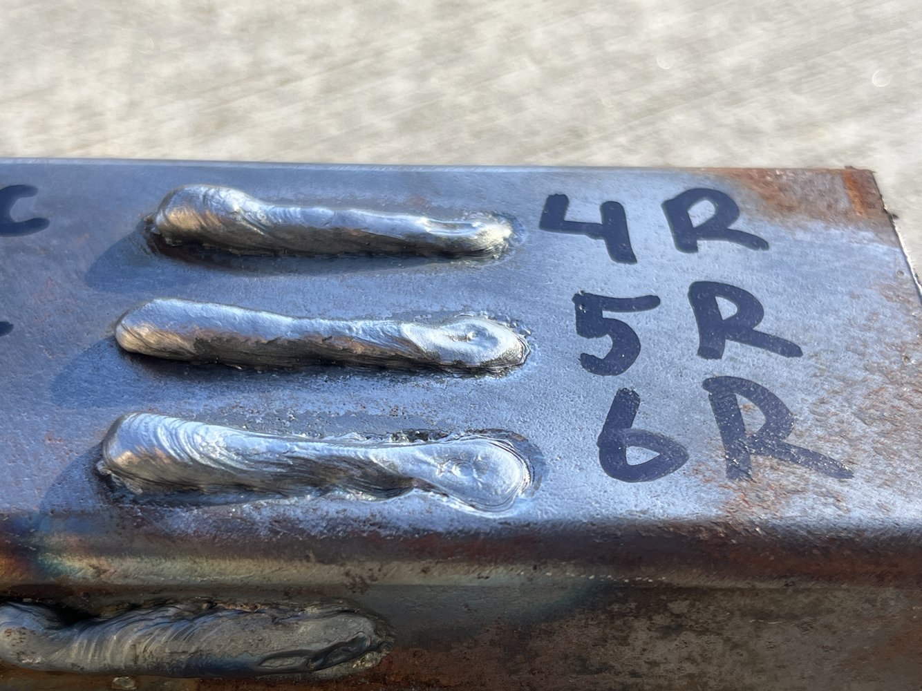

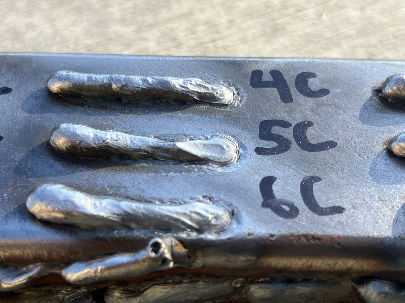

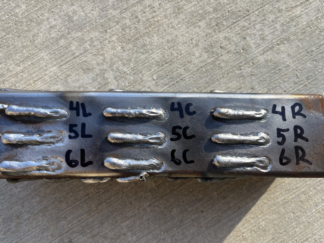

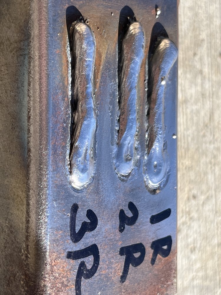

First time here and using the Miller 215 MIG process. The auto settings seem very hot. Cant get the bead to lay down, and cant stop the side undercutting and crater at the end. Welding 1/8" material with 75/25 gas @ 20#, and .030 wire. Ive tried to reduce the voltage, increase wire speed, decrease the material thickness on the auto setting. All with no good results. Im a good welder (not novice, not pro), but this new machine has me beat.
