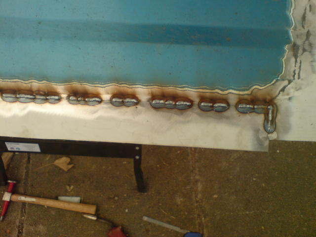

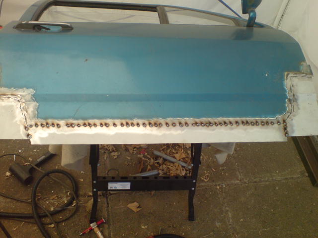

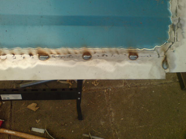

here's my way of doing this, on a doorskin and welding in a new bottom edge from 0.9mm zintec. When Mig welding thin sections I prefer not to have a gap between the sections and to get them touching if possible. I'll start off by welding a few tacks along the length. the tacks will shrink when cooling so the gap may need to be adjusted with some hammer and dolly work.

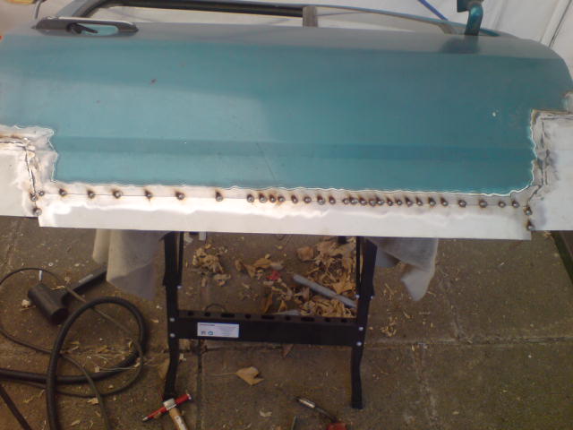

and do a few more tacks, the panel alignment can still be adjusted at this stage.

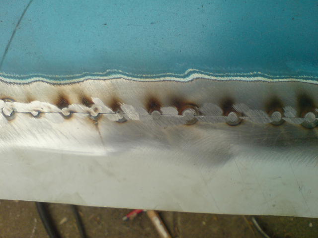

when you think you have enough tack, grind most of the tack, but leave enough so you can see where they are, this also shows how close the gap is.

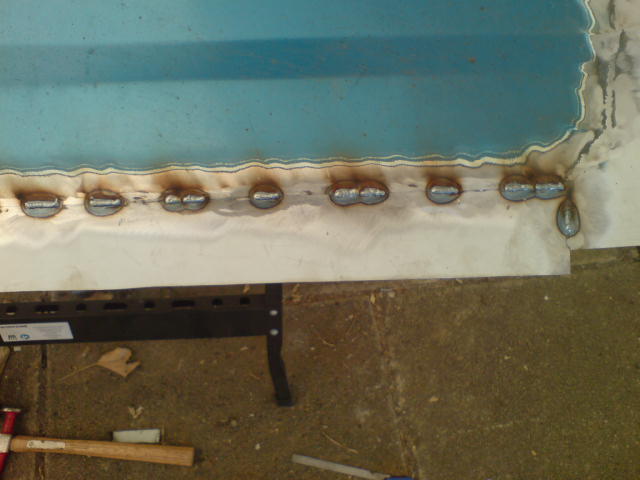

then start to to join the tacks with ovelaping tacks to reduce the heat input, and leave a few inches between the tacks.
then go back and do a few more, this will reduce the heat input to reduce the distortion
and the same again
and again

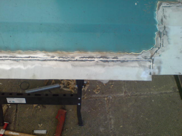

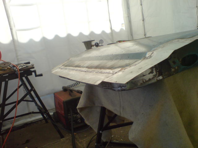

and when youve completed it you can grind the welds back

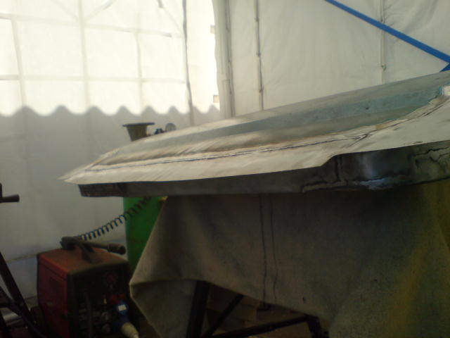

and the end result, I dont think its too bad, and could be improved with a bit of dolly work.
