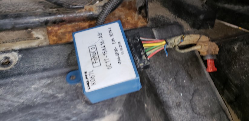

I had a really corroded trailer light control unit, in the front footwell, which I replaced.

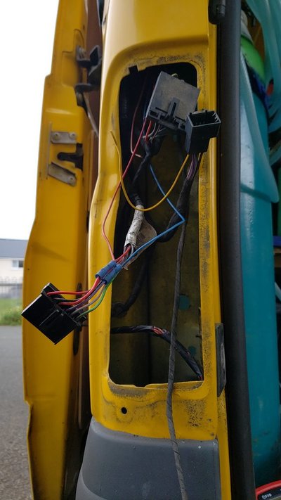

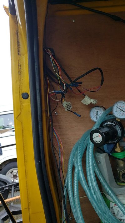

The wiring in the rear pillars is incomprehensible, due to removed light bars, beacons etc, which was done before me, by someone with a similar level of electrical knowledge as me, it would appear, otherwise I would have just swapped in a cheap 7 pin connector from the light cluster.
