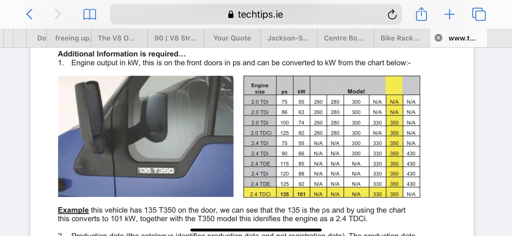

Which engine?
Seized or damaged turbo...Not sure of the turbo type you have but it could of jammed the variables on the turbo with sootIt reveals cleanly just very slow when I’m in tomorrow I will take some pics and videos tomorrow
If it's RWD, I would expect it to be a 2.4
