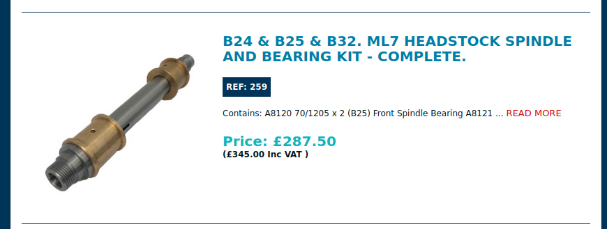

This was a white metal cast onto a good copper base on the shells.Babbitt is cast with all parts in situ, is it not? Why all the machining to replace like with like, bearing wise?
In what respect?It's your fifth line that is on interest, Can you give some details?
How you did it. Bearing in mind that the ML7 doesn't have shells. (from what I remember)In what respect?
the bearings are split bronze and white metal facesHow you did it. Bearing in mind that the ML7 doesn't have shells. (from what I remember)
Cus on the phone this morning I missed the important bitHow you did it. Bearing in mind that the ML7 doesn't have shells. (from what I remember)
Ahhh....'Mangetout' as Dell would say.....Cus on the phone this morning I missed the important bit
ML7 lathe bit
ML7 is a engine used on RN ships as a back up power plant.
