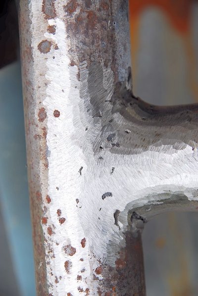

Need advice please . Last time I arc welded was about 30 years ago using an oil cooled welder , was hopeless then and still am   .  Using a Lincoln 140 amp invertor which gives a very smooth arc ,  easy to strike and keep going much easier to use than a buzzbox or oil cooled welder   . The poles are being welded at right angles with one being ground out to be a good fit against the cross peice . The poles were originally galvanised but heavily corroded , used a grinder to take both peices down to clean mild steel  and a welders clamp to get an accurate 90 degree angle.  Using 2.5mm MWA  E6013 sticks , tried currents between 65 and 90 amps and so far used 10 sticks for one joint which if I think should have used maybe 2  or 3 sticks at the most and its still not finished after three hours work so I will never make it as a welder but somehow I need to finish this job as its for someones birthday this friday and it still needs painting  . First problem is unable to see a thing through the cheap Halfords mask  and difficult to even keep the run on course on the joint but will try a Murex glass shade tommorow , may as well just close my eyes with the mask I am using today  .  I think I should be using bigger rods and a higher current maybe 4mm and 120 amps  ?  The joint is butted with no groove , is this a bad idea and would it help if I grind a channel in it ?   Have read the posts on welding pipes  but seems to be mainly about using TIG rather than MMA and for welders who already have a high skill level .
) in the position shown in the foto. Turn your amps up to at least 95 (drag the tip of the electrode along the metal, you want as short an arc length as pos.), weld across the top and down to the middle of one side, start again from the top and weld across and down to the middle of the other side, then flip the whole thing over and do the same again (make sure you clean the slag out from the ends of the welds or you'll get a hole). It's easier to keep the rod pointed at the correct angle and burried right in the join if you hold the electrode with your non welding hand, but make sure you wear thick gloves. Nothing wrong with using 3.25 electrodes, although if you do it downhand you'll have to go really, really fast or the slag will overtake the weld bead.
