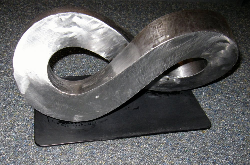

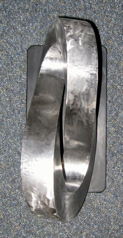

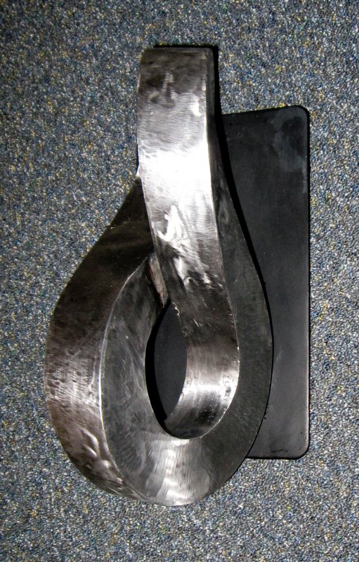

Well done there.
I have tried and failed at this one and know a few other folk who have tried and given up.
The problem seems to be chasing the twist along the oworkpiece and ending up losing it.
Damned fine in fact.
Thanks very much. I cheated by using thin sheet. Two long strips to make the top/bottom and bottom/top figure of 8s then just spaced them out with little spacers. Spokes if you like. Sides simply plated over. Hardest bit was working in the crossover area. All hand filed here as no room for the grinder. May have a bigger attempt when my plasma arrives!!!
Very nice work. Just to be pedantic though, surely a true mobius strip has only one side, every if it's three dimensional? Not that that has anything to do with your sculpture, it's just curiosity!
The pedants win!
It is not a mobius strip it is an infinity symbol.
There are two surfaces in the horizontal plane.
You might as well send it to me.
Still a nice piece of work though.
