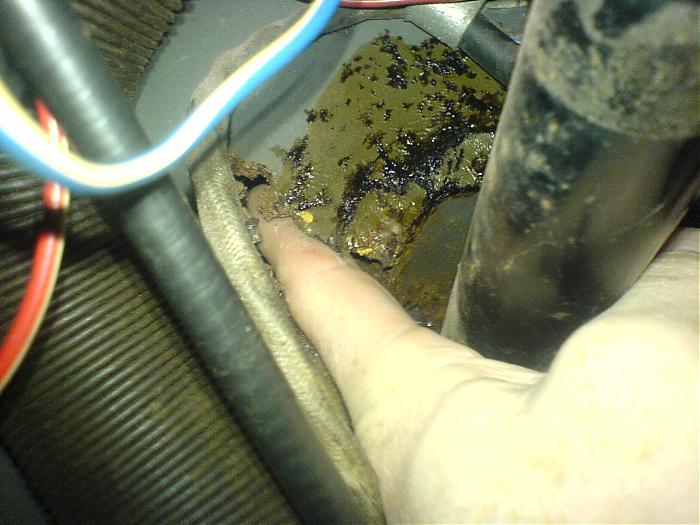

Why do cars always rust in THE most impossible places?
I just found more rust on my MG. The photo shows my steering column viewed from under the dash, as it passes through the bulkhead. Unfortunately it also shows my finger passing through the same bulkhead
I suppose if I cut the car clean in two then I could just about get in there to fix it....
A slightly more realistic although crap solution is to remove the dash (needs refurbishing anyway) remove all the wiring (needs a new loom anyway) and then remove the heater assembly in the engine compartment (it was blowing a little cool) then remove the master cylinder (brakes were a little spongy), remove the steering column (could do with a paint) then I should be all clear to weld in a repair.
That *IS* a tough spot. My question is this: how important is that area if left unattended anyways? The only person it'll bug the crap out of is you. It sounds like way too much work to get at unless you're stripping the car to the shell anyways.
That`s the kind of job I`m hoping my new Plasma Cutter will help with. Dremmels can sometimes be useful for that although cutting attachments are extortionate. Air body saw? The little air type angle grinder with a thin blade? Funnily enough I have a 3hp compressor and it wont push that angle grinder thing properly.

Danger, I'm going to leave it until I finish the other jobs I have already lined up. It will bug bug the hell out of me as you say, so I guess I'll have to fix it.
LippyP, Nope it's not wet, it's stains on the paint. I tracked down the cause of my woes. The brake fluid reservoir had dumped it's contents into the cavity above the steering column and ate its way through.
