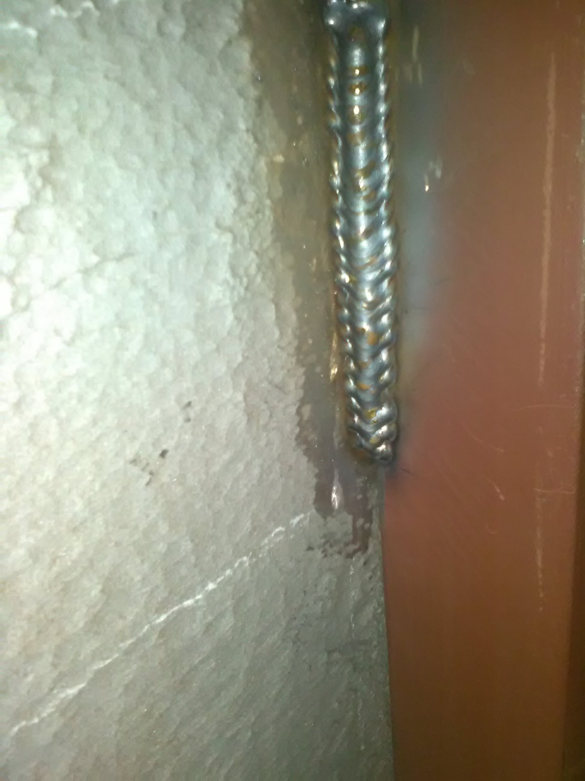

a bit more practise vertical up what do you think
be gentle lol
Good morning Ewan1984.a bit more practise vertical up what do you think
be gentle lol

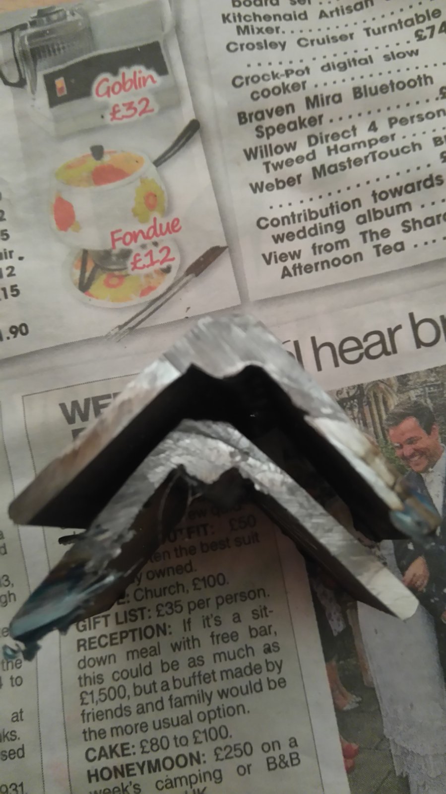

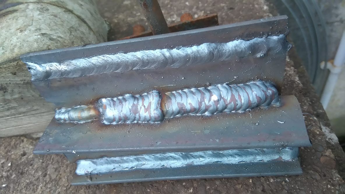

Thanks for reply Henry I tried it once on a Course and then tried a couple times at home this was the last attempt from an hours practice do I need to weave on the root
As said I don't mig anything other than Aluminium so the technique may be totally different but vertical up I would be doing a kind of up/down motion but not side to side for the initial pass. Aluminium is done in spray transfer mode so possibly not comparable.

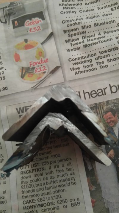

I had another little go not much time did a root pass and cut in half what do you think of the results I did manage one decent looking weld on a thicker piece of steel bit think it was just lucky
What do you use for etching solution will have another go at somepoint and try and get a better photo
