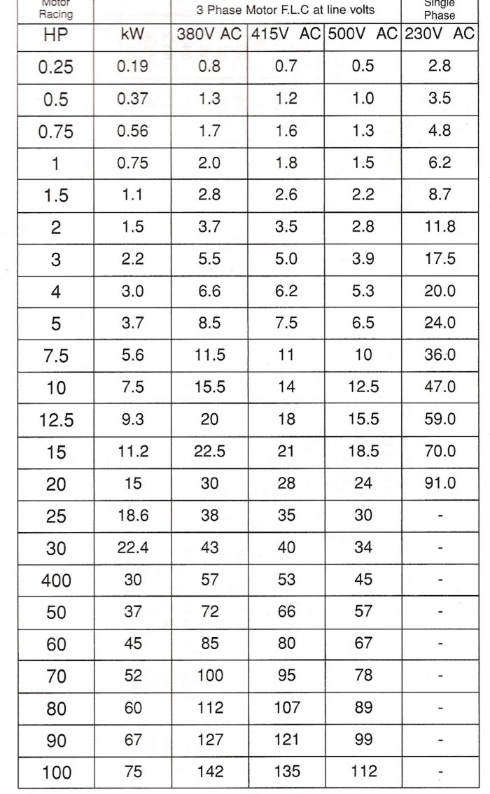

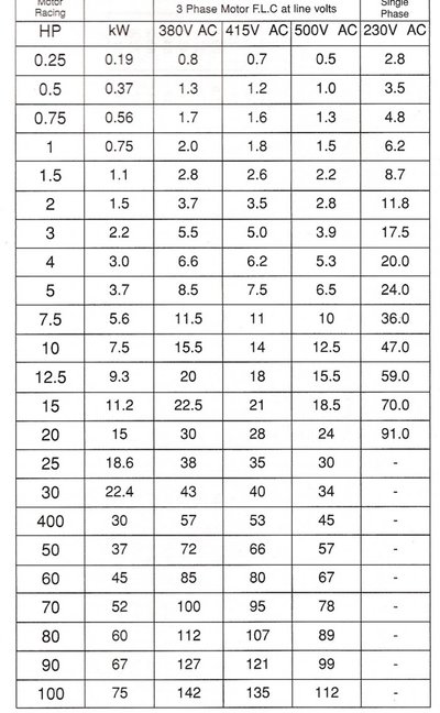

Afterimage Member Messages 233 Location England Dec 28, 2009 #2 So it appears that my cheapy Wolf 2HP 2.2KW compressor is in actual fact a super-duper 3HP model?
shenion Tool Pack Rat Messages 7,586 Location Stone Mountain, GA USA Dec 28, 2009 #3 And shows my 5HP cant be real as it is a on 20A/220V breaker
