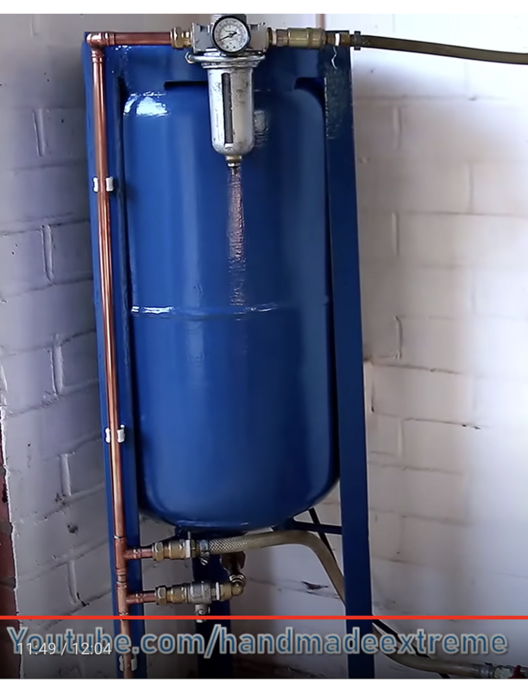

* A DIY air dryer - It seems decent as it removes a nice bit of water. I never noticed any moisture related issues when I painted my car with VOC paint. I would be happy to build another one with improvements on my first build. (I have since removed the quick connects on this for airflow reasons).

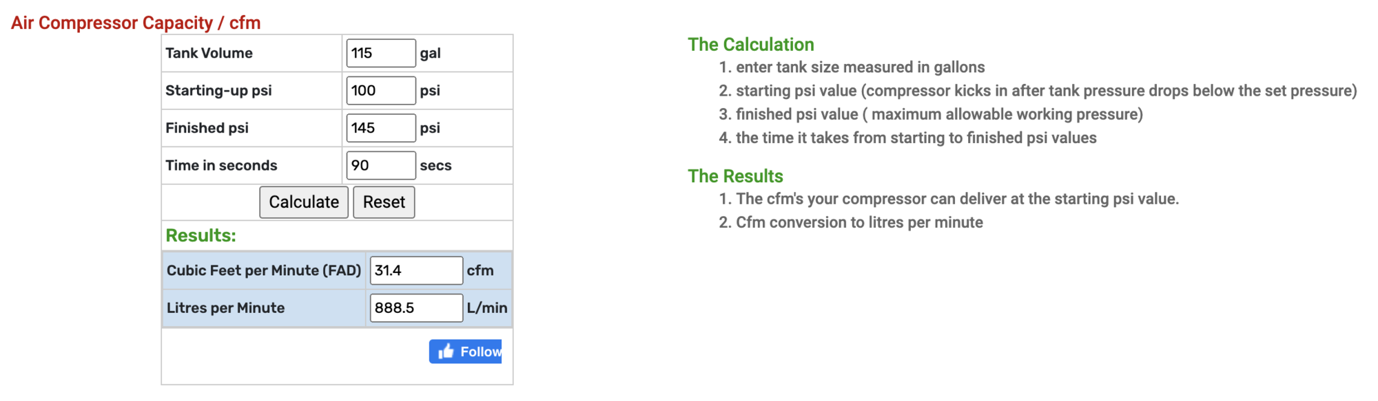

I don't know how flow is calculated? And where FAD vs pump displacement comes into it. But the pump displacements of the two compressors above is 14 + 13.8 = 27.8 CFM.
Where does FAD come into it? Would the above numbers work for blasting?

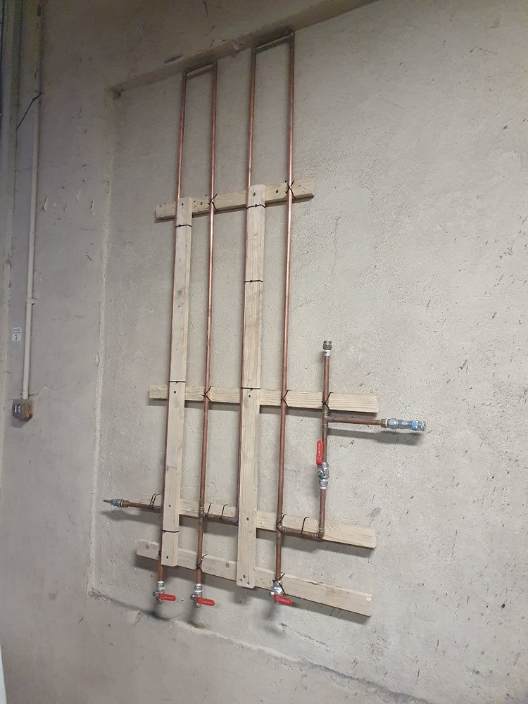

* From research online, I would plan on plumbing the two propane tanks to the compressors. The idea would be to run the compressors with open and regulate after the receiver tanks.
* I would also add in the air dryer, and possibly another into the mix somewhere.
