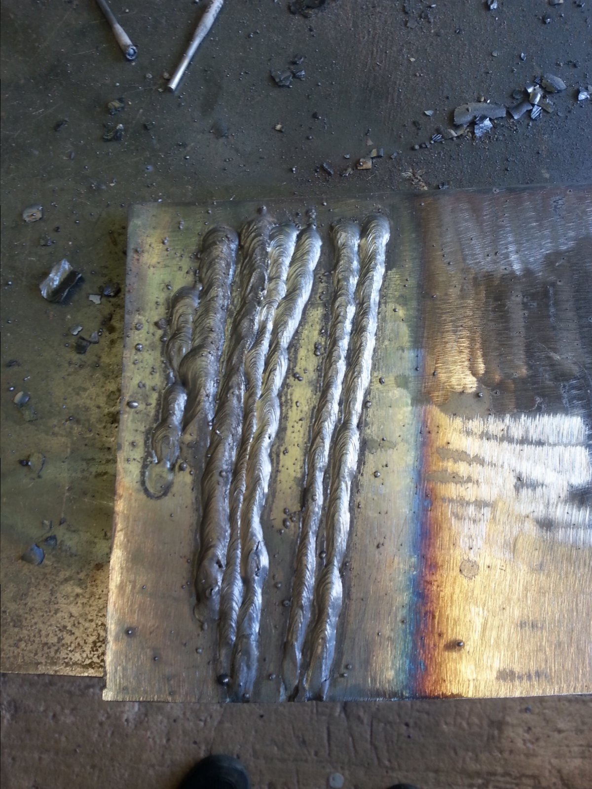

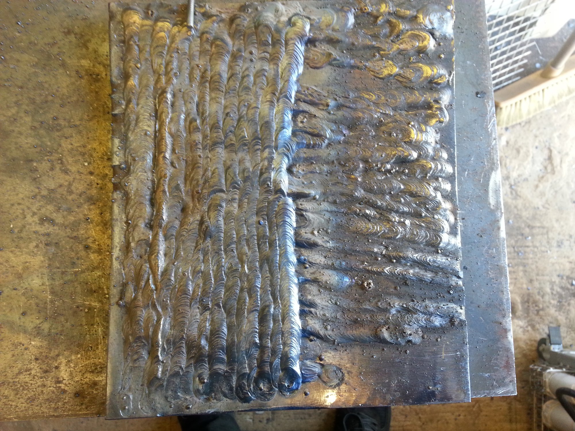

I think I tend to do things the non-standard way, I got a GYS TIG200 HF last November and have been learning to Tig weld since then having never welded before. I have silver soldered (brazed) before using propane, but never attempted any welding before.
Since then I have managed to "stick" a few bits of rust together using TIG, and I really like that process. Having finished building a welding trolly/cart (see the "Show us your welding cart/trolley" thread) I stared to tidy some welding accessories into the drawers. I came across the "Stinger" that came with the welder.
So I dug a piece of 6mm steel out and gave it the once over with a flap disc (not sure if that was strictly needed, it's just the TIG advice to have everything as clean as poss') Then I stuck a 3.2mm 6013 rod in, and after looking at the label on the box (the box of 6013's) I set the current to 120A, left the polarity on DC - (not sure if this was right, but the label said DC- so I gave it a try) and here is the result.
My very first stick welds (and yes, I did stick a lot on each start). My 1st run is the left-most bead, and then they follow from left to right.
I couldn't believe how fast the weld formed, the 1st few I think I was moving way too slow. The last 2 runs I lowered the current to 115A.

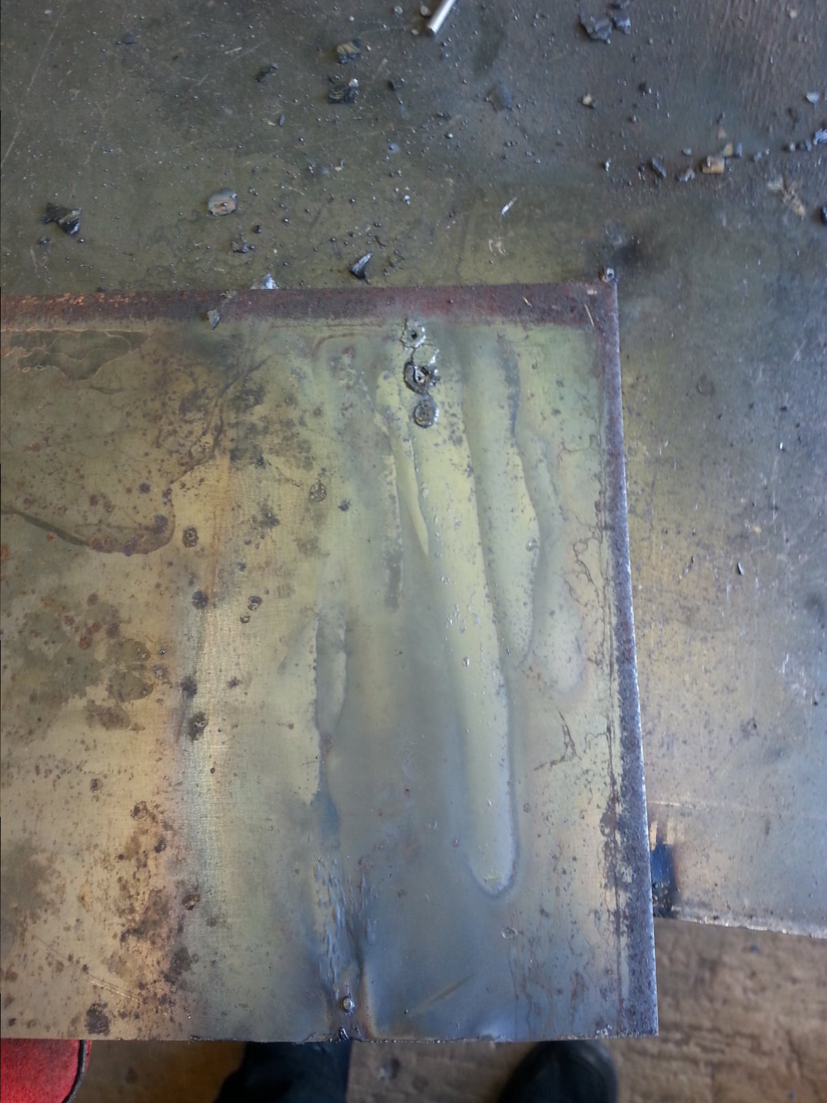

Here's the backside
You can see where I "pushed" a little too hard and slightly welded it to the bench!!
Now I get how slow in comparison TIG is, but it is a lot cleaner.
