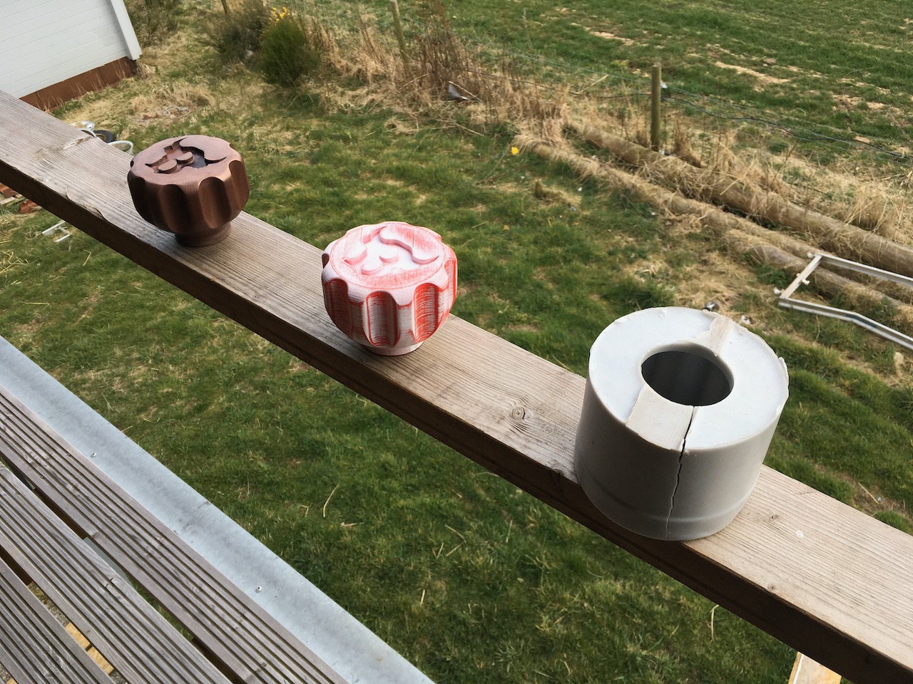

I am restoring a bacon slicer for the local butcher who will be paying me in bacon and/or steak
Asides from the main issue of the securing bolt for the blade being quite broken after he tried to remove it with a meat cleaver (he's a better butcher than a mechanic) another issue is the thickness adjustment was lost many decades ago so they were just grabbing the end of the mechanism (did i mention he is a better butcher than a mechanic)
So i made a wee project to make a replacement knob

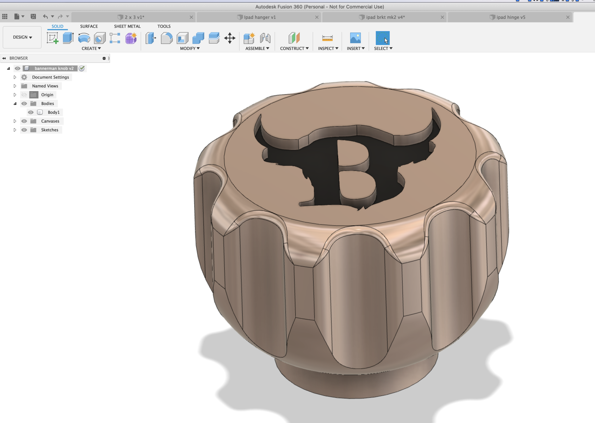

The first step was to design the knob in fusion 360 where i used a canvas to trace around to get their logo which i extruded into the top of the knob

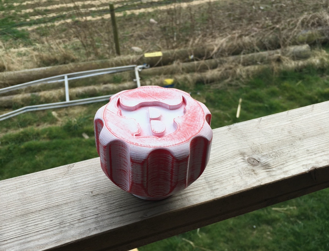

then 3D print it on my prusa 3D printer
Which resulted in a pattern which i painted and then sanded it down a bit to get rid of the layer lines

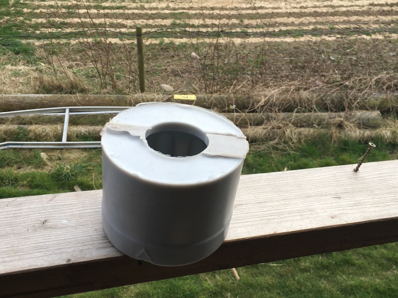

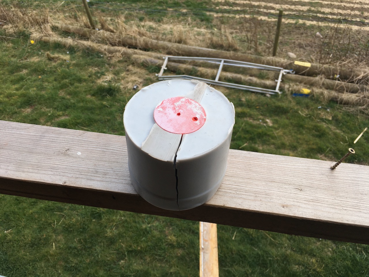

Then i used some silicone i made a mould which was left overnight after pouring and debubbling in a vacuum chamber
https://www.easycomposites.co.uk/#!...on-cure-mould-making-silicone-rubber-rtv.html

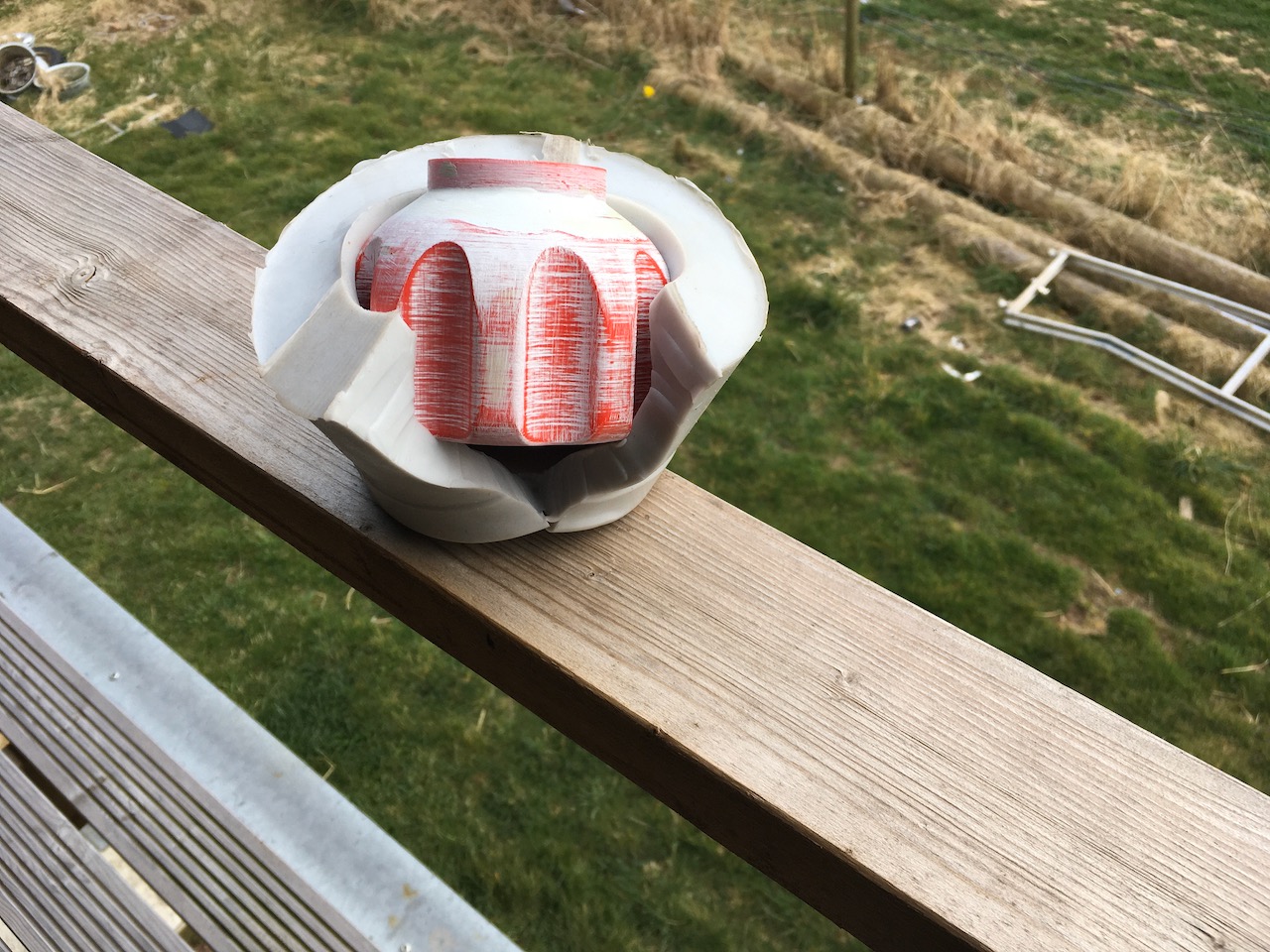

The mould was then sliced open to remove the 3D printed pattern
Then i got some casting resin (about 400G) and some copper powder
https://www.easycomposites.co.uk/#!...sin/toughened-polyurethane-casting-resin.html
https://www.easycomposites.co.uk/#!...metal-powders/copper-metal-filler-powder.html
Poured this into the mould after i put it back together with large amounts of duck tape and let it set

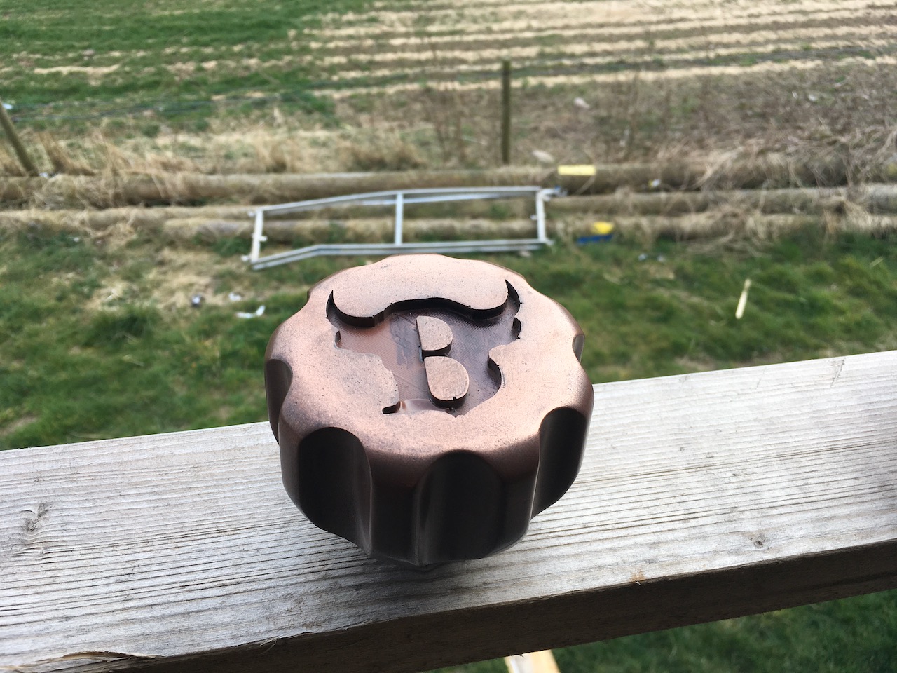

Then pulled out the resulting cast
Then after LOTS of sanding and polishing i got this which on the top it looks like it is solid copper. Also i is quite heavy but not as heavy as solid metal.
The logo is going to be filled in with some black resin to make the logo stand out hence the experiment with a black marker.
If i was todo it again i would use alot more copper powder and i would also degas the resin as there was a few too many bubble inclusions for my liking
Overall it is a technique i would do again to make large knobs, don't know how well it would work for making handwheels with spokes
All the parts sitting on a 2x4 for scale (no bananas were at hand)
And the process is called cold casting metal
