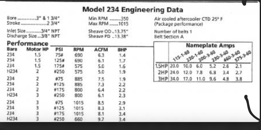

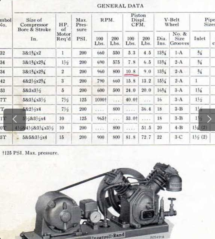

My Type 30 has a 2hp motor, & the twin-cyl Type 234 pump. From tables someone kindly put up (below), then (best I can make out) at 100psi this Compressor is perhaps 10cfm??
