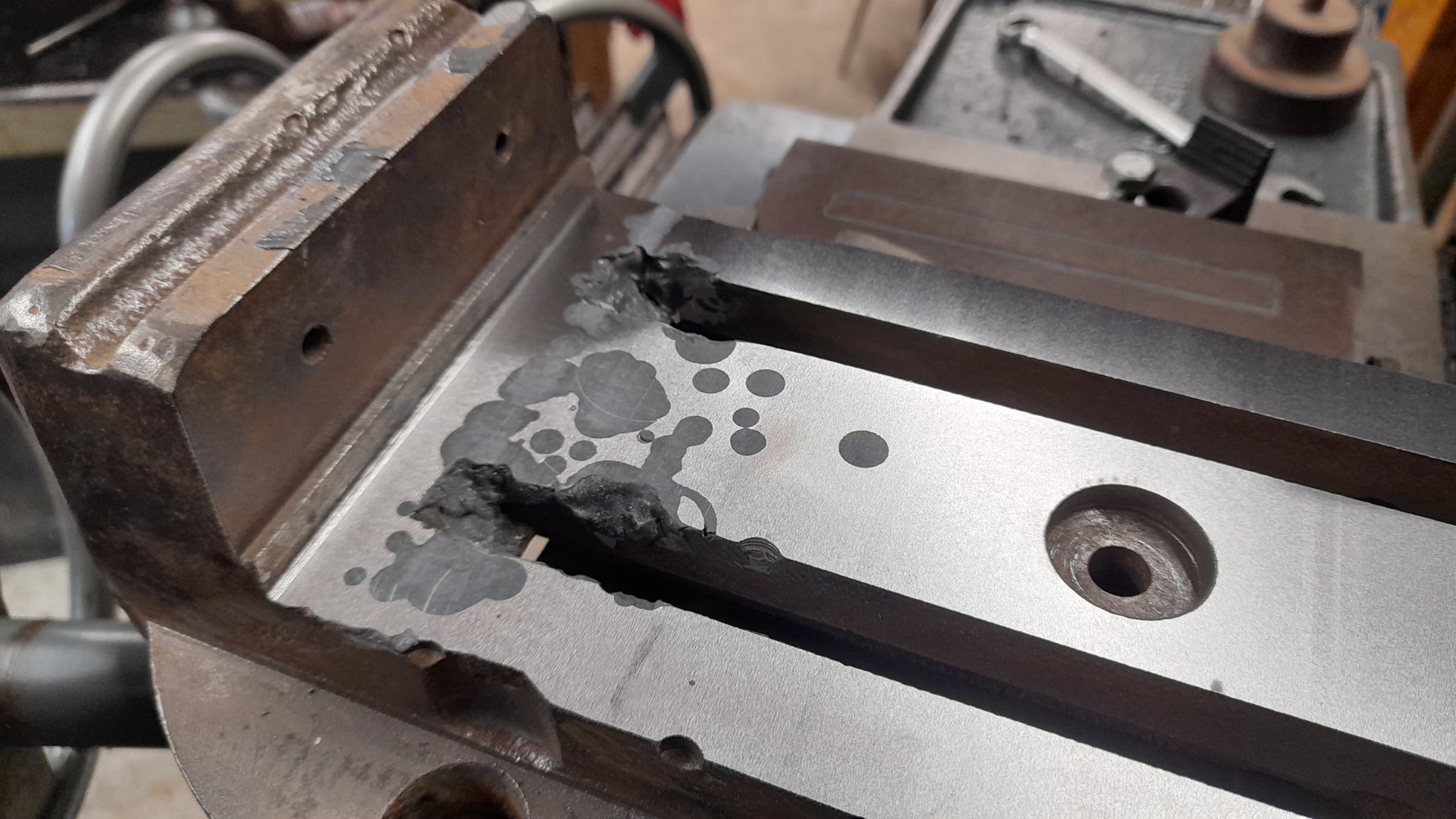

Ideally, I would like it to hold work more accurately than it does at present.
Would you like to swap?
I'm quite happy to machine the vice at home as I have a mill and surface grinder. I don't have MIG (but I could possibly do it at work, with practise) only a stick welder and I'm not sure how well that would go. I've used jbweld on many other jobs and know the outcome would be satisfactory.I can see the attraction in spending time and effort restoring an old vice. It's a sort of hobby of mine too.
But how much will it cost to repair and what what functionality will be added would be my first thought. I compare that to how much it might cost to replace said item with a better example.
There is no great value in that vice with decent to minty examples easily available for circa £40 to £60.

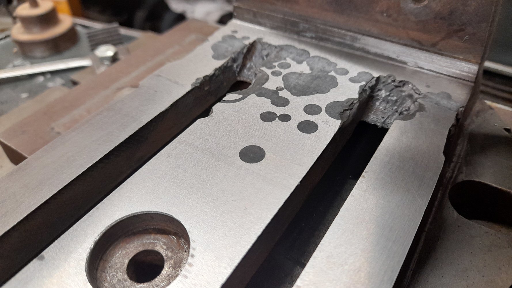

The holes make little difference to the function so it's a cosmetic repair. Get into the realms of welding or brazing and it will require machining since you will distort the "precision" surfaces. Bung up the holes with JB Weld and it will pretty much look the same with some small benefit in resisting the collection of swarf. It will need new or reground jaws either way.

I would enjoy seeing a detailed repair thread on this vice. MIG it, machine it, bring it back up to snuff. There is merit in that process and it is something I enjoy doing but frankly, the end result is never going to be more than a fairly underwhelming, run of the mill, throwaway vice.

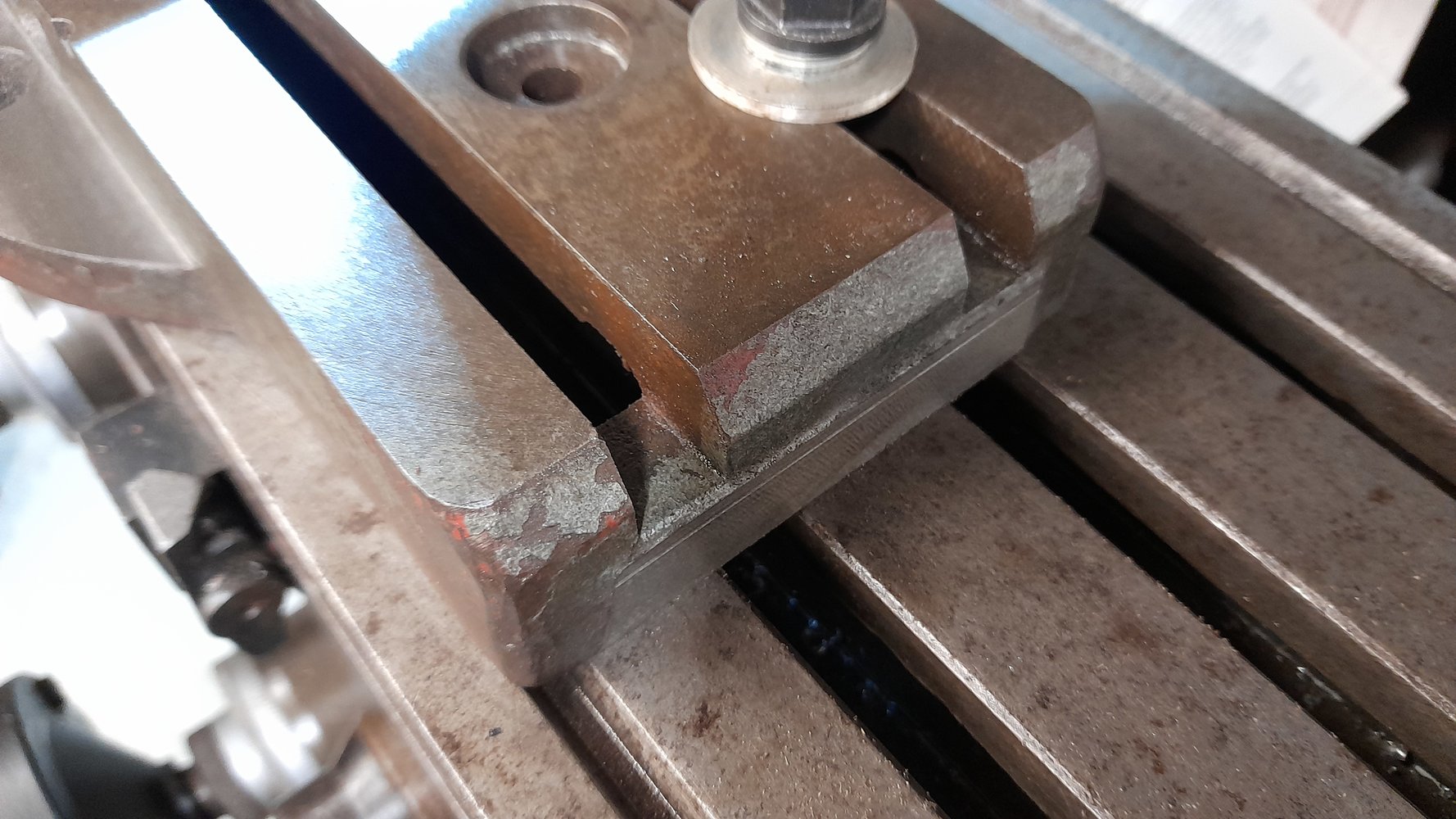

I bought it because it was cheap (£3 if I remember correctly, £5 if I don't).It’s an Abwood, so a good quality machine vise. Shame it has been abused. Mine has some damage but nowhere near like that - or I would not have bought it! Mine has, IIRC, a swivel base - but that never gets used, if I do.
There should be a square shaft for a handle with a octagonal drive.
I would get it built up, and machine it back to original, if restoring it. Possibly with braze but perhaps with a metal reinforced filler, even JB Weld.
Machined in situ would provide a level base for use with or without parallels.
Check with a dti for vertical run-out and get the rear jaw stoned flat (if original and hardened). The movable jaw would then be machined to be square with the rear, or as close as possible - it is the rear that is always used as a datum.

The pic appears to show a decent surface for a parallel to sit on, so is possibly OK as it is - and still be better than a cheap chinese offering.
I've never used it on a vice before, but have used it on drill press tables with good effect. I'm only using it as a filler and it seems to do that job well.I bought some JB Weld for the first time a few weeks ago to fix my 80 year-old neighbour's leaky iron gutter (seems to have done the trick).
Is it really that good as a metal "filler"? I'd never have thought to use it on something like a vice but if it can fix problems like that...
