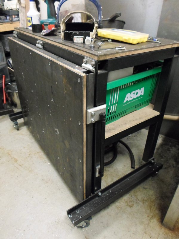

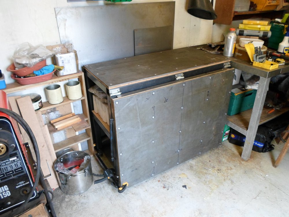

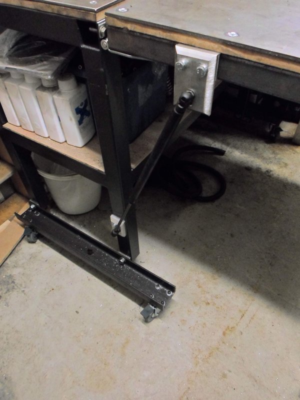

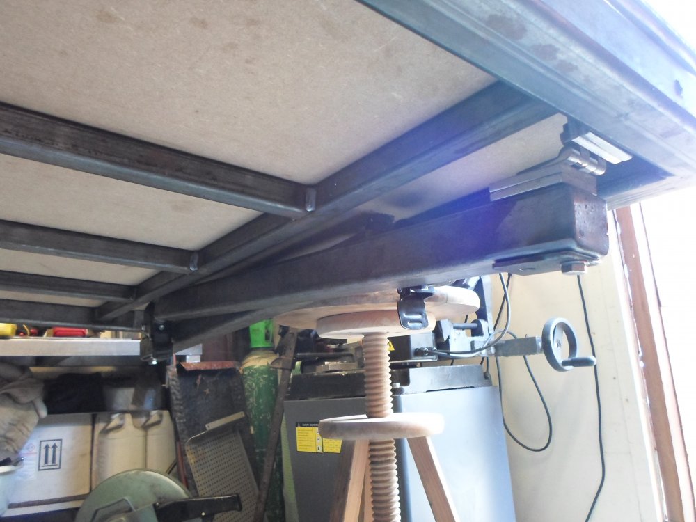

This thread is just a continuation of my bench build.
A few more minor adjustments to make:
-Upgrade to larger castors
-Widen the wheelbase slightly for extra stability when raising the leaf
-some catches to stop the struts from lifting the leaf when in its lowered position (held closed by sash clamp at the moment)

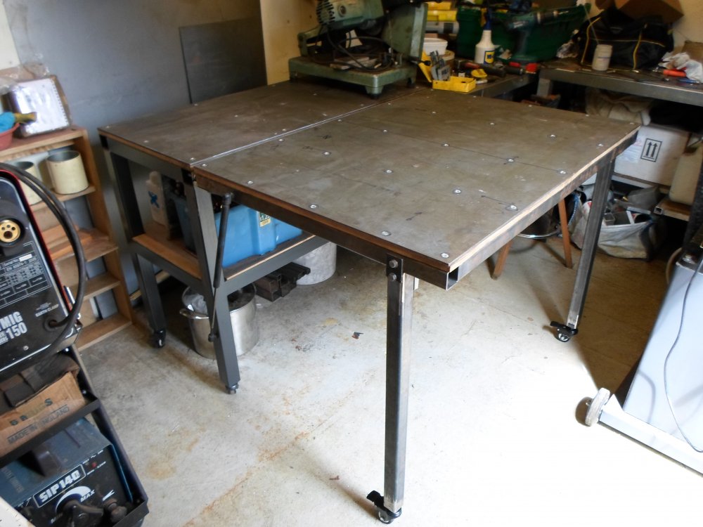

6mm plate on top of 12mm MDF. Its surprisingly almost dead flat. need to be sure I dont put too much heat into it.
Udjustable castors for leveling.
Hinge gap is wide enought to allow cutting of sheet with a circular saw.
Legs fold away, held in position by magnets.

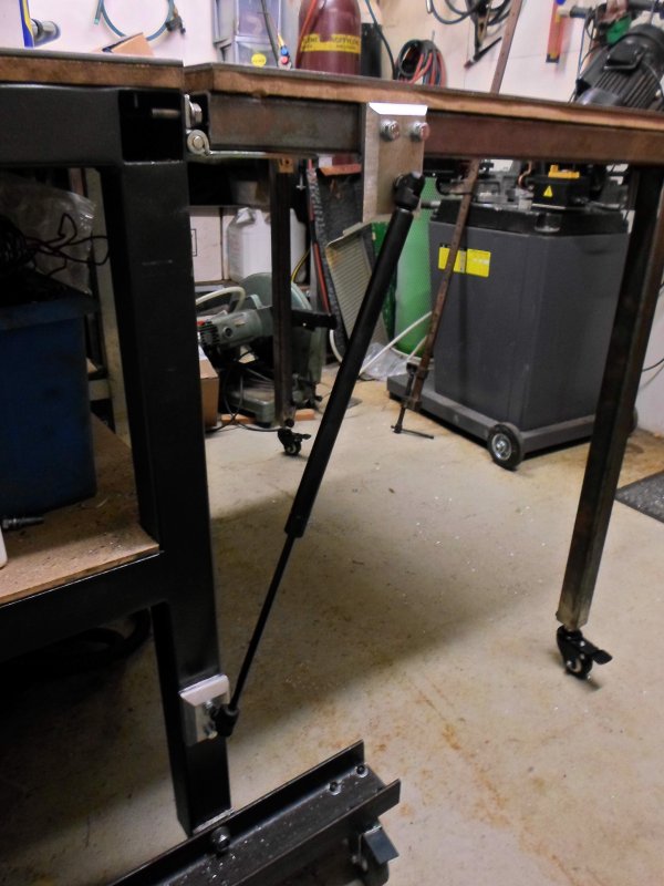

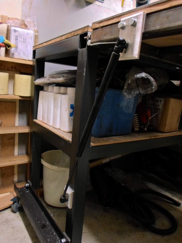

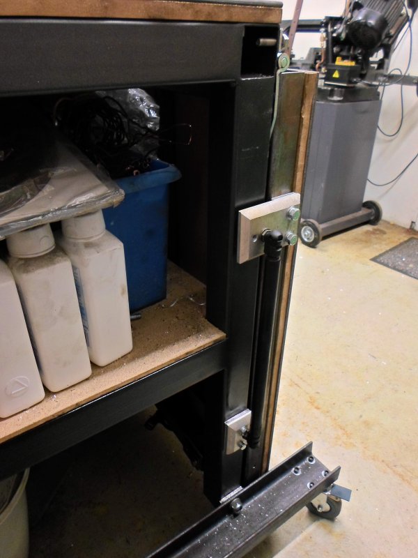

Struts I pinched from my old Astra boot lid allow lifting and lowering the leaf with ease.
