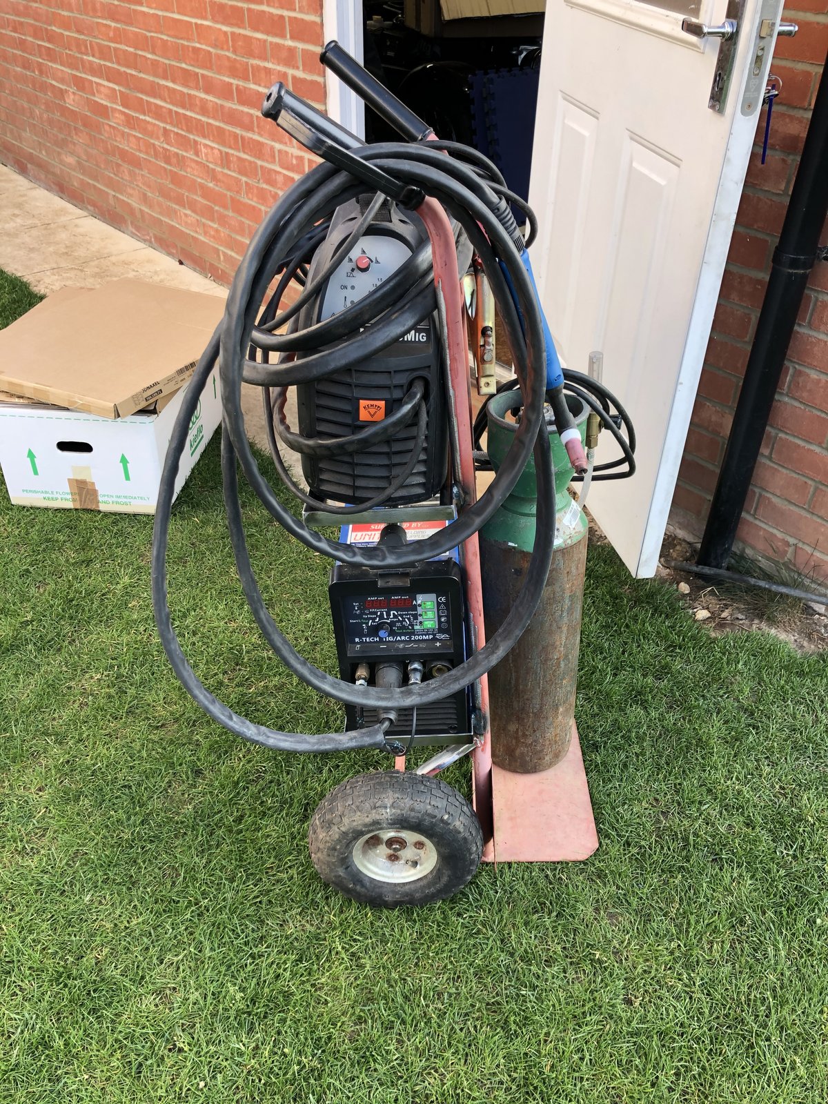

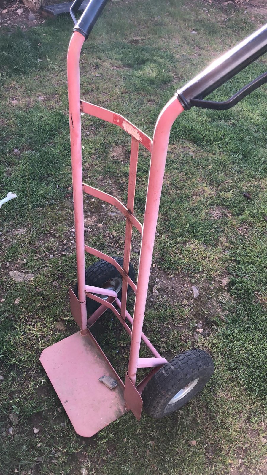

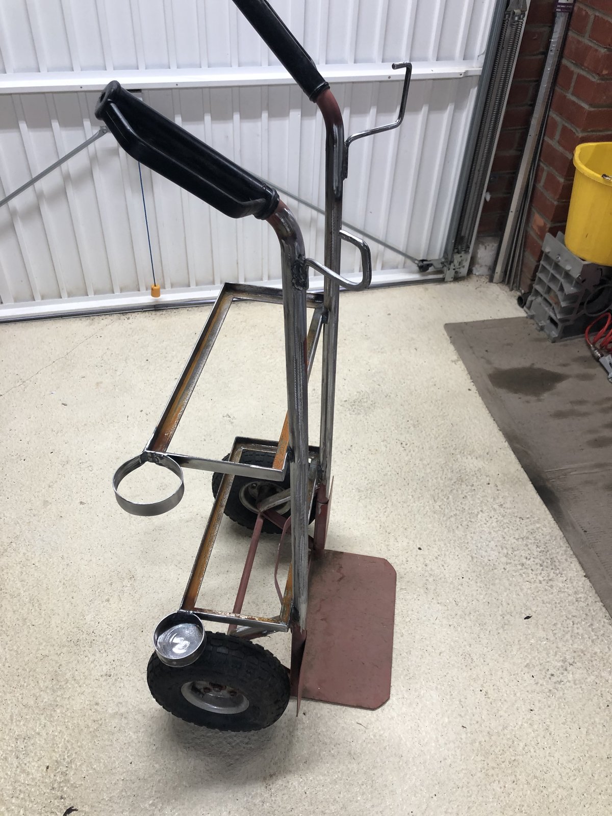

I first saw this type of inverter cart built by 2 NZ guys that came to do an install of some equipment we had made for them.
They bought an inverter with them and just knocked up a simple mobile cart from a cheap sack barrow, this allowed them to quickly move around on site with everything they needed in one place.
Cue one sack barrow purchased ages ago to do the same thing.

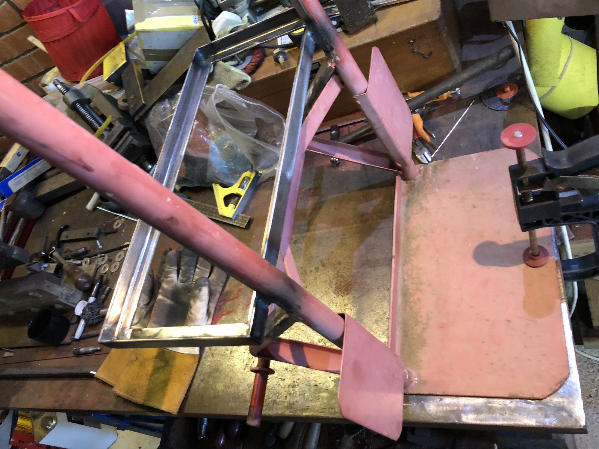

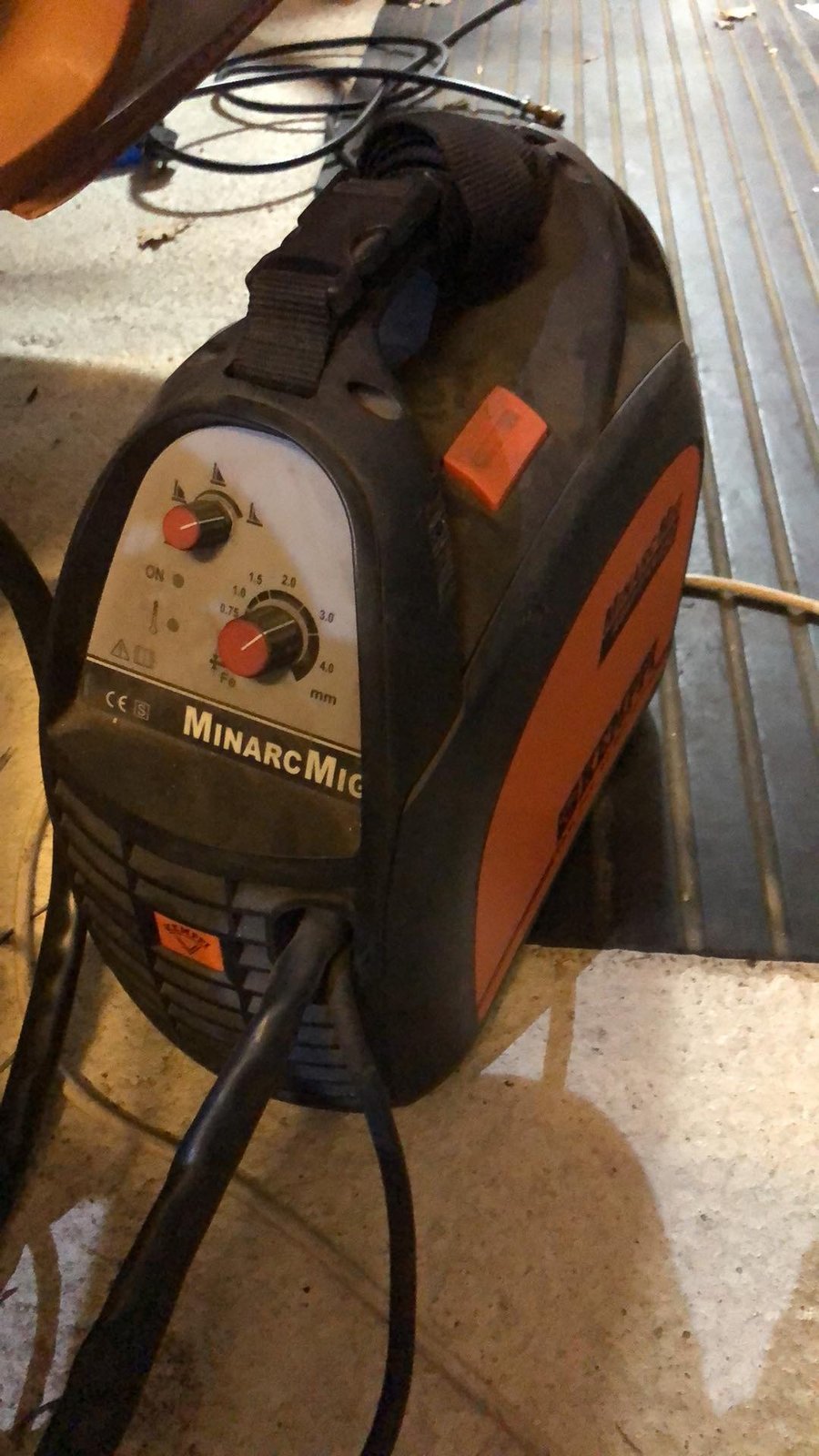

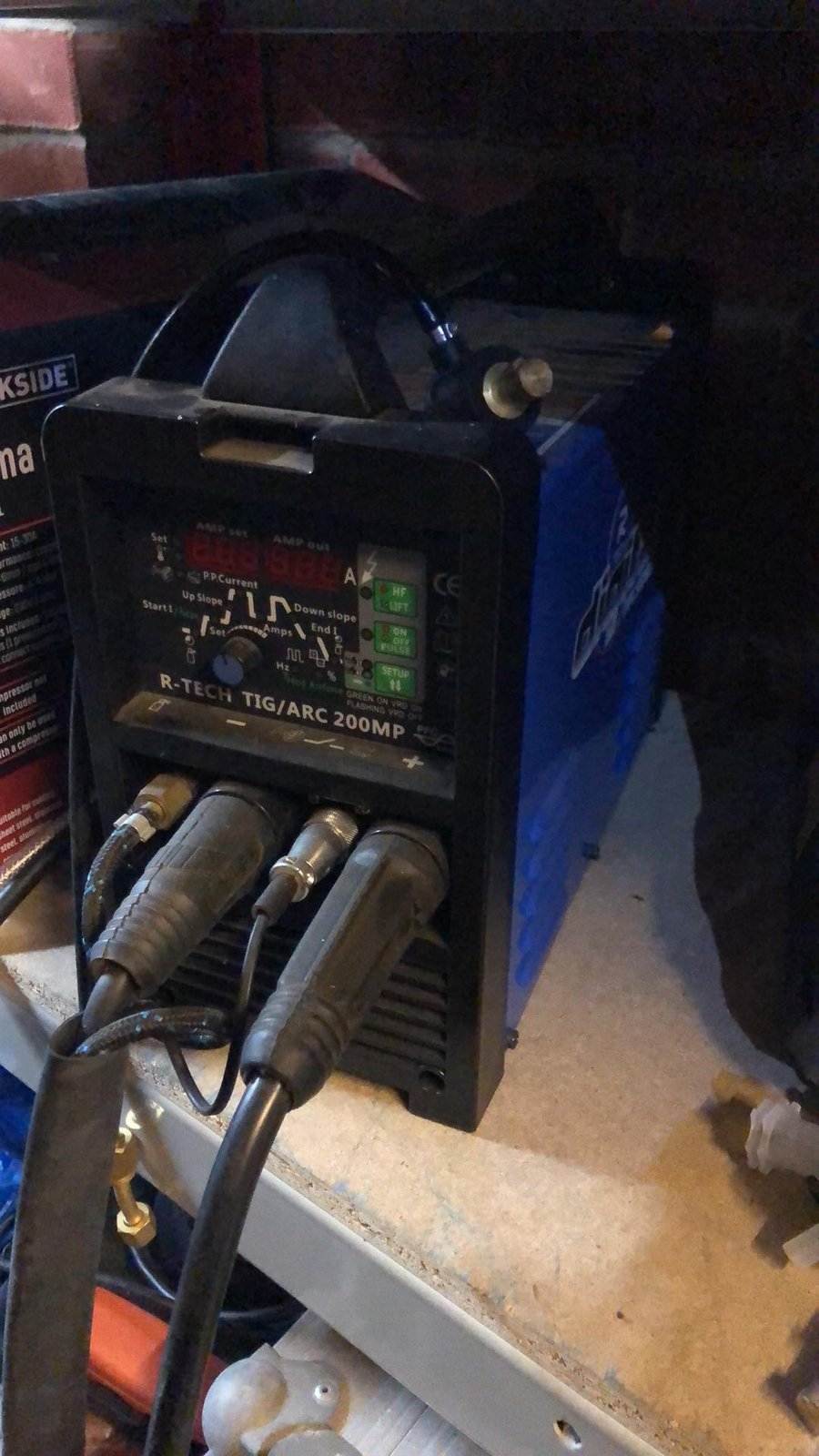

The 2 inverter welders I wanted to mount:

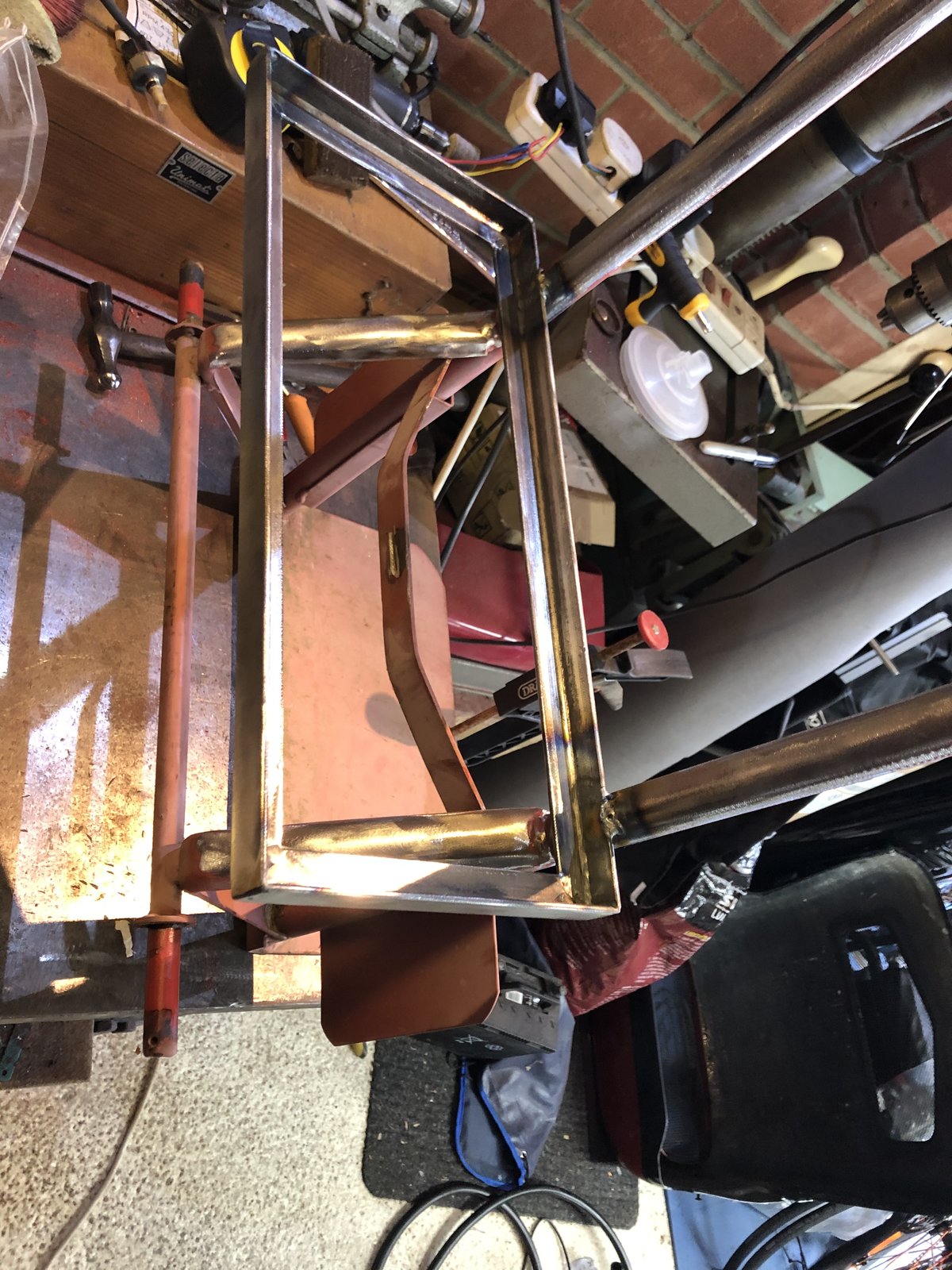

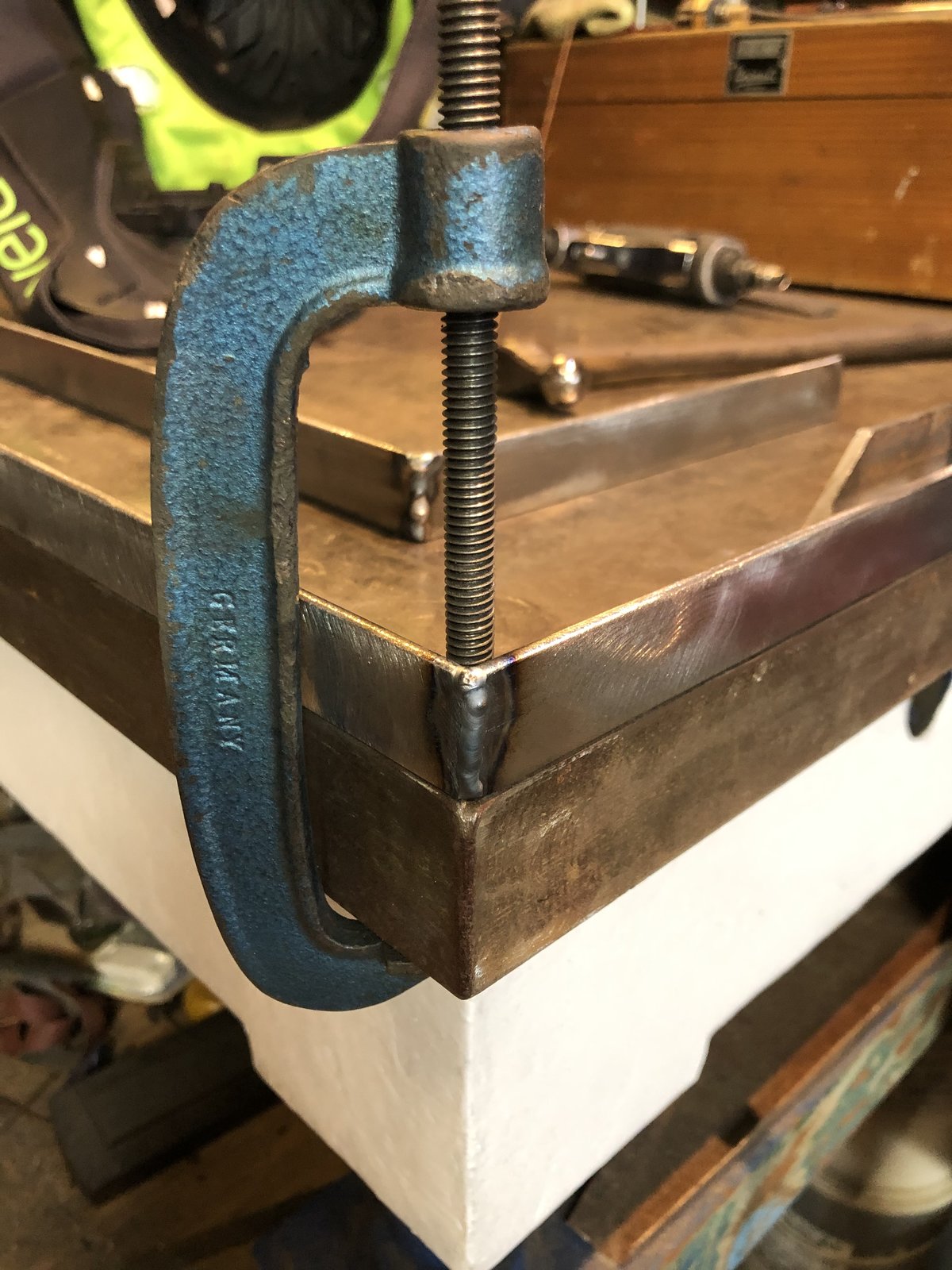

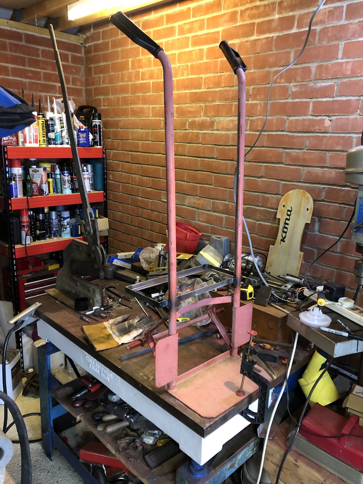

so some 20mm angle later

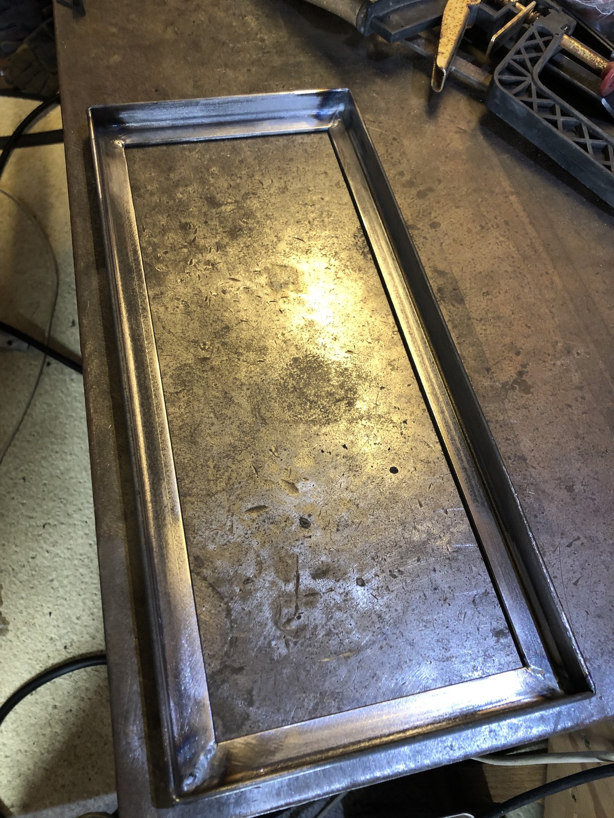

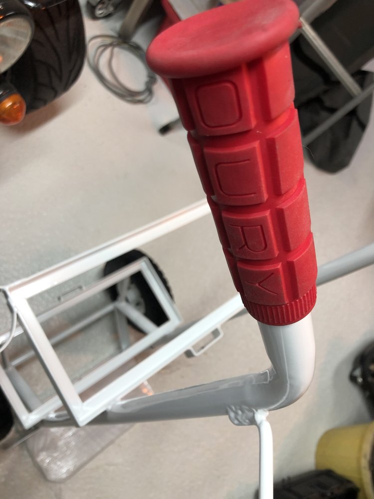

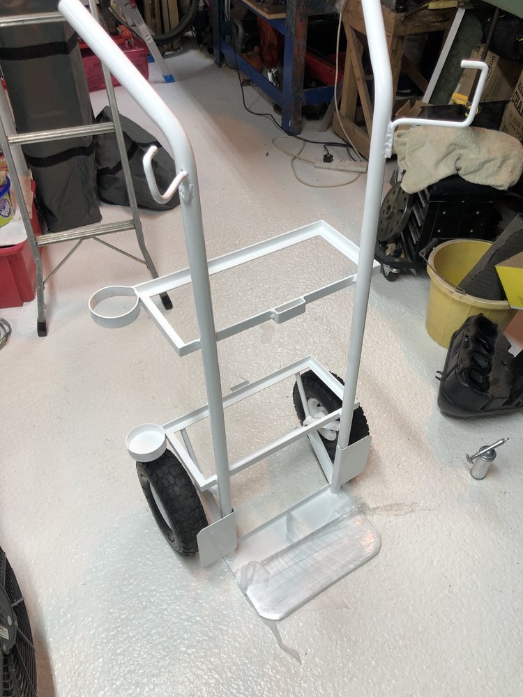

A couple of simple frames TIG'd together
I decided to use the TIG for all of this as I really need the practice, mig would have been so much easier but I wanted to get the torch time

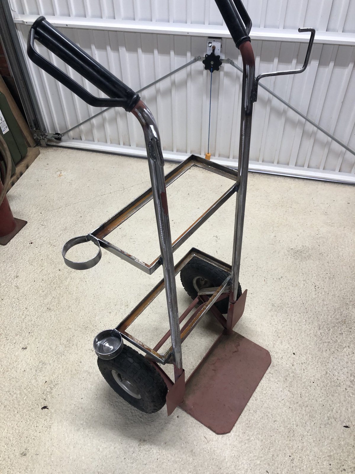

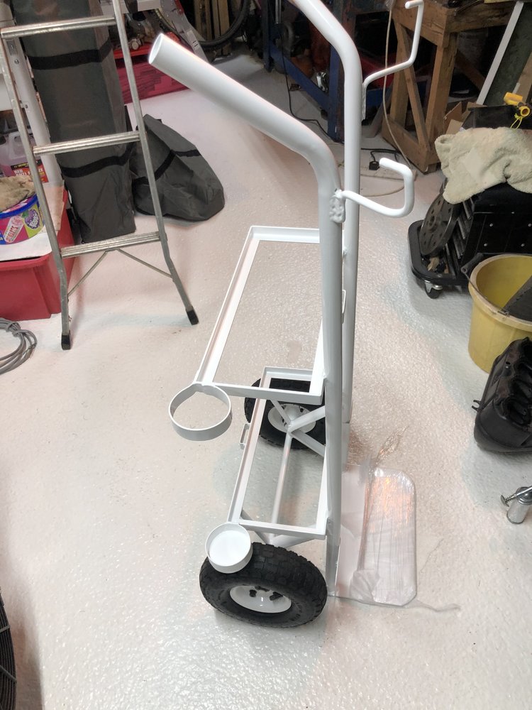

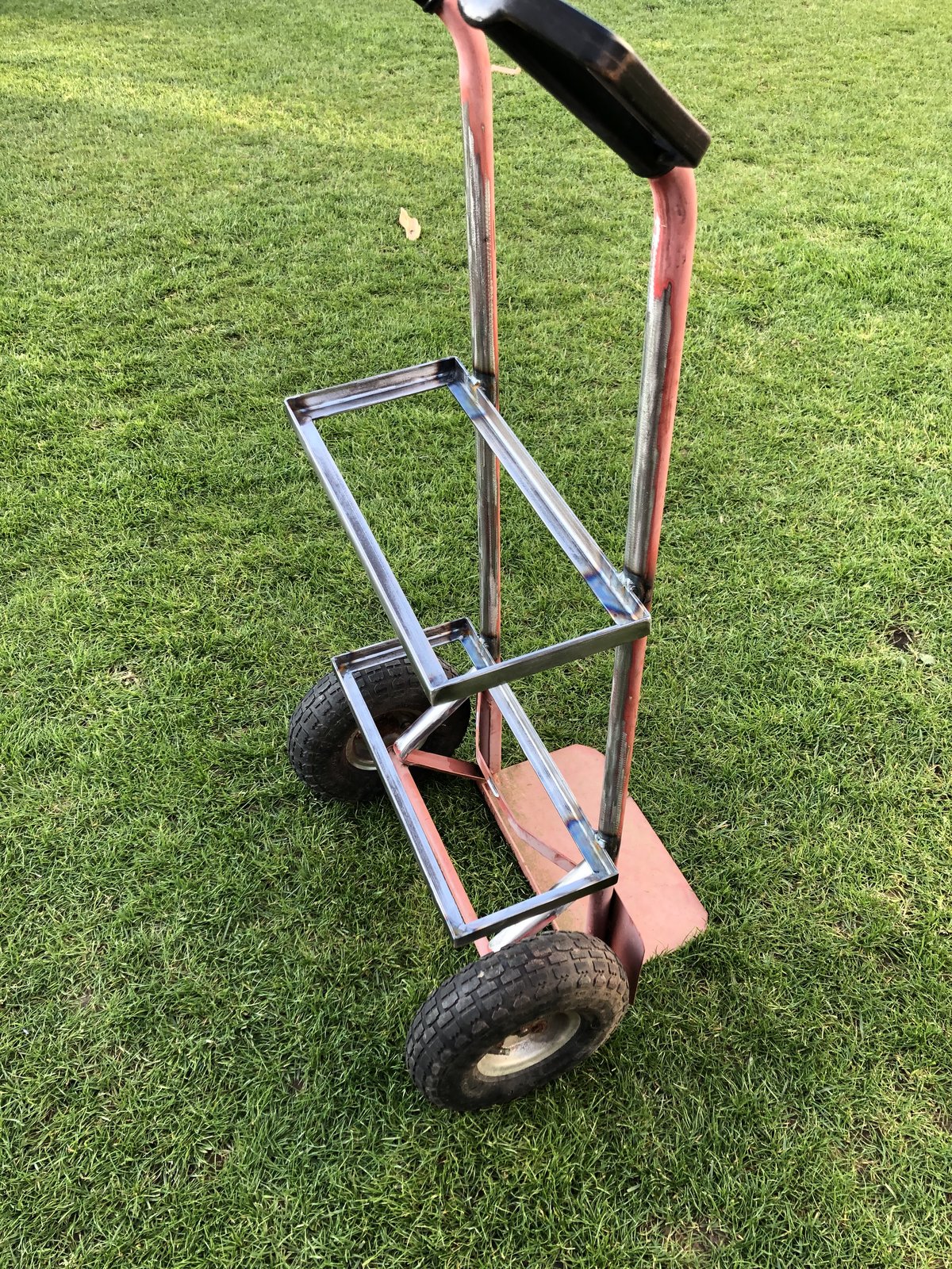

so sack barrow frame cleaned back and shelves added

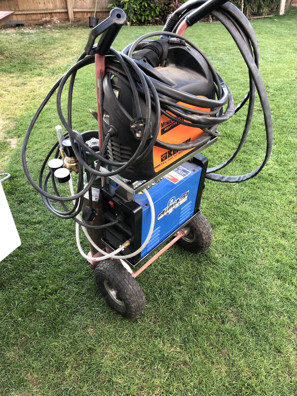

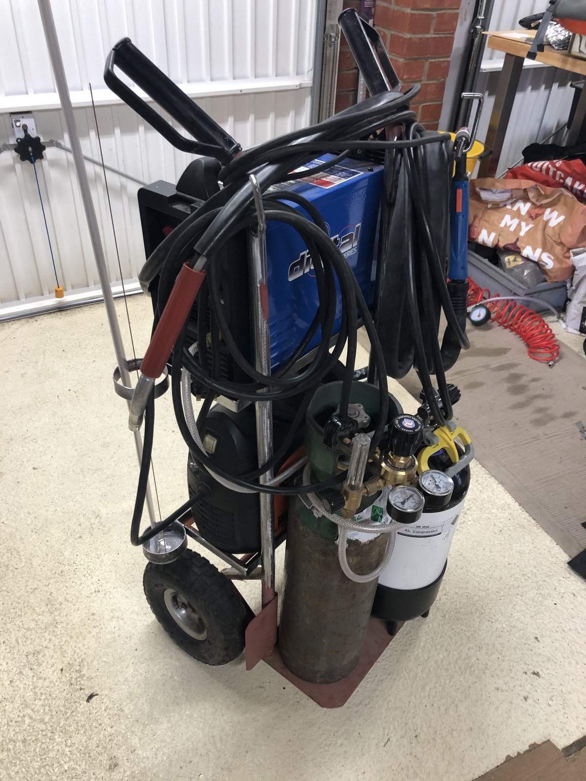

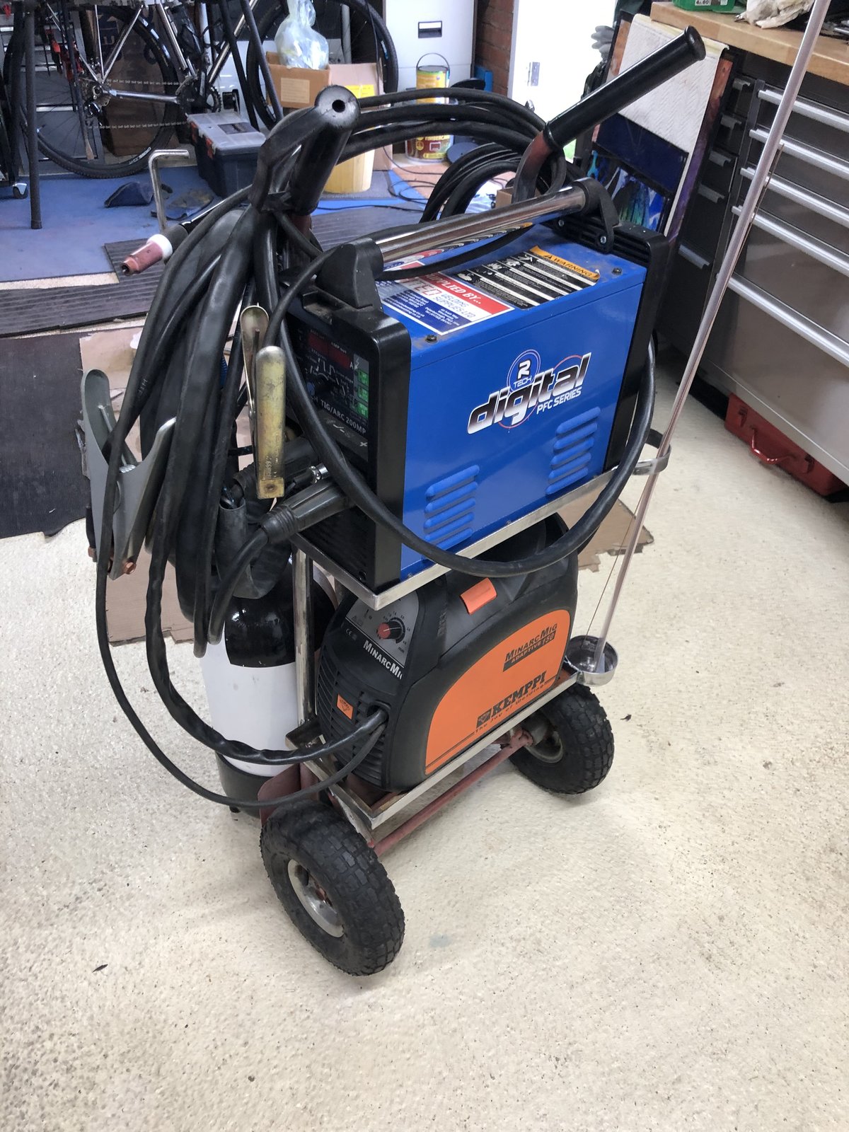

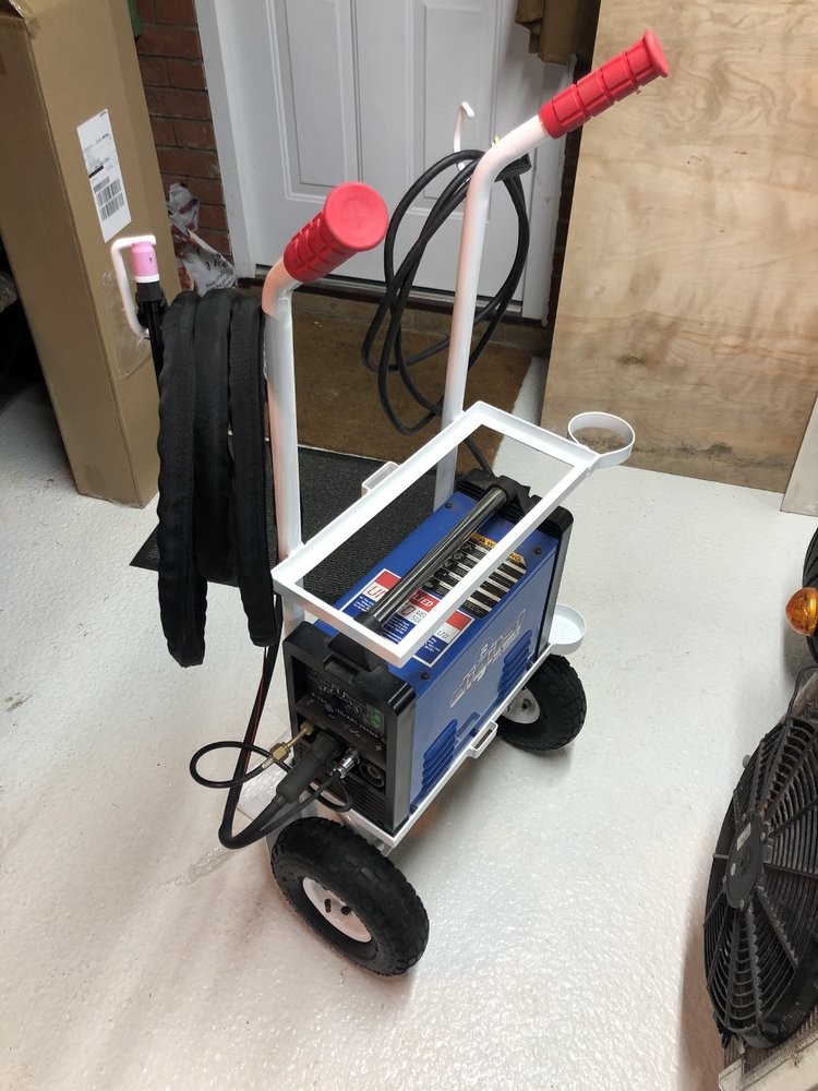

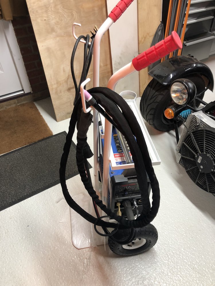

And welders added to check it out
