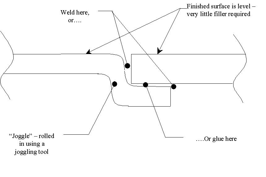

so my mate dropped his caddy off so i could play with my weld . 5 minute job he said lol
got new panels
ended up like this, im happy with it and he is very happy
I have maestro panels to weld and have been messing about with scrap to get the settings right. Did you join the welds up or was that picture the finished welds?
Cheers
no not like that, weld tabs on by drilling hole in old metel then spot weld the drill holes up so tabs are solid, then new wheel arch weld to new tabs hope that all makes sense lol
