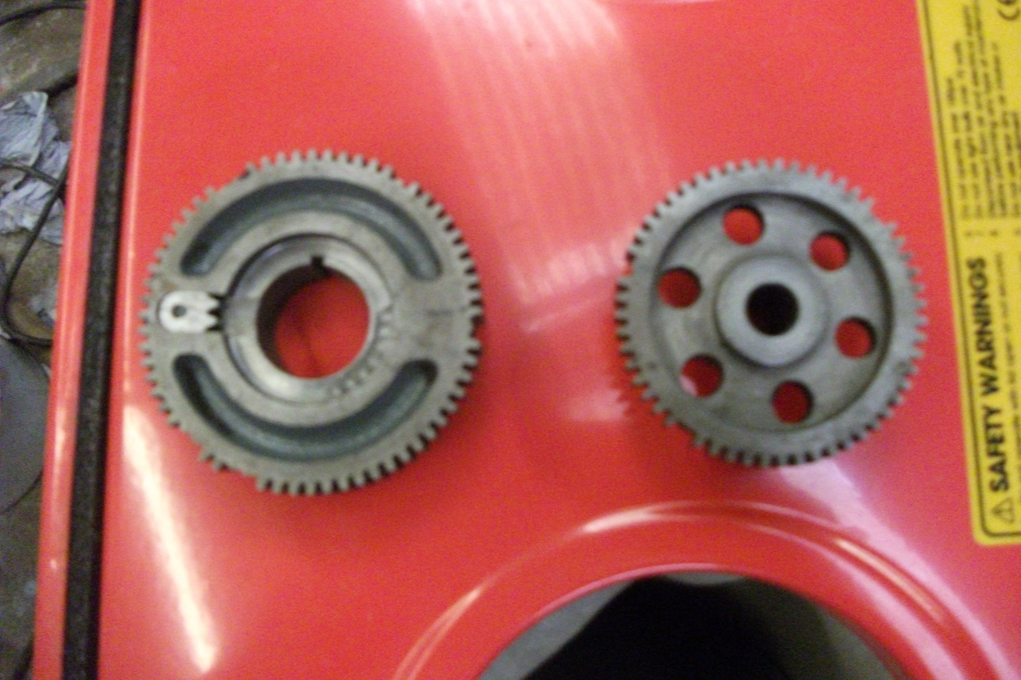

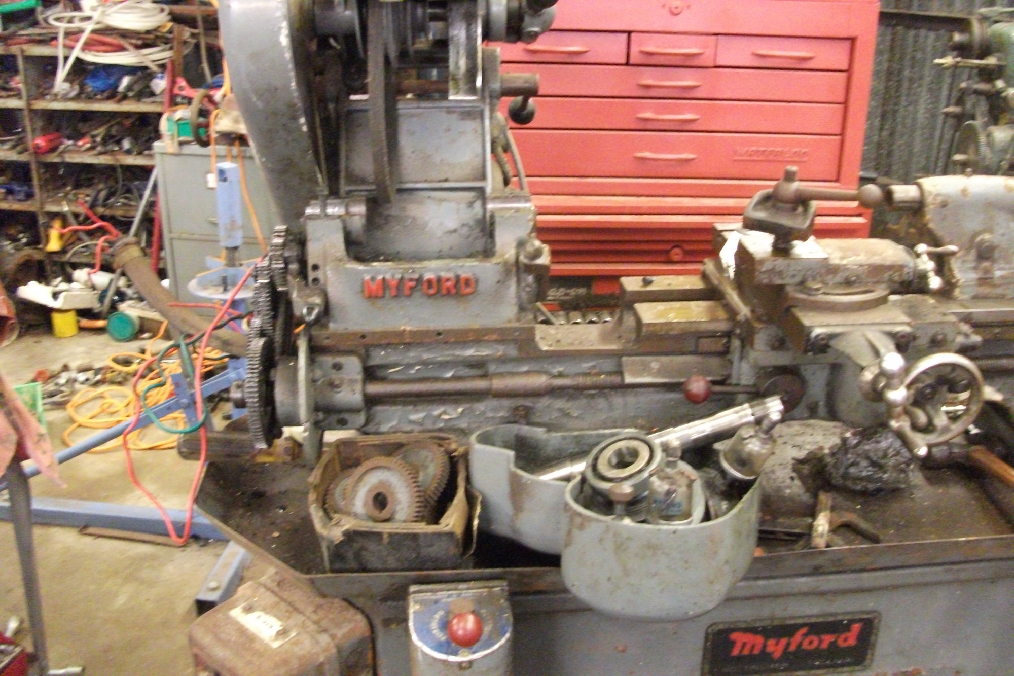

picked one up last year that hasn't been tret well .mucky a bit rusty but half decent . some pillock must have had it in backgear to get the chuck off and bust the backgear teeth off and the one on the main shaft

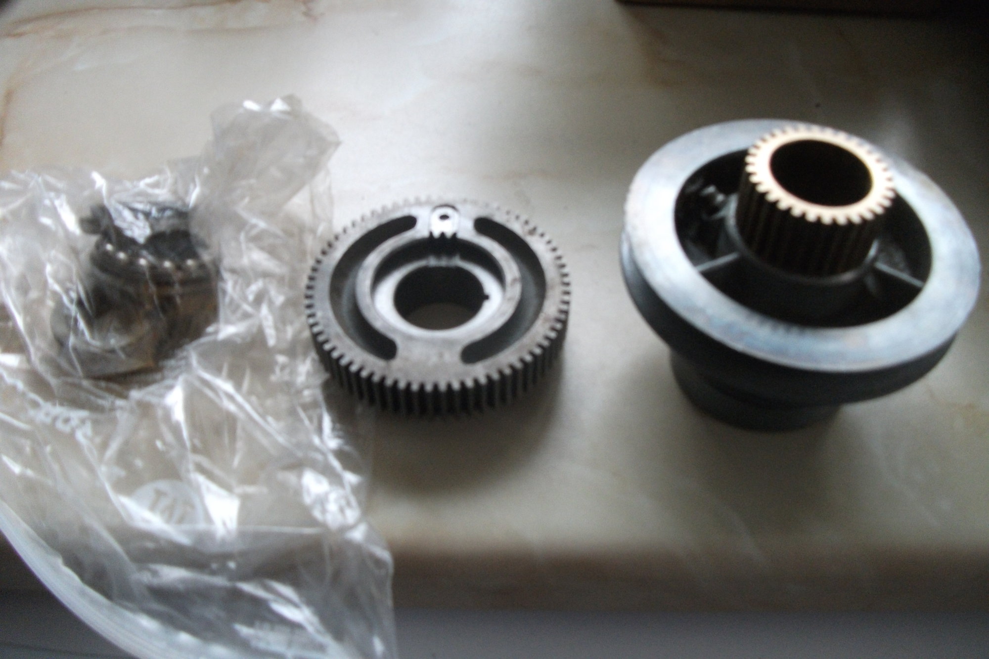

just took the mainshaft out and disassembled it to remove the broken gears . I got the top one and pulley of ebay 45 quid in good nick
the bottom one I can repair or buy a new one for 52 quid or wait for a second hand one cheaper if one turns up .other than new belts and a re paint its good to go . it has a clutch fitted so I'm going to swap it on to my other lathe that's in good nick that's not fitted with one
