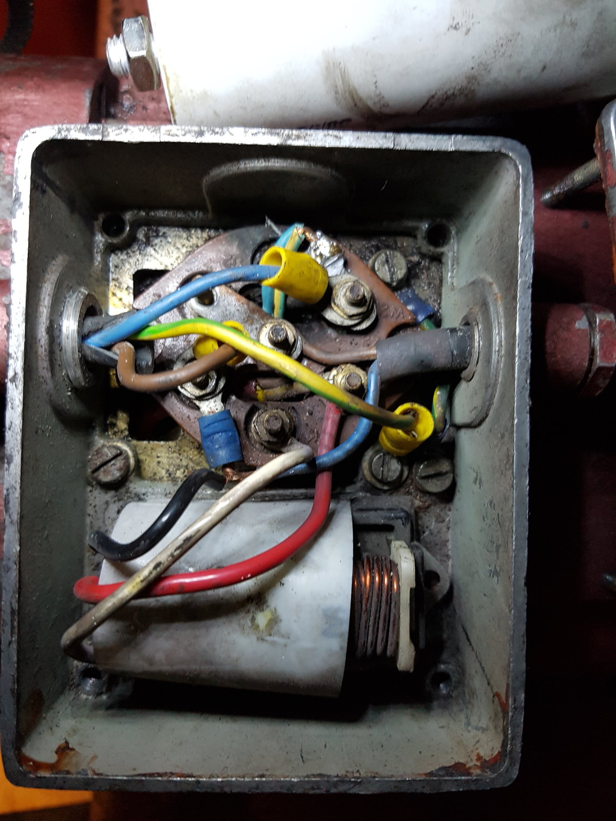

OK, I bought it spares-or-repair for not a lot, expected a few problems and someone had Been In There before me...
New start cap (150 uF, under a fiver), checked everything's free, it sat and grumbled rather than starting, blew the fuse.
(It's a cap-start, induction-run motor, so no run cap.)

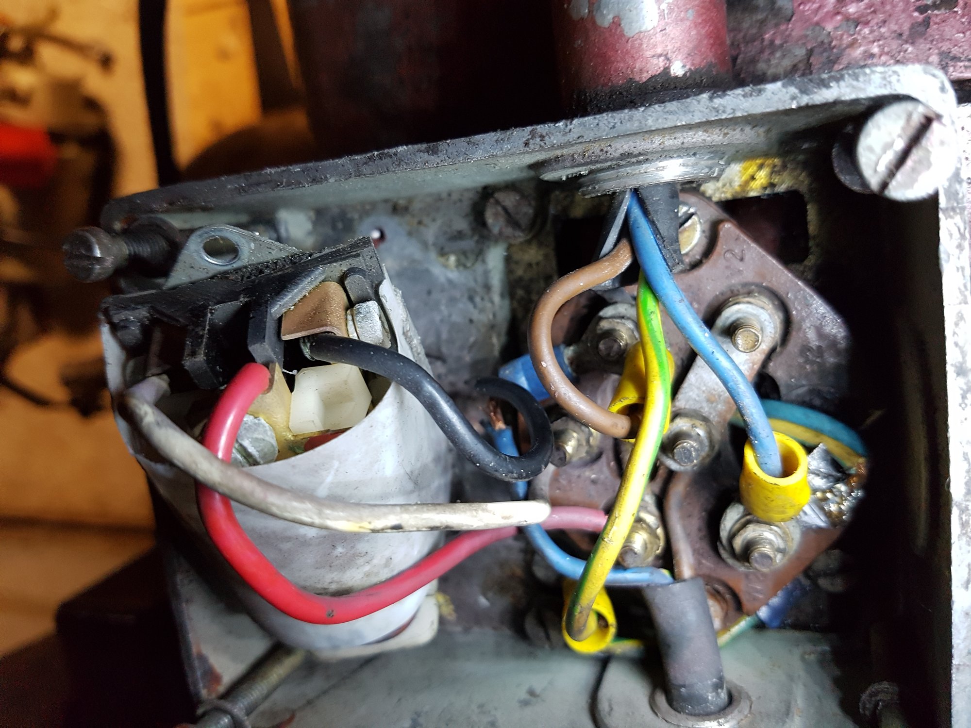

It has a (manky-looking open-frame) current start relay (coil in series with the feed to the run winding, closes and connects the start cap when the run winding pulls high current on start-up, opens when the current drops once up to speed - or at least it should), which doesn't work despite having continuity through the coil, good contact continuity when wedged closed - wedging it closed when applying power gives a good solid spin-up, no blown fuses, but I'm damned if I'm going to poke a screwdriver in every time it cycles!
The manky relay below the somewhat charred terminal block (already replaced) BEFORE wiring it correctly...

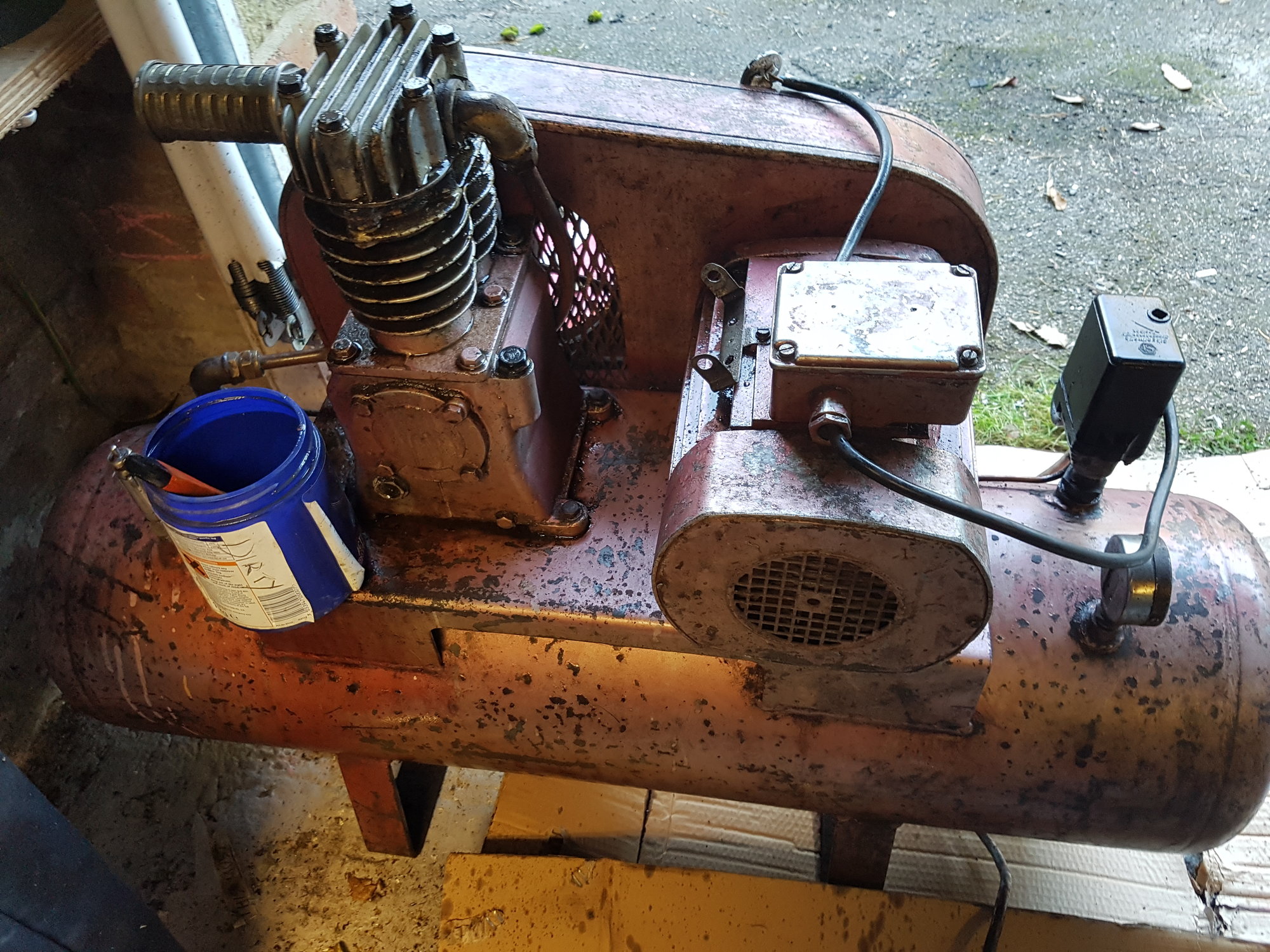

So... can anyone identify the compressor and point me at a parts supplier, or suggest a source for a *current* start relay for what I guess is a 2 - 3 HP 240v motor? If I can't find one I'll play Instrument Maker and try to dismantle and sort the old one, but it's pressed/staked together and may not survive the operation, doctor.
